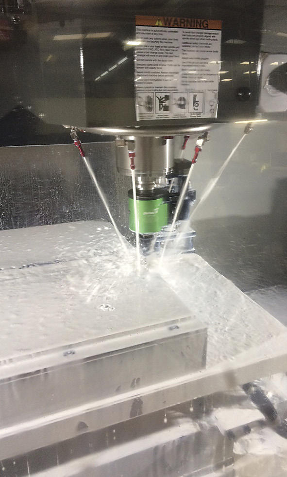

Tapmatic says its RCT50 self-reversing tapping attachment allows for faster cycle times and less wear on both tap and spindle. Image courtesy of Tapmatic.

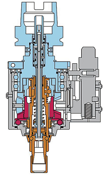

The Tapmatic ASR and RSR self-reversing tapping attachments’ more
compact design is suited for modern CNC lathes. Image courtesy of Tapmatic.

Tapping heads feature an internal gearbox and are self-reversing. They allow a machine spindle to continuously rotate in one direction. The tapping attachment rotates and feeds the tap into the hole. Once the desired thread depth is reached, the attachment’s gearing reverses direction and the tap is retracted from the hole without the machine spindle stopping or reversing direction.

Tapmatic Corp., Post Falls, Idaho, has manufactured tapping attachments for the metalworking industry since it opened shop in 1952, said the company’s president, Mark Johnson. Tapmatic specializes in self-reversing attachments for conventional milling machines, CNC machining centers and CNC lathes with driven tooling.
“The biggest advantage to a self-reversing tapping attachment is cycle time,” Johnson said. “For example, if you are tapping an M8 [-sized hole] at 2,500 rpm, a self-reversing attachment will save you 35 to 40 percent on cycle time, compared to tapping the same hole at the same speed by reversing the machine.”
Those numbers are not guesswork, either. Tapmatic has tested its method against the alternatives, and the productivity gains are impressive.
In one series of tests, the company rigid-tapped 80 M8 × 1.25 holes in 6061 aluminum on a CNC lathe running at 2,500 rpm; the results were that 33 holes per minute were tapped. Next, the company rigid-tapped 80 more holes, but at a speed of 4,000 rpm. Theoretically, significantly increasing the speed should significantly reduce cycle time. But at the higher speed, just 35 holes per minute were tapped—less than one-fifth of a second difference per hole vs. 2,500 rpm.
Tapmatic tapping attachments include a patented reversing ball drive, which allows
for an immediate changeover into reverse once the desired thread depth is reached. Image courtesy of Tapmatic.
“It’s difficult for the machine to accelerate and decelerate efficiently,” Johnson explained. “If you are tapping a hole and only going 12 or 13 threads deep, the machine has to go from full speed to zero in that short number of revolutions, then reaccelerate to come back out of the hole.”
In the final phase of the testing, a set of 80 holes were tapped using a new Tapmatic ASR50 self-reversing head running at 2,500 rpm. By running the spindle at a consistent speed and using the internal gearing to reverse the tap, Tapmatic was able to thread 52 holes per minute, cutting nearly three-quarters of a second per hole.
“Not only do you get tremendous time savings, but it’s easier on your tap, your machine tool and your electric bill,” Johnson said. “Stopping and restarting the spindle over and over uses nearly three times the electricity compared to running it at a consistent speed, so between that and putting less wear and tear on the tap and the machine spindle, a self-reversing tapping attachment brings some major advantages, provided you’re tapping enough same-sized holes to justify the setup time.”
