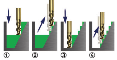

An OptiRough toolpath can cut material in two directions: step-down (-Z) and step-up (+Z). Large, aggressive down-cuts are followed by fast, smaller up-cuts. This efficient cutting strategy removes the maximum amount of material with the minimum number of step-downs, significantly reducing cycle times.

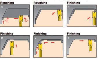

An Iscar CUTGRIP tool cuts with all three sides of the insert: the floor and the walls on both sides. This enables the cutting tool to combine roughing and finishing.

For example, Mastercam software provides OptiRough, a new technique for quickly removing large amounts of material using a dynamic milling motion. Dynamic milling constantly adjusts the toolpath to ensure the most efficient cut possible and allows the use of the entire tool-flute length, often minimizing the amount of multiple-depth cuts.
Instead, large, aggressive down-cuts are followed by fast, smaller up-cuts because the OptiRough toolpath recognizes the steps created from the previous down-cut and then removes the steps to more efficiently expose the part’s near-net shape.

Traditional methods require more tool travel because the user must program each step-down as a full width instead of simply removing the steps. Optirough optimizes cutter motion because it recognizes the remaining stock and removes material in two directions: step-down (-Z-axis) and step-up (+Z-axis). This bidirectional cutting strategy removes the maximum amount of material with the minimum number of full stock-width steps to achieve the same results, significantly reducing cycle times.

In addition to milling, new CAM-generated toolpath options are available for turning. For example, these toolpaths are helping users maximize turning and grooving cutting tools with CUTGRIP plunge-groove technology from Iscar Metals Inc., Arlington, Texas. (The grooving tools are specifically designed for groove turning on a lathe.)
