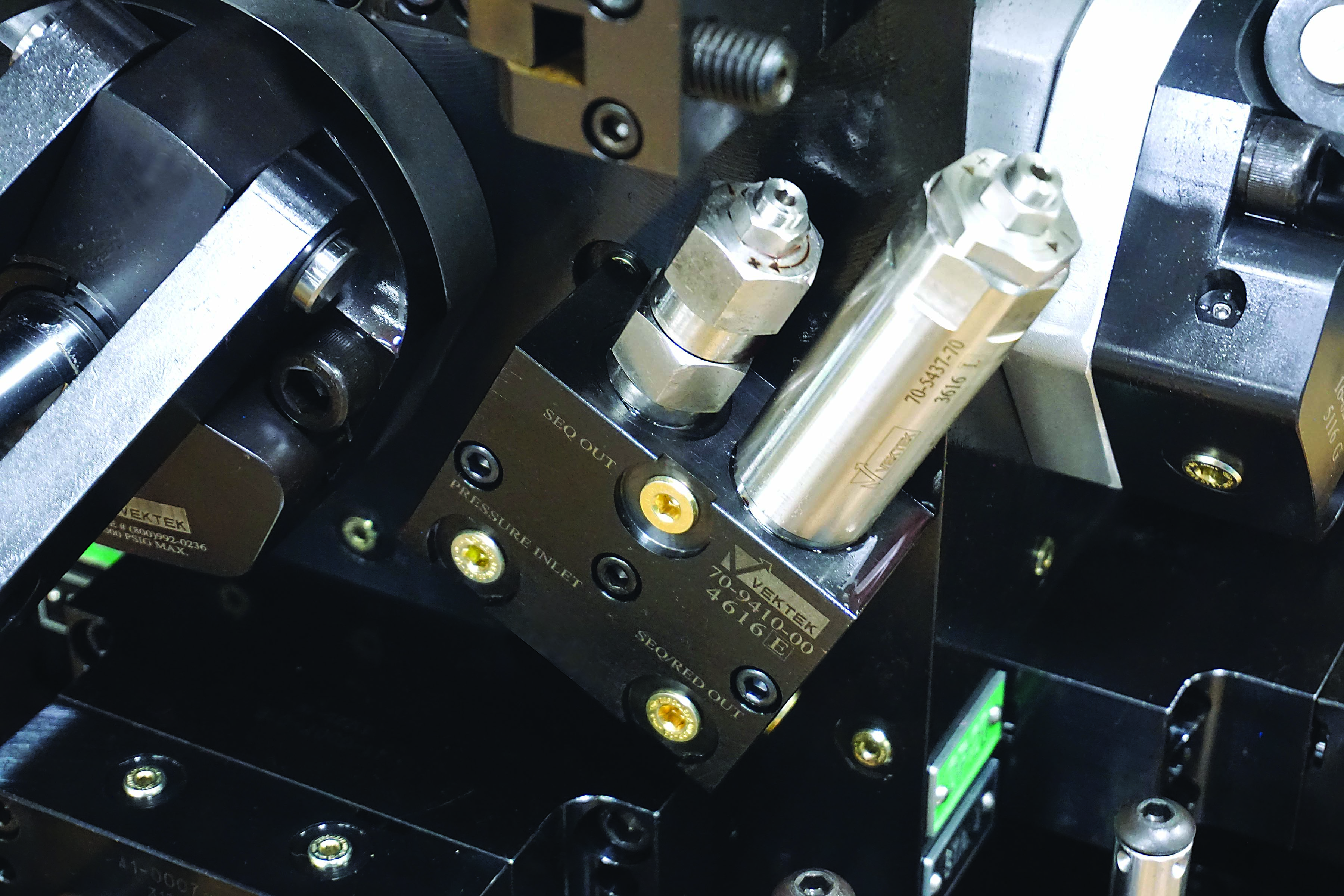

The Combination Sequence/PRV Block lets users control both timing and pressure on fixtures. Image courtesy of Vektek

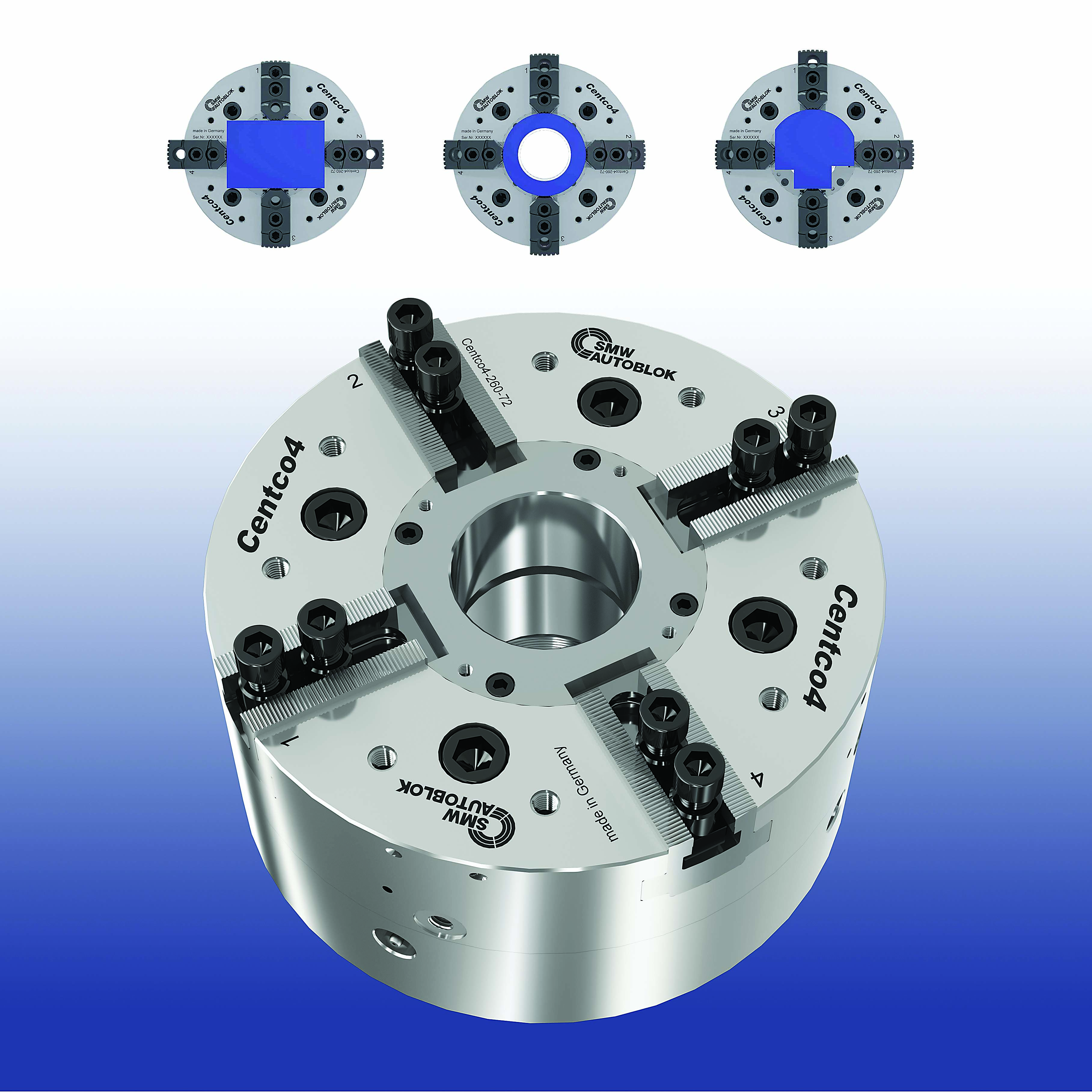

The Centco4 (2+2) self-centering and compensating chuck is designed to clamp any workpiece geometry. Image courtesy of Vektek
Shops making products that go inside the human body “want as little contamination to enter the manufacturing process as possible,” said Larry Robbins, president of the commercial division of SMW-Autoblok Corp., a workholding
manufacturer in Wheeling, Illinois.

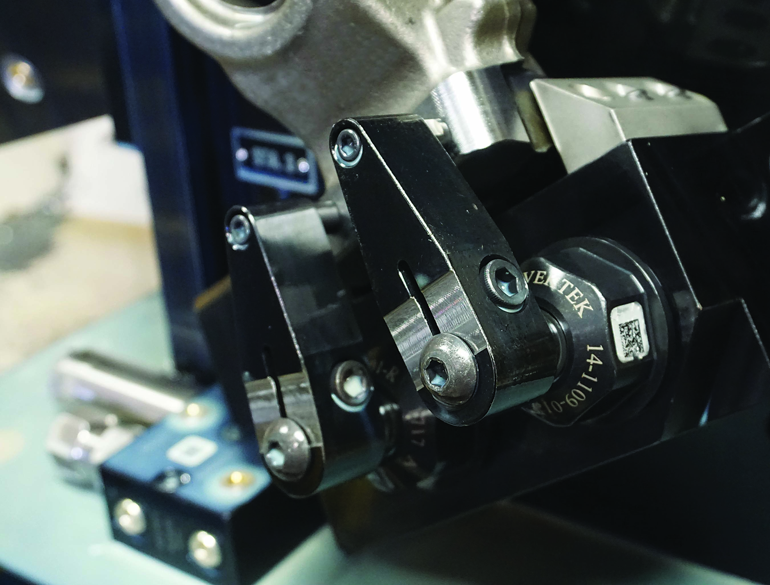

VersaCam swing clamps offer hardened V-cam tracks that resist damage and provide a built-in extra cam. Image courtesy of Vektek
