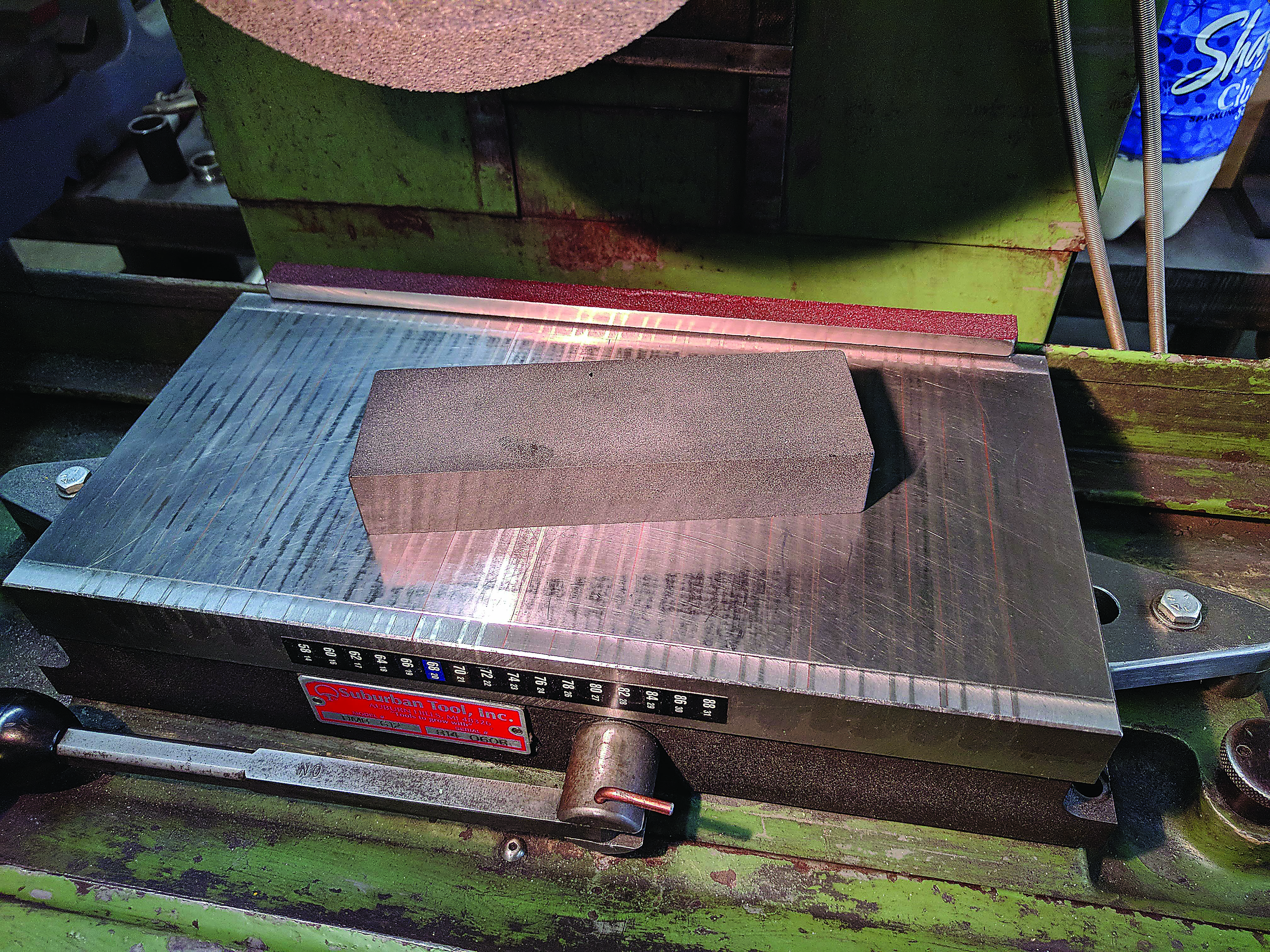

A common application for precision flat stones is stoning the part and the magnetic chuck of a surface grinder just prior to mounting the part (Figure 1). They are also used for removing small nicks and bruises from machine tool tables and accessories like parallels and vise jaws. In addition, flat stones can be carefully applied to detect and remove burrs and dings from male tapers, such as the ones on toolholders and spindles.
Figure 1. A common application for precision flat stones is stoning the magnetic chuck of a surface grinder just prior to mounting the part. Image courtesy of Tom Lipton.

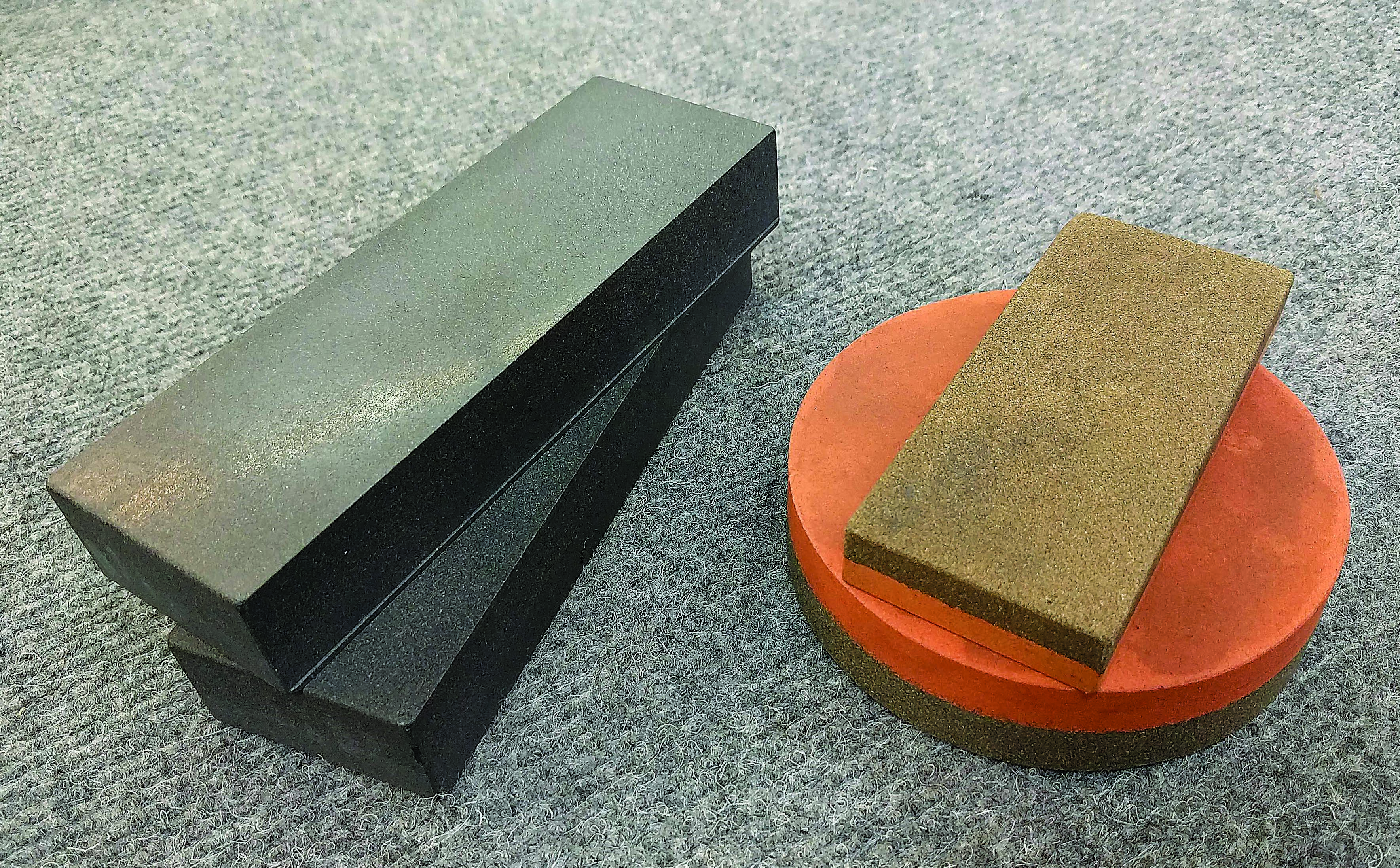

Always used in pairs, flat stones have one or more of their large surfaces precision-ground flat and parallel on a surface grinder with a diamond wheel (Figure 2). Typically, one or more of the long perpendicular sides are also ground so the stones can deburr up to a shoulder. Some stones have a small step that allows stoning all the way to an edge or grinding relief. These truly precision tools have more in common with gage block stones than they do with abrasive stones, except flat stones cut more aggressively than gage block stones.
Common shop-grade aluminum-oxide stones are not particularly flat. I measured some new stones out of curiosity, and the typical flatness was 0.004″ (0.10mm) to 0.006″ (0.15mm). Flat stones are ground or lapped flat to less than 0.0001″ (0.0025mm). This makes them suitable for use on highly accurate flat work. A more accurate description might be flat lapping stone.

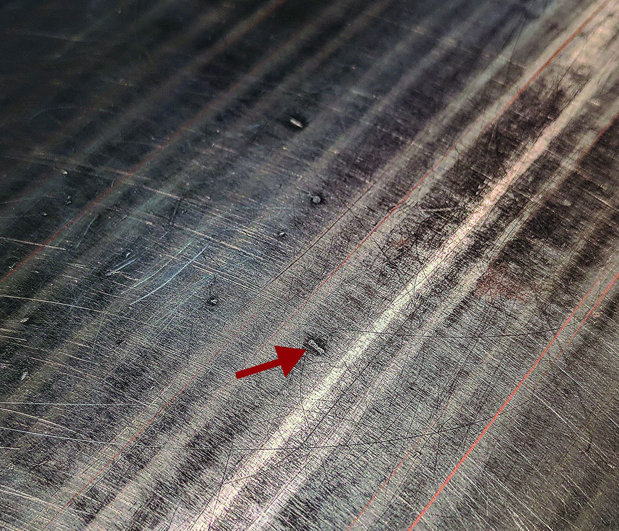

Next, gently slide one of the stones onto the work. Using just the weight of the stone, fish around for what I call “crunchies.” If you feel any loose debris rolling between the stone and work, stop immediately and reclean the workpiece surface. As you find small, raised areas or projections, the stone will bite—hence the name crunchies. You can begin to bear down with a little pressure to cut the bump and make that area flush with the main workpiece surface. Be sure to follow any machining or grinding lines already present in the workpiece.
If done correctly, you should be rewarded with a tiny pinprick of a low spot surrounded by a polished ring in the shape of the ding (Figure 3). This polished ring is flush with the surrounding surface to limits approaching 10µin. (0.0003mm).
