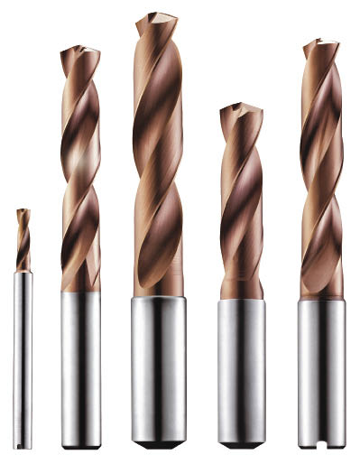

A cooling flow of metalworking fluid can be a significant contributor to machining productivity. The coolant reduces cutting temperature, provides lubricity and aids chip evacuation. However, the cost of coolant, growing environmental concerns about coolant disposal and chip recycling considerations are prompting many shops to look at dry machining or minimum-quantity-lubrication alternatives.
The viability of machining dry depends on several factors. The characteristics of some workpieces can make dry machining impractical; machining materials that dissipate heat poorly, workharden quickly or are gummy may mandate coolant. The nature of the metalcutting operation being performed plays a role, too. While chip formation occurs unimpeded in milling and turning operations, when drilling, the tool, chips and heat are buried in the workpiece.
Bob Hellinger, national sales manager for toolmaker Guhring Inc., Brookfield, Wis., said operating dry to maximize heat transfer to the chip can be beneficial in some turning operations, “but in drilling that heat is going to stay more in the tool.” The heat can weld workpiece material to the drill and later cause tool failure.
Courtesy of Dennis T. Quinto
The combination of a lubricious coating (in this case WC/C) deposited on a hard coating (TiAlN) facilitates dry drilling as the hard coating resists cutting edge wear while the softer, lubricious coating on the drill flute behind the actual cutting edge facilitates chip flow across the flute and out of the hole.
Despite the challenges of drilling dry, Hellinger said, the process and its close relative, MQL drilling (see sidebar, next page), is catching on for aluminum and cast iron applications. “Automotive is heavily into those materials and they’ve gone to dry and MQL drilling for the benefits of reducing coolant,” he said, adding that coatings are essential when dry drilling is feasible.

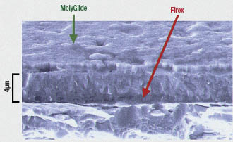

Guhring’s Hellinger said his company began working with the German government about 10 years ago to reduce coolant use in machining. “The first true dry-machining coatings we developed consisted of a multilayer TiAlN and TiN coating topped with a molybdenum-disulfide-style coating for lubricity,” he said.
The coatings are applied via PVD. The coating sequence for the hard multilayer base coating, which Guhring calls Firex, begins with a layer of TiN followed by a layer of TiAlN, then progressive layers of TiN and TiAlN. “That’s where you get the benefits of abrasion resistance and heat resistance, because that material oxidizes at 1,470° F,” Hellinger said. Conversely, he thinks of the molybdenum-disulfide top layer, called MolyGlide, “in terms of Teflon.” It doesn’t perform the abrasion-resistance function of a hard coating, but “put it on top of any coating or substrate and it will keep material from sticking to it,” he said. “It eliminates built-up edge and keeps the chips flowing; it acts like a lubricant would.”
Regarding comparative coating performance, Hellinger cited the example of an 18mm-dia. drill making 50mm-deep holes in cast iron. A TiAlN-coated drill, run dry at 100 sfm and a 14.7-ipm feed, was able to complete 400 holes before regrinding was necessary. A Guhring drill of the same diameter and featuring a Firex/MolyGlide multilayer coating, run at the same parameters, produced 1,200 holes before regrinding. Although the cost of the replacement drill was about 30 percent higher than the original, regrinding and downtime costs incurred with the original drills due to their shorter life were three times higher than those of the Firex/Molyglide-coated replacements.
Guhring recently introduced a nanolayered version of the Firex coating with approximately 80 nanoscale layers in its 1.5µm to 5µm total thickness. “Each layer is thinner, and that helps because if you have crack propagation, it takes a lot more shock to bring it down to the base substrate material,” Hellinger said.

Guhring Inc. developed a coating for dry machining consisting of a multilayer TiAlN and TiN coating (called Firex) topped with a molybdenum-disulfide-style coating (called MolyGlide) for lubricity.

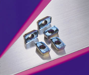

Modulation of coating layer thickness is the focus of a recent upgrade of a DLC coating from Sumitomo Electric Carbide Inc., Mt. Prospect, Ill. Rich Maton, the toolmaker’s assistant engineering manager, said the initial version was a stand-alone coating (not as a final coat over a traditional hard coating) for cutting aluminum and other nonferrous materials.
“While you are shearing aluminum, the chip is continually sliding across the face of the insert,” he said. “Aluminum is very abrasive and would start generating heat.” The DLC coating reduces the coefficient of friction between the workpiece and tool.
The new version of the coating employs more layers built to a greater final thickness. The previous version’s total thickness was 0.05µm to 0.1µm, while the upgraded coating is 0.4µm to 0.5µm thick. Earlier attempts at producing a thicker coating resulted in inconsistent adherence of the coating to the tool. Maton said Sumitomo has developed technology to stack thinner DLC layers to a greater final thickness while improving its bond to the substrate.
According to Maton, the updated coating provides both lubricity and increased abrasion resistance. “By thickening the coating, we are adding more wear resistance,” he said.
He noted that the original coating was a shiny metallic blue, and the new version is more of a gold and green. “Changing the [number of] layers of the coating changed the prismatic feature of the color itself.”
The updated coating still improves lubricity. “We have an H1 carbide that is a high-polish uncoated carbide we use for aluminum. When we add the DLC coating (grade DL1000), the surface is so smooth that the chip not only easily flows across it, but the surface now also has greater lubricity and a reduced coefficient of friction,” Maton said. Increased tool life in abrasive situations is another result. “Not only are your chips not going to stick to your carbide insert, but now you get more wear resistance,” he said.

The key to dry drilling is control of tool-degrading heat. TiAlN and AlTiN coatings possess higher heat resistance than TiN coatings because the aluminum forms an aluminum-oxide film during machining that acts as a heat barrier and promotes heat transfer into the chip rather than the tool. Toolmakers have recently developed coating materials that include chromium and silicon to further strengthen that heat barrier via formation of chromium and silicon oxides.

These drills are coated with the multilayer AlCr-based Balinit Helica from Oerlikon Balzers; the company says the coating’s hardness, resistance to oxidation at high temperatures and its low coefficient of friction make it beneficial for dry drilling.

An update of Sumitomo’s DLC coating involving deposition of more layers to a greater final thickness changed the prismatic characteristics of the coating surface, resulting in a gold/green look to the updated coating (bottom), compared to the original metallic blue (top). Turning inserts are pictured to better show the color difference.
