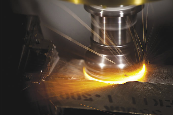

A KCRA-grade ceramic tool from Kennametal. Image courtesy Kennametal.
The list of workpiece materials includes plastics, aluminum, stainless steel, nickel-base superalloys and refractory alloys—high-temperature alloys that contain elements such as tungsten or molybdenum.

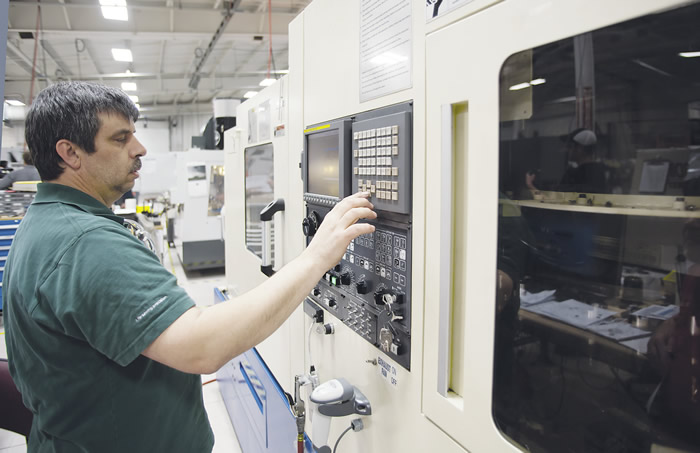

Machinist Joe Wetzel sets up an operation at Protomatic. Image courtesy Protomatic.
“The problem is, that only works if the relevant sounds are in the spectrum that humans can hear with the naked ear—and that’s just no longer always the case,” Wetzel added.
Now, technology is handling what used to take human skill.
“We use a frequency-analyzer microphone that allows us to analyze where the harmonics are occurring, and, based on what it tells us, we can adjust to a smoother speed and feed rate,” he said. “And the machine tool makers are beginning to incorporate this kind of tool into their machines, with sensors and programs that listen and adjust as needed.”
For Wetzel, this is an example of tribal knowledge and experience being supplemented, if not replaced, by technology to work with these materials.
“In some ways, we’re making smarter systems while dumbing-down what the operator needs to know, so the machine [will be] making decisions on this automatically,” he said. “Regarding harmonics, for example, you won’t need a machinist with a trained ear; the machine itself will have the trained ear.”

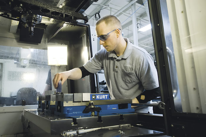

Improvements in cutting tools make a big difference in Protomatic’s ability to compete, according to Wetzel. For example, Smith emphasized the advantages of 5-flute, helical cutting tools, especially when cutting Inconel. “The multiple flutes seem to do a lot better on the tougher materials,” he said.
Les Smith, Protomatic’s senior machinist, loads a rocket-engine component made of Inconel 718 into a Mazak Quick Turn Nexus 200-II M. Image courtesy Protomatic.
It’s not only the geometry of the tool’s cutting edge that concerns Protomatic, but also what is behind it. When machining deep pockets, “you want to keep your tool as short as possible for the sake of rigidity and to minimize vibration,” Smith said. “We’ve learned that it’s better to go part of the way down with a short tool, switch to a slightly longer one and then one that’s longer yet,” and optimize the speed and feed for each tool.
“We’ve found that reduced-neck tools work very well when you get down into the deeper pockets,” Smith said, holding up a tool, “so that the neck isn’t dragging on the wall when you get deep.”

One relatively “new trick” for cutting the hard and high-temperature nickel-base superalloys used to make aerospace engine components is ceramic tools. Matthieu Guillon is the global portfolio manager of advanced materials for Kennametal Inc., Latrobe, Pa. He has watched as these superalloys have allowed aircraft engines to run at higher temperatures and said ceramic tools can offer an advantage to supply-chain job shops that are tasked with cutting them—but only when applied correctly. This is because ceramics are brittler than carbides, he noted.
“There are important things machinists need to keep in mind to maximize the performance and life of their ceramic tools,” Guillon said. One is to be mindful of how to keep them cool when milling and turning. Kennametal’s double-sided KCRA-grade (Kennametal ceramic round air) ceramic platform is meant to be run dry, and has a feature in the clamping system that delivers air flow to the insert’s cutting edge to improve chip flow and insert life. “Regular-air or cold-air blasts are applied for better chip evacuation,” he said.
But where milling with ceramics is done dry, turning with ceramics requires coolant—but only the right amount. “Ceramics need heat to run well, meaning too much coolant in turning can actually be counterproductive,” Guillon said. “You need to establish a range based on your equipment, toolholder and coolant delivery. High-pressure coolant systems of 1,000 psi will work well with catalog parameters in clearing chips and keeping the pocket clean. On some dedicated equipment, ultrahigh-pressure coolant will be applied at increased parameters.”

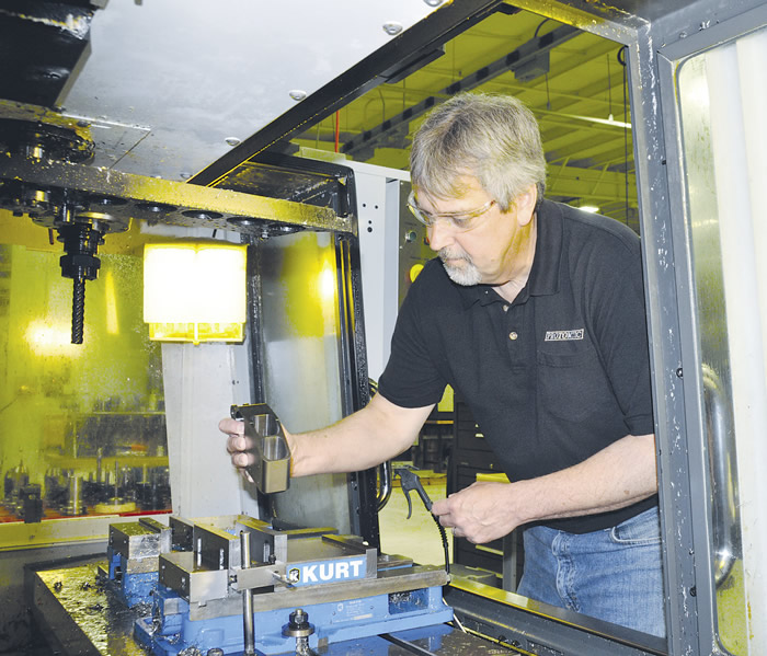

Back at Protomatic, the component being machined from 1018 steel was quickly finished. For the next task on the Haas, “we’re going to 17-4 steel, which we can machine at about 100 ipm,” Donajkowski said.
OSG USA’s WDO SUS coolant-through drill is for cutting titanium and hardened stainless steel. Image courtesy OSG USA.
Wetzel described the company’s commitment to training, QC and process-improvement initiatives as a must for an aerospace supplier. And an important component in all of those is keeping up with processes and technologies that can increase customer value, he said.
What the right tools and toolpaths also allow is greater flexibility, he explained. With them, even when machining challenging metals on a light-duty VMC, Protomatic can meet its customers’ quality, turnaround and cost requirements, he said.
“We can do lots of fast, light cuts—and we can compete.”

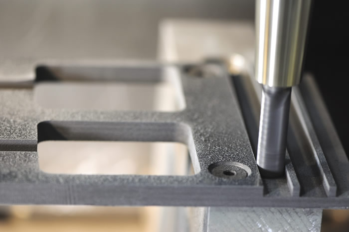

OSG’s BNC router machines a composite material. Image courtesy OSG USA.
Composite components are most commonly made from prepreg—resin-impregnated carbon-fiber tows that are
layered and then cured into a lightweight, strong material. But those layers can’t be cut in the same way as a solid piece of metal.
“In metalcutting, of course, you don’t have those layers. In composites you layer one laminate on top of another. But if the composite material heats up too much or isn’t cut properly, the layers start coming apart,” Aly said. “That’s delamination, and we don’t want that.”
He said: “We get called in when a shop is having tool life issues or quality issues resulting from the wrong tool being used. We see delamination of materials, splintering, burrs, fiber pullout—things along those lines. Usually, it’s just a matter of applying the right tool for the situation.”
The metalcutting legacy of many composite-machining shops can manifest in other ways as well. “When machinists bring that metalcutting mindset to composites, sometimes they think about the tool cost more than about the tool life and the overall cost of putting a part on the floor,” Aly said. “A diamond product may be more expensive than what they would normally think about using. We have to explain and prove to the customer that they may pay a little more for the tool, but they’re going to get a lot longer tool life, and, in the end, the per-piece cost is going to be less.”
