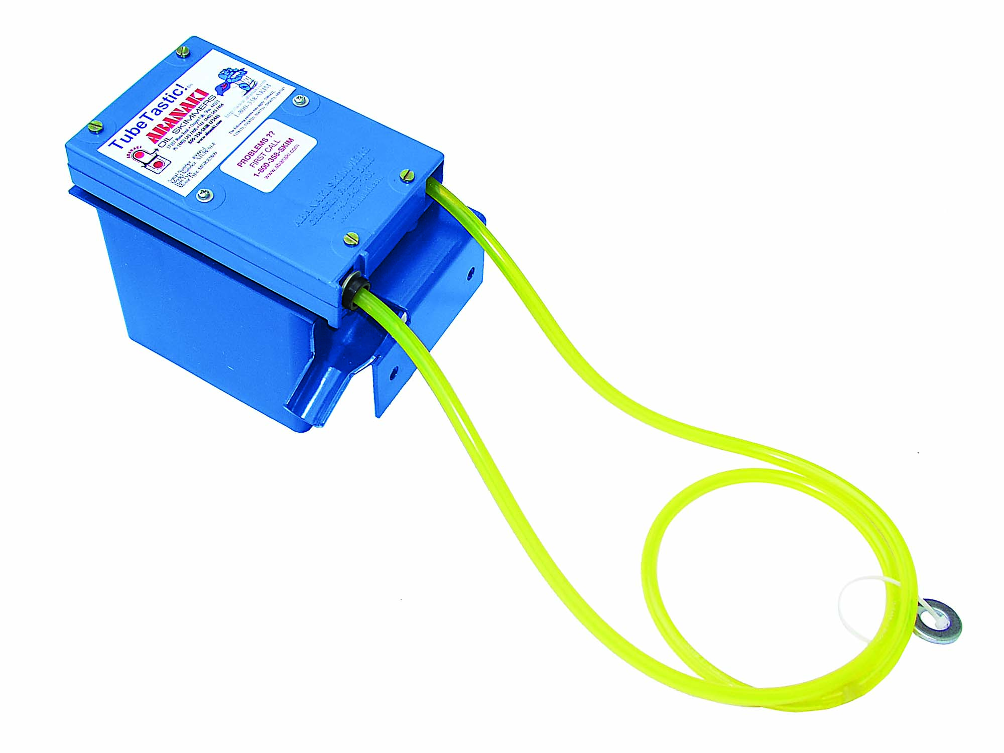

The TubeTastic! easily can be mounted on the side of virtually any machining center coolant sump. Image courtesy of Abanaki

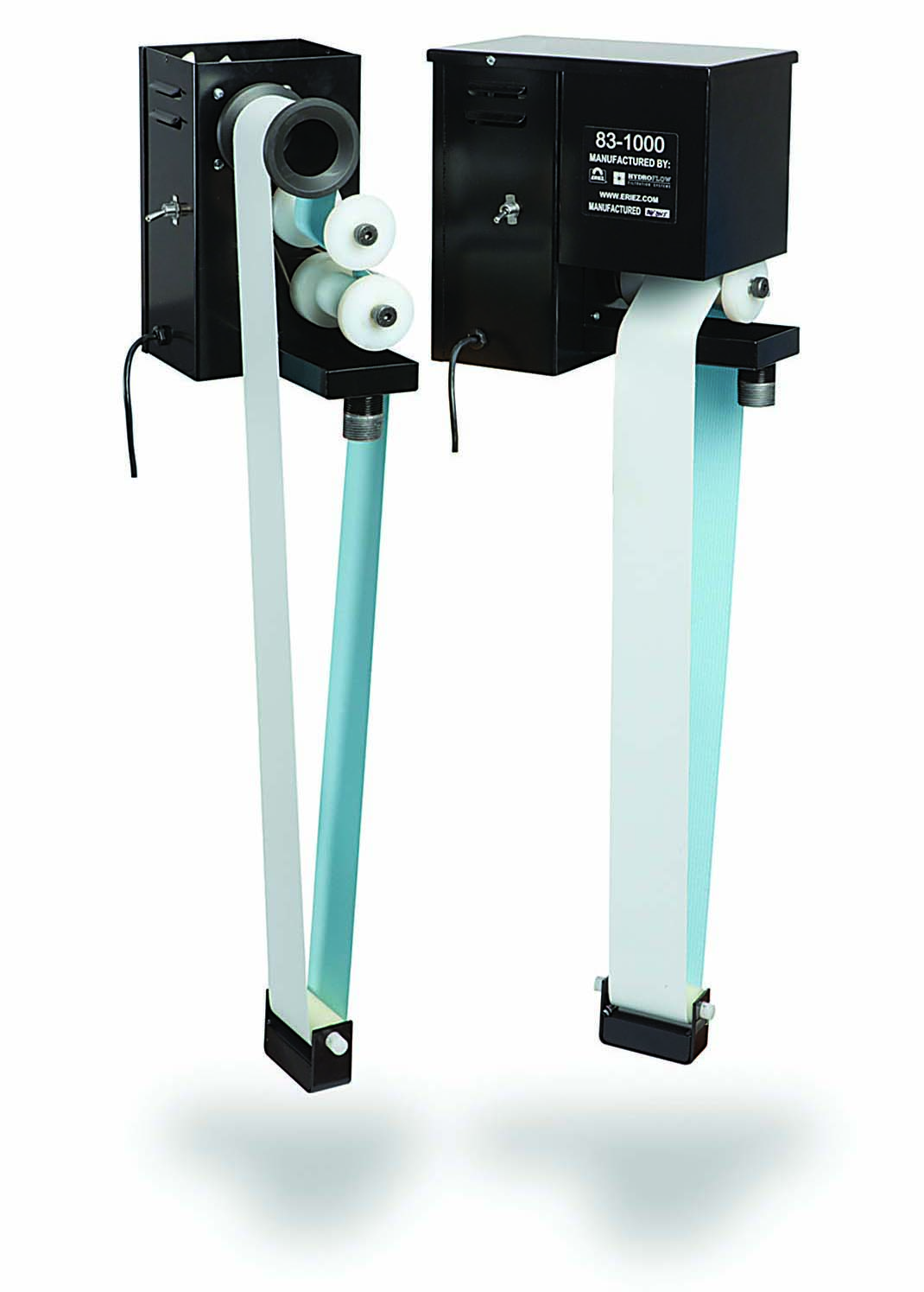

Belt skimmers are also a good choice for deeper sumps because shops can get belts with different lengths to go down as far as necessary, said Ron Wendt, product manager at Erie, Pennsylvania-based Eriez Manufacturing Co., which sells belt skimmers.

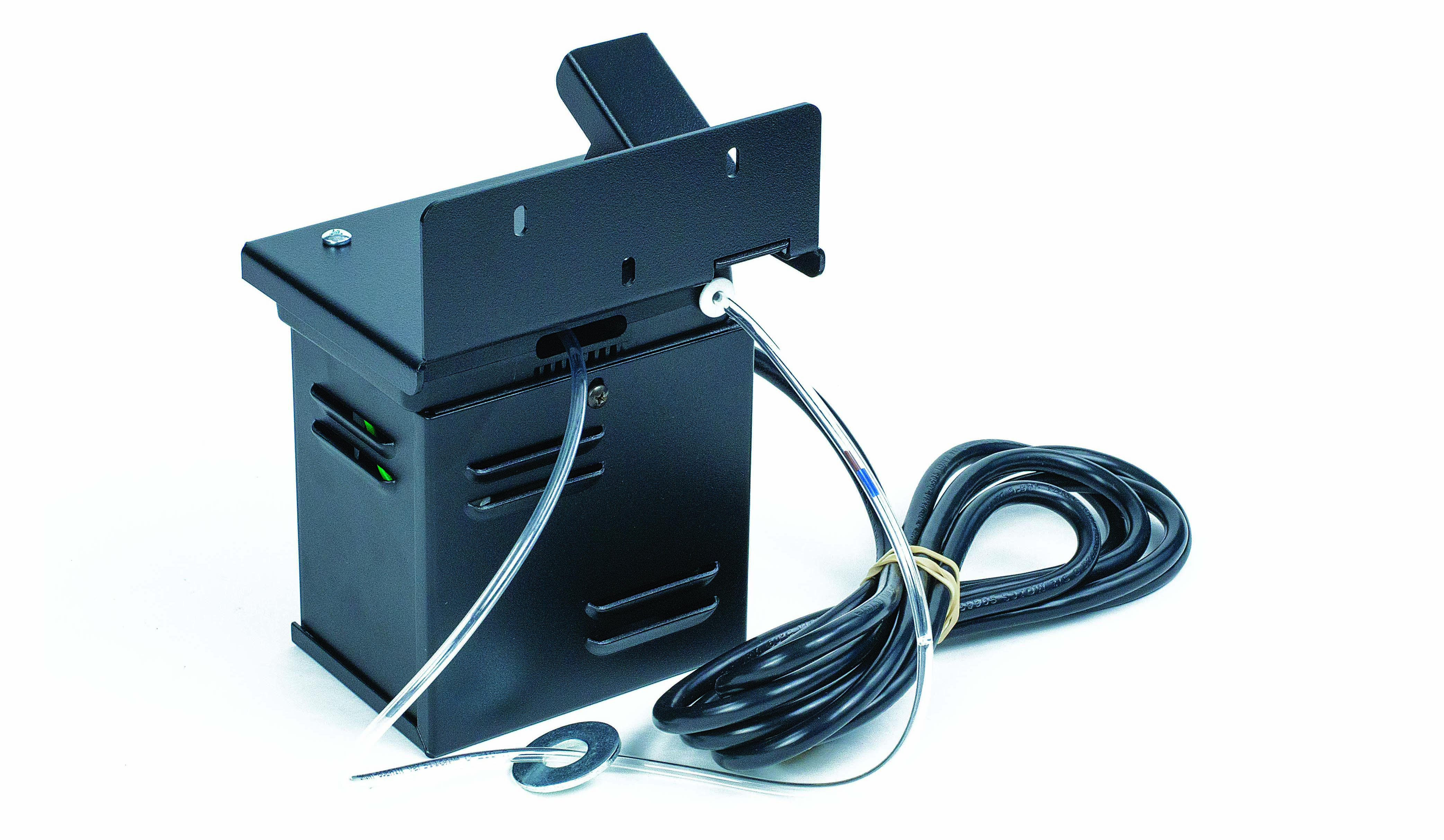

In situations in which a sump is very difficult to access, he believes that tube skimmers are a wise option because they can go in through the side of the tank. Featuring a magnetic base add-on, for example, Zebra Skimmers’ Sidewinder tube skimmer can be mounted to the side of a sump so the tube can drop in through the side. Typically, however, Burkey said shops mount tube skimmers on top of the sump where there’s an opening.
With its magnetic base add-on, the Sidewinder tube skimmer can be mounted to the side of a sump. Image courtesy of Zebra Skimmers
Less expensive than belt skimmers, tube skimmers “are made to get into those hard-to-remediate places,” he said. “So long as the tube isn’t brushing against a surface that would wipe off the skimmed oil, it can go almost anywhere and fit through a very small opening.”
Burkey said tube skimmers like the Sidewinder are well suited for newer machines, which normally have a lower tramp oil load because no way oil or hydraulic oil enters the sump.
“In those situations, it will get up to a quart an hour of tramp oil removal, which is a lot when it’s run 24/7,” he said. “But if there’s a very high tramp oil load, it’s much better going with a belt skimmer.”

The 83-1000E oil belt skimmer removes oil from the belt without requiring adjustments. Image courtesy of Eriez Manufacturing
If the oil simply is disposed of at the end of the skimming process, “you’re throwing out good coolant, which is expensive these days, and you have to pay to get rid of that hazardous material,” Burkey said. “So you might as well return the good coolant (to the sump) and only pay to have tramp oils remediated.”
