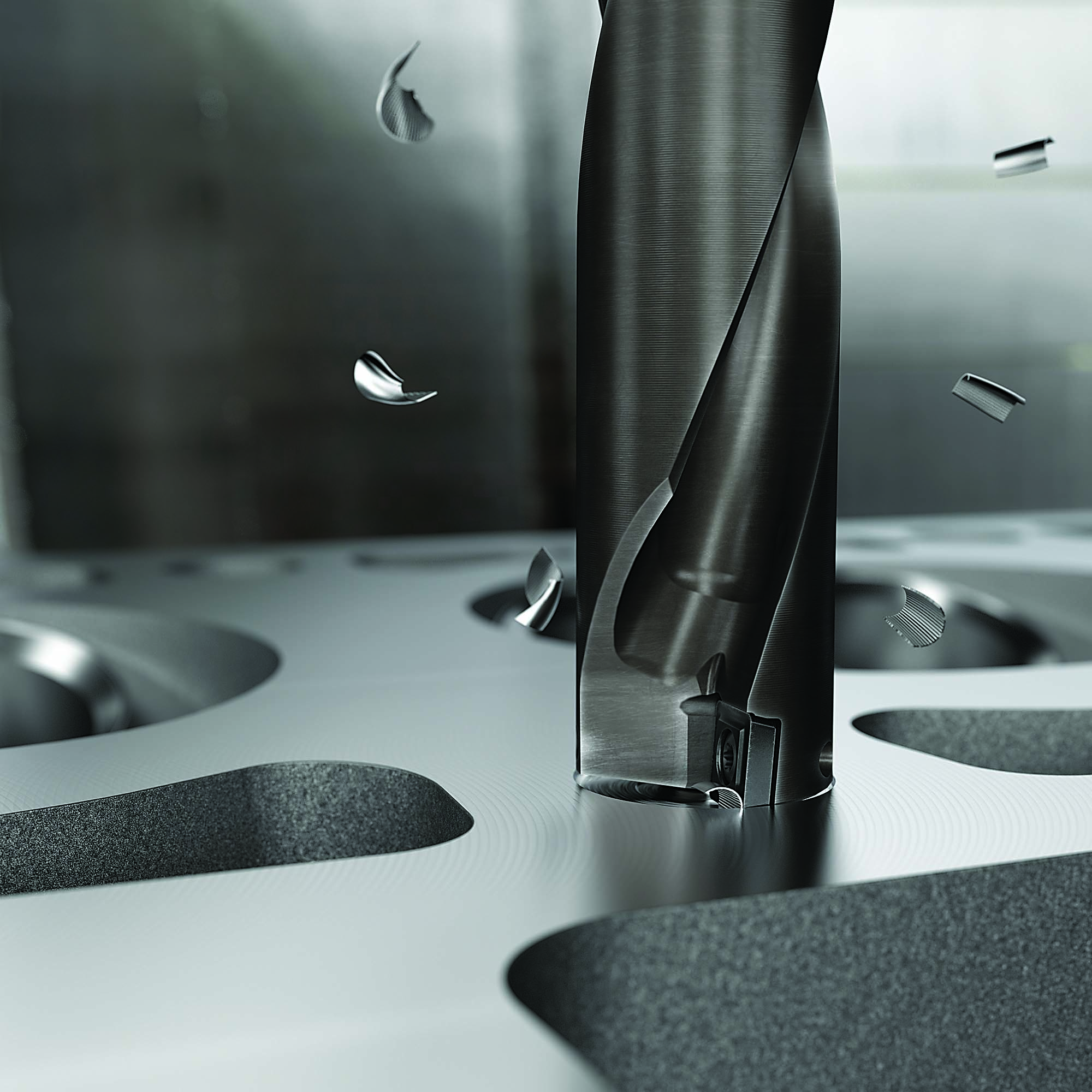

A CoroDrill 880 drill is tooled with CVD-coated inserts.
A CoroDrill 880 drill is tooled with CVD-coated inserts. In addition to holemaking, the tool can be used for helical interpolation, boring, plunging and turning. Image courtesy of Sandvik Coromant

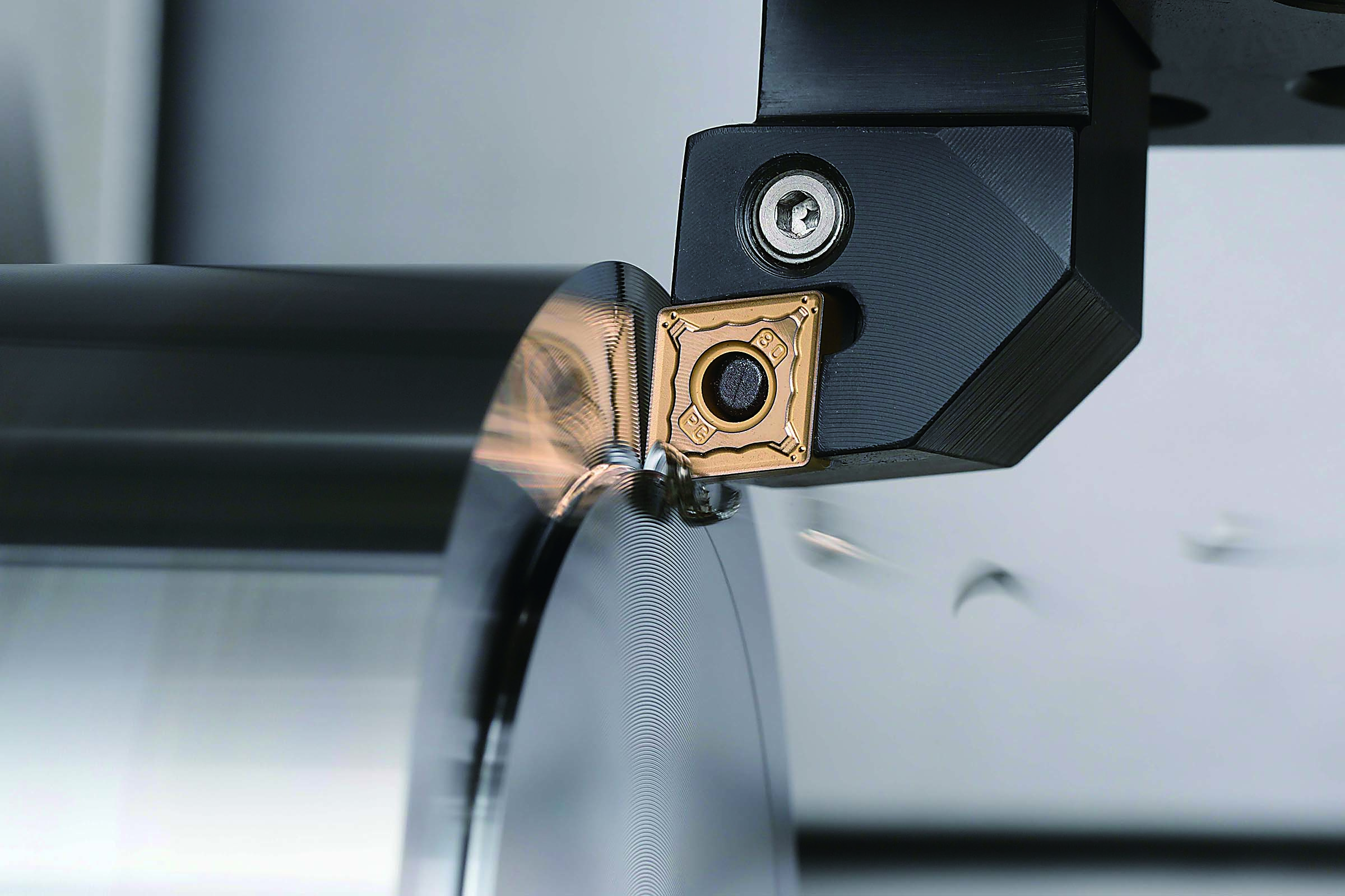

Kyocera Precision Tools The CA025P CVD-coated carbide grade is for turning steel with a high level of resistance to wear, fracturing, adhesion and chipping.
The CA025P CVD-coated carbide grade is for turning steel with a high level of resistance to wear, fracturing, adhesion and chipping. Image courtesy of Kyocera Precision Tools

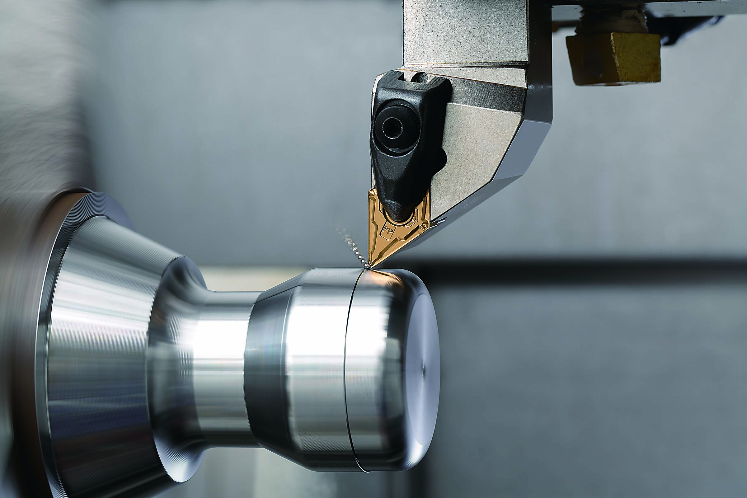

Turning operations, in which an insert continuously cuts a workpiece material, enable CVD coatings to shine. Czettl said CVD-coated inserts are still dominant in turning because they effectively resist abrasion and wear and have a high level of hot hardness to combat carbide’s worst enemy: high temperature.
He estimates that at least 60% of turning inserts are CVD-coated. Milling and grooving, however, involve interrupted cuts, and he said at least 60% of the tougher PVD-coated inserts are used for those applications.
Wilshire said the split is likely greater, with 70% to 75% of turning inserts being CVD-coated and only 10% of milling inserts being CVD-coated.

Drilling sometimes takes a hybrid approach. Wilshire explained that the outer insert can be a CVD-coated one to better resist wear at a high speed when drilling while the center pocket accepts a PVD-coated insert, which has a 0 sfm at the center, and the surface footage only increases away from the center.

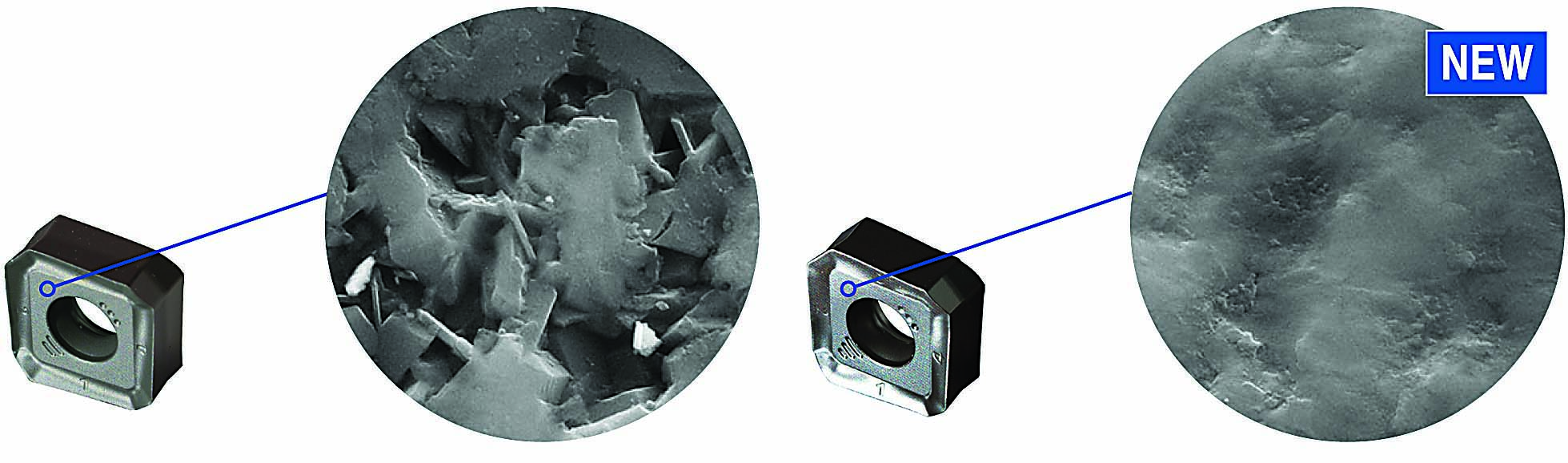

Ceratizit USA A comparison is shown of an insert from Ceratizit that received the company's previous treatment process (left) and an insert with the Dragonskin CVD coating that received the toolmaker's most advanced treatment process (right). According to the company, the advanced treatment process produces an extremely smooth surface, which improves the contact friction between the chip and the rake face to reduce wear, cutting pressure and chip sticking while extending tool life.
A comparison is shown of an insert from Ceratizit that received the company’s previous treatment process (left) and an insert with the Dragonskin CVD coating that received the toolmaker’s most advanced treatment process (right). According to the company, the advanced treatment process produces an extremely smooth surface, which improves the contact friction between the chip and the rake face to reduce wear, cutting pressure and chip sticking while extending tool life. Image courtesy of Ceratizit USA
“So you can increase the speeds, shorten cycle time and increase throughput,” he said about the combination of coatings.
