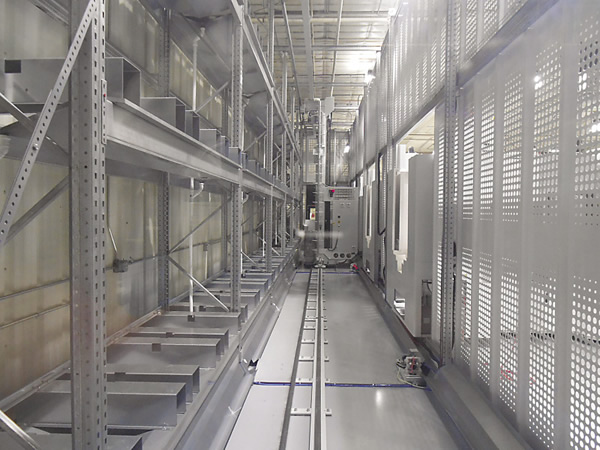

Great Plains Industries Inc., Wichita, Kan., has taken steps to do just that. Beginning in June 2015, GPI kicked off “Project One,” the installation of four MB-5000H Okuma horizontal machining centers equipped with 15,000-rpm spindles and 218- tool matrices, together with an integrated Palletace 60-pallet M-1100 material-handling system built for Okuma by automation provider Fastems, West Chester, Ohio. The FMS includes spindle probing, tool life management, remote monitoring and every lights-out bell and whistle.
