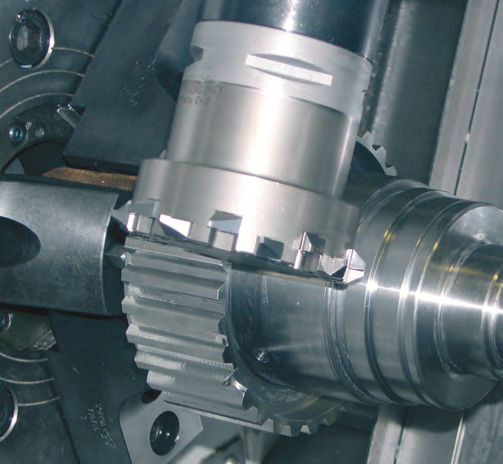

Multifunction grooving systems include tools engineered for application on machining centers as well as lathes. An example is the new line of M275 cutters from HORN USA. The cutters can accept grooving inserts as well as facemilling inserts and have multiple teeth to maximize metal-removal rates.

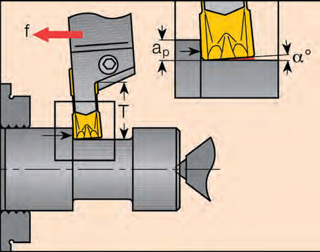

When applying a grooving insert in a turning operation, a controlled degree of deflection is desirable. Without deflection, the tool edge sits flat on the part and the extended surface contact causes chatter. Conversely, when side-cutting pressures deflect the tool in a groove/turn operation, the insert tilts slightly, reducing edge contact with the workpiece. Precise control of variables can achieve tolerances as tight as ±0.0004 “.

Drape’s definition of multifunction grooving tools includes those used on machining centers as well as lathes. An example from HORN is the line of M275 cutters it will introduce at IMTS. The cutters can accept grooving inserts from 1.2mm to 3.25mm wide, but can also handle facemilling inserts capable of 4.0mm DOCs. The standard cutters range in size from 31mm in diameter with four inserts to 98mm in diameter and 10 inserts. Drape said the tools are not for the general facemilling market, but for applications where a smaller tool with multiple teeth is needed to achieve high productivity.

Schmitz said some shops are skeptical about side turning with a grooving tool because “they look at a grooving tool, get nervous and say, ‘I’m not supposed to turn with this thing!’ ” Some of the concern regards tool deflection caused by side forces that are not present in simple plunge grooving. Actually, a controlled degree of deflection is desirable. “When it comes to groove/turning, if you don’t get deflection, the tool edge sits flat on the part and is going to chatter to beat the band because there is a lot of surface contact,” he said.
Conversely, when side-cutting pressures deflect the tool in a groove/turn operation, the insert tilts slightly and tool edge contact with the workpiece is reduced. Schmitz said the deflection must be carefully controlled by managing several variables, including feed rate, cutting speed, DOC, tool overhang, insert width support and the workpiece’s cutting characteristics. When those factors are balanced and kept constant, tolerances as tight as ±0.0004 ” can be achieved. Schmitz said the results are similar to that of wiper-geometry turning inserts for imparting fine surface finishes.
Although programming rough grooving/turning operations is typically straightforward, peak accuracy, especially in finishing, usually requires in-process adjustment, according to Schmitz. “For finish cuts, it’s not going to be ‘program it, hit the green button and go,’ ” he said. “You have to tweak it.” He said changing the feed rate is typically the best starting point for adjustments.
A tool operating in a deflected orientation will not produce a square shoulder, he added. “The key is to program the tool to leave the cut at a 45º angle before reaching the side of the shoulder, and then plunge the shoulder separately,” Schmitz said. “When you are plunging, you don’t have deflection.” Similarly, if a groove needs to be machined at the end of a turned section of the part, the tool should be moved in the direction opposite the feed for about 0.1mm, releasing the deflection, before the plunge grooving begins.

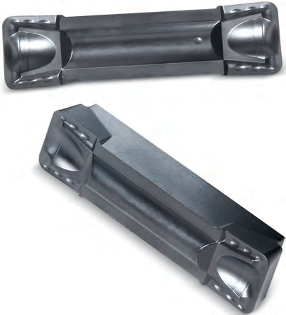

Many grooving tools are designed for certain work materials, but can still be used in other applications. Etling cited the example of tools with Kennametal’s Grooving Universal Positive (GUP) geometry, which produces low cutting forces and good chip control in stainless steels and high-temperature alloys, according to the company. Although those materials were the initial design targets for the GUP tools, he said the geometry has found wider applications in other materials and even selected cutoff operations.

While grooving/turning tools are typically designed to maximize productivity in certain materials, some can be more broadly applied. For example, Kennametal’s Grooving Universal Positive (GUP) geometry lowers cutting forces and enhances chip control when cutting stainless steels and high-temperature alloys, and the tools are suitable for other applications as well, according to the company.
