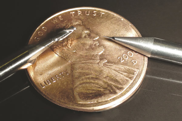

Micromachining is made easier by partnering with a toolmaker that specializes in small. One such company is Midwest Industrial Tool Grinding Inc.
“As the manufacturing industry moves into increasingly smaller products, tooling must be aligned to match those requirements,” said Jennie Nelson, director of sales and marketing at MITGI, Hutchinson, Minn. For example, “diametric and form tolerances of ±0.0001” are becoming very common, and we are frequently asked to go even smaller. At this scale, everything is proportionally more difficult: Tolerances are reduced, tool cores are smaller and web thicknesses become very small.

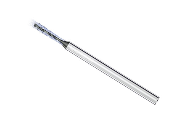

Liechti said the scrap rate for microtool grinding is often high. “They’re very fragile. On a tool measuring 0.008″ in diameter, you may end up scrapping 20 to 30 out of every 100. Even the smallest amount of roughness on an insufficiently dressed grinding wheel is enough to break the tool.”
Growing demand for microparts challenges suppliers, users
Mikron offers through-the-shank coolant in tools down to 0.012
Mikron offers through-the-shank coolant in tools down to 0.012″ (0.3mm) in diameter. Image courtesy Mikron Corp. Monroe.
Despite the difficulties, Liechti said the market for microtools is growing, especially in the aerospace and medical industries, where titanium and nickel-base alloys add fuel to the small-part-machining fire. Anyone who’s machined an Inconel turbine blade or a cobalt-chrome prosthetic implant knows the importance of through-coolant. But how is this achieved when tools are thinner than pencil lead? Liechti said the best way to overcome stringy chips and high heat generation when cutting difficult metals is by placing coolant holes through the shank and forcing cutting fluid down the flutes and into the cutting zone. Mikron offers this feature in tools down to 0.012″ (0.3mm) in diameter.

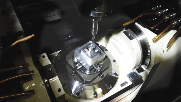

Full 5-axis contouring, as well as 3+2 positioning, of microparts is possible on this this tilt-rotary-equipped Microlution machining center. Image courtesy Industrial Machine Works.

Setting lengths and diameters on microtools, for example, must be done via laser, as mechanical systems tend to break tiny cutters. And while deburring and handling macroparts are tasks to which shops don’t give a second thought, when parts are too small for human fingers and eyes, machining processes must often be adjusted to compensate.
“We try to drop a part complete whenever possible,” Kuhn said. “That’s where 5-axis machines are nice, because, in many cases, you can machine everything except parting [off the part] from the carrier material. For this, we like to use a laser, because even with a very thin saw or parting tool, perfectly good parts sometimes go flying everywhere, never to be found.”
In instances where a secondary operation is needed to machine the back of a micropart or to hold it for deburring, Kuhn said double-sided tape, vacuum and magnetic chucks, and custom fixtures with tiny mechanical clamps are effective. And after machining is completed, measuring microparts can prove problematic as well. “A lot of times, our machines are more accurate than the customer’s existing measurement tools,” Kuhn said.

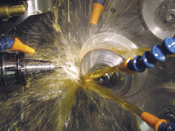

The inside of a CNC tool grinder is a busy place. Here, a small-diameter endmill is ground to size. Image courtesy Midwest Industrial Tool Grinding.
