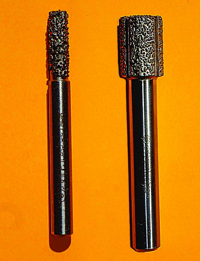

A shop seeking heavy, fast removal of CFRP can employ a superabrasive router with sharp, large diamond crystals, low bond levels and a widespread grit concentration. According to Abrasive Technology, its P.B.S. process permits specifying diamond size, shape and spacing and the bond level.

True Grit
The dissimilar nature of the materials that comprise CFRPs complicates the application of tools such as grinding wheels and discs, drills and saw blades that employ a single layer of diamond particles held on the tool form via electroplating. In electroplating, diamond crystals are entrapped in layers of metal on the tool surface. To hold the crystals on the tool, the layers typically cover 50 to 75 percent of the crystal height. The soft resin of CFRPs can clog gaps between the particles, especially when heavy material removal is desired.
“Plated products don’t, in general, work very well in production composite applications involving fast material removal, due to tool loading. They can, however, be effective in low-material-removal operations or polishing.” said Loyal Peterman, co-founder and president of Abrasive Technology Inc., Lewis Center, Ohio. “There are some applications where an electroplated tool is appropriate, but they always have a full concentration of abrasive, where the diamond particles are pushed closely together.”
Peterman said the company’s proprietary P.B.S. brazed bonding system offers a way to control diamond concentration. In the P.B.S. process, a layer of nickel-chrome alloy is melted and bonds, or brazes, the diamond crystals to the desired tool form. The method produces a variety of tool shapes and configurations with control of the lateral spacing of the diamond particles and the amount of diamond exposed above the braze material, he noted.
“In electroplated products, you have to cover up at least half of the diamond to be able to hold it into the bond,” he said. “With the P.B.S. product, we only need about 30 percent of the diamond covered, and therefore we have more swarf clearance vertically as well as swarf clearance between the diamond particles, which is not possible with electroplated products.”
The process employs diamond particles from 45µm to 600µm. “The particles are not round, and they are not square,” Peterman said. “They have an aspect ratio of length to width, and you can buy very blocky crystals or very sharp crystals.”
For machining composites, sharp crystals are preferred because they cut rapidly and run cool. “Blocky crystals cut more slowly and generate more heat, but give you more life,” he said.
Diamond size, shape and spacing, as well as the level of the bond, can be specified in the P.B.S. process for a particular application, according to Tom Namola, manager of product and application development at Abrasive Technology. “We found that the best way to apply superabrasives is to work with an end user, understand their application, and then engineer the tool to their specific material, how it is they are cutting and the equipment they have to do it on,” he said.
For example, a shop seeking heavy, fast stock removal would employ a superabrasive tool with sharp, large diamond crystals, low bond levels (with grits placed farther apart) and a wide concentration. Stock removal would be fast, and the resulting surface finish would be relatively rough. A different tool configuration with smaller diamonds and tighter concentration would be appropriate for finishing. For polishing, fine electroplated particles can be applied via electroplated hand pads or gloves, Namola added.
Peterman said P.B.S. and electroplated tools can be lower-cost alternatives to PCD or CVD diamond tools for short-run, just-in-time manufacturing. Such applications often are industry-dependent; Namola said the composite machining market currently does not see automotive-level production volumes, for example.
On the other hand, Peterman said, large-volume holemaking in CFRPs stacked with titanium, aluminum or other workpiece materials may require premium tools. As an example, he cited the company’s Everlast PCD-veined drills, which feature a PCD drill tip integrated with a carbide drill body. The PCD tip is sintered into the drill, not brazed, and can be modified to provide specific characteristics, such as minimizing breakout on the exit side of a hole. The ability to change the tip geometry, Peterman said, “gives you a pallet to work from” in regard to providing multiple ways to maximize holemaking productivity in CFRPs.
