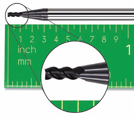

A 3⁄64 “-dia. variable-helix endmill from Harvey Tool enabled Precision Technologies to more than quadruple the feed rate and increase the axial DOC by 2.5 times when milling tiny slots in a stainless steel medical component.

The tool was a 3⁄64 “-dia. endmill for creating six 0.0625 “-wide × 0.125 “-deep × 0.300 “-long slots. Precision Technologies was cutting the slots with a standard 3⁄64 “-dia., 4-flute, uncoated endmill run at 10,000 rpm and a 1-ipm feed on a Mori Seiki vertical machining center. “We couldn’t get the speeds and feeds we needed out of it, and the tools would break on us,” Rogier said.
Failure came without warning for the delicate tools. “You wouldn’t hear anything,” Rogier said. “You would go over and look at the part and notice that the slot wasn’t there.”
Childs noted that the standard endmill would snap at 2 ipm. “One ipm was the best that we could get.”
To solve the problem, Childs suggested applying a variable-helix miniature endmill from Harvey Tool Co. LLC, Rowley, Mass. According to Harvey Tool, the variable-helix design reduces chatter and harmonics and permits increased metal-removal rates. Tool geometry is complex; spacing varies between the flutes, and the helix angles change not only from flute to flute, but also along each flute’s length. And to maintain consistent cutting edge relief, the rake angles of each flute also vary. An AlTiN Nano coating provides increased hardness and heat resistance compared to uncoated tools.
Harvey produces the tools in diameters from 1⁄32 ” to ¼ “. “We sell a lot of variable-helix tools from different manufacturers,” Childs said. However, such tools under 1⁄8 ” in diameter are not that common.
The trials were successful, enabling the feed to be more than quadrupled. “We started the tool from Harvey at 5 ipm,” Childs said. “It was silent.”
In addition, the tool remained intact when the axial DOC was raised from 0.01 ” to 0.025 ” per pass.
“As far as the run time,” Rogier said, the new tool “probably cut it to a quarter of the time. I don’t think I ever broke a tool.” While tolerances were not particularly tight at ±0.005 “, Rogier said “the tool held the same dimensions all the time. It didn’t vary at all.”
Childs noted that the Harvey tool reduced cycle time for the job by 2 minutes. In total, Precision Technologies reduced the cycle time from 90 minutes to about 45 minutes.
