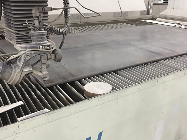

A 60″×120″ piece of steel is cut on a waterjet machine at Savannah Machinery Works. All images courtesy C.Tate.

Waterjet cutting has performed well for us. Waterjets are not like traditional chip-making machines and, when we started using the process, it was new to everyone on my team. Although we had a basic understanding of its capabilities, we were not prepared for the transition to waterjet cutting. We learned some valuable lessons during that transition.
Care and Considerations
For example, waterjet cutting generates a large volume of waste. Over time, spent garnet and swarf will fill the tank. Waste removal requires draining the tank and hiring a contractor with a special truck to vacuum out the sludge, which is similar to grinding swarf.

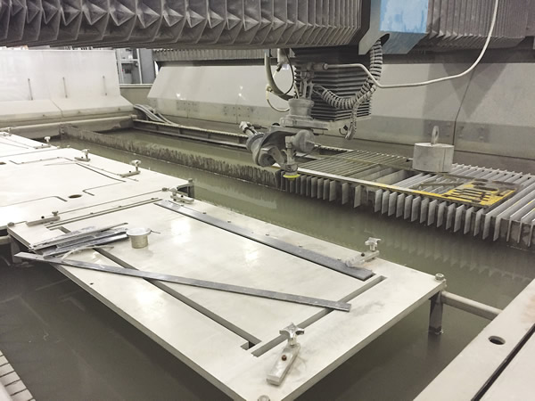

The use of dedicated fixtures on flatbed waterjet machines reduces opportunities for error and decreases setup times. These stainless steel fixtures are welded to the tank.

Raw materials are typically supported by slats that traverse the waterjet tank. Cutting parts that are smaller than the gap between the slats can be challenging, as the parts tend to fall away from the stock and sink to the bottom of the tank, which is inconvenient. Be aware that you will need to develop special techniques or purchase special items, such as waterjet bricks, to help cut small parts. Dealing with small parts is not a problem if you are prepared; again, the applications engineers from the manufacturer can help.
