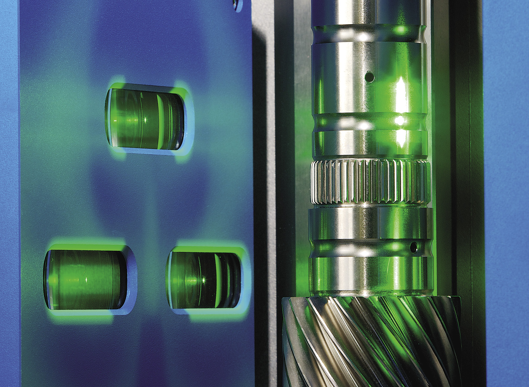

The reduced size and shape of inspection equipment is making it easier for operators to get fast, immediate inspection results on the shop floor. Jenoptik’s Opticline optical shaft-measuring system is one example of this, where several measurements can be taken in seconds. Image courtesy Jenoptik Industrial Metrology North America.

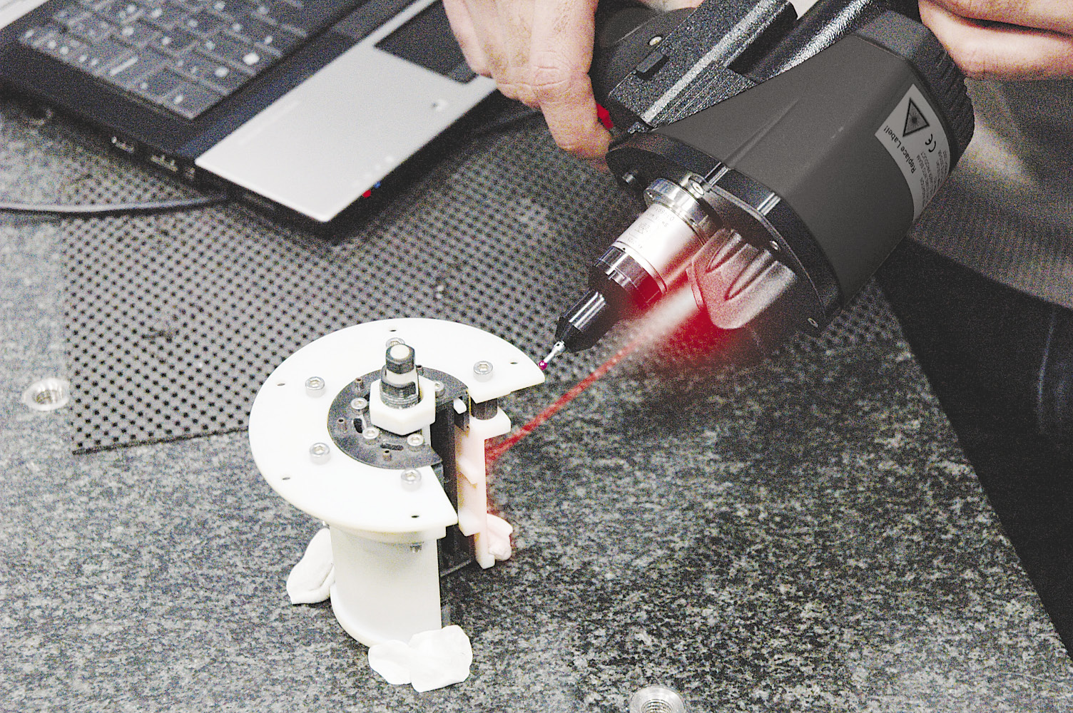

A critical factor on the shop floor is repeatability, Solberg added. “By taking the probe from the CMM and putting the technology on a Romer Absolute Arm (from Hexagon Metrology), for example, the shop floor operator now has a repeatable measuring process. In the past, different operators would provide different measurement results.”

Hexagon integrates a laser scanner on the portable Romer Absolute arm. Image courtesy Hexagon Manufacturing Intelligence.

Mason emphasized how Hexagon integrates a laser scanner on a portable arm. “When floor space is at a premium—and it always is—you can stick our equipment anywhere on the part,” he said. “A Zero-G counterbalance supports the elbow of the Romer Absolute arm, eliminating all the torque from the elbow back to the base of the arm. When you do that you’re no longer flexing tubes and twisting things, which make the system much more accurate.”

Speed and ease of use are two other areas grabbing attention for shop floor metrology equipment. “Jenoptik’s Opticline (fifth generation) takes a few seconds to achieve several measurements at the push of a button,” Blind said. “Another example is Jenoptik’s CFM, a dedicated shaft-measuring CMM that delivers submicron accuracy right on the shop floor.”

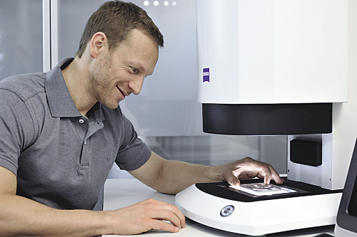

The push for shop floor inspection focuses on more product-specific measuring programs and machine firmware optimized for specific production applications. Image courtesy Zeiss.
Closer inspection
Customers are placing emphasis on streamlined, smart, safe and transparent measuring processes, according to Blind. “Shop floor personnel do not need to have a deep, educational understanding of the gaging and metrology devices in their production lines. We do not believe they need to know them all,” Blind said. “The instrumentation should be easy to use and self-explanatory. We are simply trying to make systems that are easier to use.”
