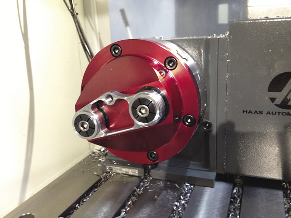

One excellent example of this is an aluminum landing gear component made by one of Mitee-Bite’s customers, Straightline Precision Industries Inc., Sidney, B.C. (see photo above). Here, the part was machined nearly complete on a tilt-rotary table—all that remains is to grip the center section and remove the carrier. Another approach is locating on internal part features. A pair of adjacent holes makes a nifty place to grab a part, which is why Mitee-Bite and other workholding providers carry a range of expansion clamps and internal collets to grip a 3/16 ” diameter or smaller. Bishop pointed out a recent example of this with Haas Automation, where a rotary table was used to machine the part in several operations, the final one locating off a pair of 1.375 “-dia. bores (see photo below).
The final operation on this part uses a Haas HRC210 rotary table and locates two 13/8 ” diameter bores to hold the part while several holes and slots are machined on the profile. Image courtesy Mitee-Bite Products.

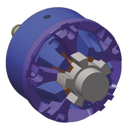

One of Homan’s balancing acts was a high-volume automotive part, turned on a Wasino gang-style CNC lathe (see photo on below). A 5-jaw collet chuck gripped the inner hub on the P/M part, while a matching set of locating surfaces supported its outer ears. Because automation was used, part locating confirmation was done via an inline air sensor. Homan also equipped the chuck with through-spindle coolant.

A 5-jaw collet chuck, equipped with air seat confirmation and through-the-spindle coolant, grips an automotive part. Image courtesy Stace-Allen Chucks.
Homan said these were unique examples of what’s possible. “Neither of these have incredibly tight tolerances—they just had weird geometries and orientation strategies. Both were complete one-offs. Whenever possible, we like to use one of our standard chucks rather than a custom, as there are fewer unknowns. But with weird parts like this, it often needs to be designed from the ground up.”
