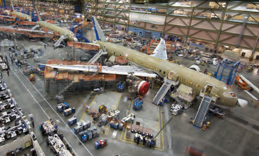

From the F-35 Lightning II to the mammoth Airbus A380 and the Boeing 787 Dreamliner, composite/metal stack materials, most often consisting of multiple layers of carbon fiber-reinforced plastic (CFRP) composites and aluminum or titanium, have made a big a splash in the aerospace industry.
The Dreamliner, for example, is made up of (by weight) 50 percent composite, 20 percent aluminum, 15 percent titanium, 10 percent steel and 5 percent other materials. By volume, the aircraft will be 80 percent composite. Each 787 contains approximately 35 tons of CFRP, a good portion of it stacked in conjunction with aluminum or titanium alloys.
Courtesy of Boeing
Constructed of 80 percent composites by volume, each Boeing 787 Dreamliner contains 35 tons of CFRP, and a good portion of it is stacked with aluminum or titanium alloys.
