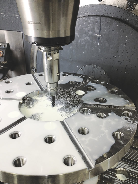

A Schunk CAT40 TENDO Platinum hydraulic toolholder used in a finish milling application.
While hydraulic toolholders have been around for many years, there’s still a good deal of debate about their utility. Advocates extol the extremely tight TIR, crushingly high gripping force and simple operation of hydraulic holders, while detractors say they are expensive and limited to certain applications. The detractors instead tout the versatility and dependability of other toolholding methods. Ultimately, it’s up to the individual machine shop to decide if they are an effective choice.

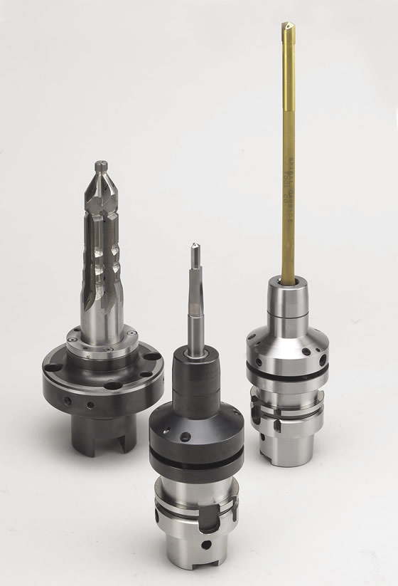

From left to right, a special flange-mounted hydraulic holder and two hydraulic holders with standard shank mountings.
The main advantage of hydraulic toolholders is their ability to securely grip the tool shank, which reduces TIR. “The industry was looking for lower TIR, something that would hold a cutting tool closer to the center line,” Fara said. “The main reason for that is that for every 0.001 ” the tool goes off center, you [immediately] sacrifice 10 percent of your tool life because chip load is no longer evenly divided amongst the flutes of the cutting tool. Whatever side is offset takes the brunt of the chip load, so wear is accelerated because there is more work being done by one side of the endmill than the other. Hydraulic toolholders, with their extremely tight TIR, were an answer to that.”
Similar to other types of tooling, a variety of hydraulic toolholder classes are available. For example, Hydra-Lock offers three: Class A uses a solid-steel expanding sleeve, Class B uses a slit-steel expanding sleeve for greater expansion for a given pressure, and Class C uses the company’s Hydra-Fibre plastic material in the sleeve and is for holding thin-walled and out-of-round parts or tools.

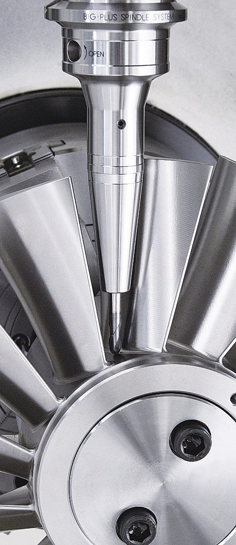

BIG Kaiser’s Super Slim line of toolholders takes advantage of the low clearances available with hydraulic toolholders.

“The technology has obviously advanced since we stopped manufacturing [hydraulics],” he said. “Given that, I’d say the biggest advantage hydraulic chucks have over, for example, milling chucks is that they can fit the size of the workpiece. Clearance is a big issue, and the milling chuck has a large nut on the front end, which can be a major size limitation. Hydraulic chucks can maneuver into smaller spaces while maintaining good rigidity.”

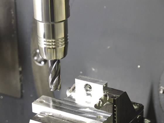

High clamping force and repeatability are major appeals of hydraulic toolholders like the Schunk TENDO Platinum line.
Despite the critics, Schunk’s Panosh asserts that hydraulic chucks are more versatile than they’re given credit for, especially when applied properly. “If you want to get the most benefit out of hydraulic toolholder, you probably want to direct-clamp the tool shank,” he said. “For example, our TENDO EC is only available in sleevable sizes, but even when you’re using a sleeve, you’re concentrically clamping. The difference is the added tolerance that comes with the sleeve, so you get slightly more runout and less repeat accuracy. Direct clamping runout is 3µm or less; adding the sleeve is still 5µm or less.
