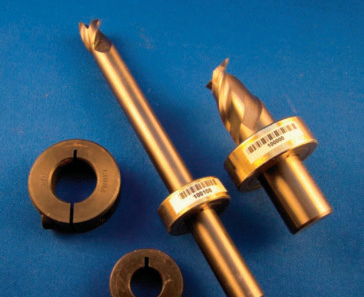

Figure 1. Shaft collars mounted on endmills permit repeatable tool-length setting with a tight tolerance.

Controlling tool length is important, and, fortunately, there are some simple procedures to set the tool length repeatedly with a tolerance at least an order of magnitude better than the ANSI standard.
One strategy is to use a shaft collar (Figure 1). Prior to the mating of the tool and holder, the collar is clamped on the endmill. When the endmill is inserted into the holder, the collar provides a stop for the axial position of the tool. With the collar in place, the tool length is held constant for all types of holder styles, including shrink fit, collet and hydraulic.
In shrink-fit holders, the collar should be left in place until the holder is cool. In collets or hydraulic holders, the collar should be left in place until the collet is tightened or until the hydraulic clamping is achieved. The collar can also be used to accurately position the flutes and improve balance repeatability.

A cutting edge can be aligned with the slit in the collar (like a gun sight), and then the slit can be aligned with a witness mark on the toolholder (see Figure 2). This sets the teeth in the same angular position with respect to the holder every time the tool is changed.
The position of the shaft collar on an endmill can be set, for example, using a Stop-Loc device (Figure 3). The sliding stop on the Stop-Loc is set to the desired length of the tool minus the thickness of the collar. The tool tip is placed against the sliding stop, and the collar is attached to the endmill at the end of the device. The collar is held in position with a screw clamp. The collar then provides a stop for the tool when it is inserted in the holder. After the tool is inserted, but before cutting, the collar is removed. Experiments have shown that most operators can use this procedure to quickly and reliably set the tool length with a tolerance of ±0.004 “. CTE
