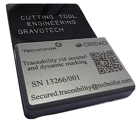

Gravotech and ORIDAO’s interactive marking technology incorporates micropercussion marking and a RFID microchip (lower part of device).

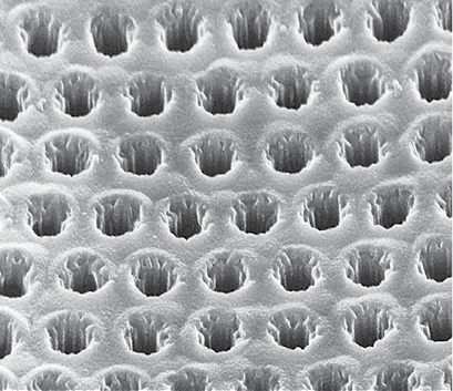

The a. Morpho butterfly (top) creates colors through light-diffracting holes. Nanotech Security’s nanohole arrays (bottom), created via electron-beam lithography, are meant to mimic this effect. This array has nanoholes that measure 250nm in diameter, and the spacing between the holes (center to center) is about 500nm.

One of the new methods of securely marking manufactured parts is electron beam lithography (EBL). Nanotech Security Corp., Vancouver, B.C., is developing an EBL process to generate complex graphics.
130709_all_0691.tif
Courtesy of FOBA

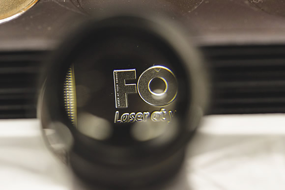

Micromark on a coin applied with a FOBA laser and viewed through a loupe.
According to Clint Landrock, Nanotech’s chief technology officer, “The EBL system patterns a controlled array of holes in a thin-film material, or resist, which is transferred to a master, typically made of quartz. The median hole size for the structures we create is about 100nm in diameter, and the actual structures can have hole sizes anywhere from 50nm to 350nm in diameter, depending on what the optics need to do.”
The array diffracts light and, when viewed from different angles, can create multiple colors. Full-color images are similar to the holograms traditionally found on credit cards and other secure documents but offer more detail and a wider, richer variety of color. The master then replicates the structure onto a secondary nickel master for production. Anticipated resolution is about 250,000 dpi. The graphic device can be applied as a patch or foil and adhered to parts or documents, or it can be directly applied to parts made of metal or other materials.

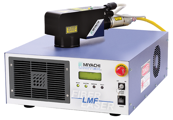

Fiber laser markers, such as this one from Miyachi America, can create pictures, bar codes or specialized codes, as well as alphanumeric sequences.

The range of methods to securely mark parts has grown thanks to an alliance between Gravotech Group, Rillieux-la-Pape, France, and ORIDAO, Montpellier, France.
Gravotech’s Technifor unit produces marking equipment that applies laser, micropercussion and scribing technologies for permanent traceability and unique identification. For example, the company’s micropercussion machines are used to mark data that includes the vehicle identification or serial numbers.
“Micropercussion displaces metal without removing it,” said Bon Carter, business manager for Gravotech Inc., Duluth, Ga. “The permanent marking, which typically incorporates special fonts for security, literally changes the structure of the part such that grinding or filing cannot erase the identification.” Although the depth of the marks depends on the type and thickness of the material, maximum achievable depth would near 0.3mm (0.01 “).
The Gravotech/ORIDAO venture targets marking applications on high-value parts, including engine components and structural assemblies for aerospace and defense applications and medical implants and appliances. The companies have developed an interactive marking technology (which they call “augmented traceability”) that incorporates conventional marking and RFID microchips.
A readable tag applied to the exterior of a part can include alphanumeric data, such as part description, serial number and date of manufacture, as well as bar codes, QR codes and other markings. Additionally, an RFID microchip can be permanently enclosed in a plate or tag or directly into a part. This is accomplished through a process called “hardening,” whereby the tag is placed in a shell or container suitable for the environment and can be attached, depending on the part, with rivets, industrial adhesives, epoxy or hose clamps. The chip contains relevant information, which can be read by any standard RFID reading device. Over the part’s life cycle, additional information can be encoded into the chip. This could include regularly input data, such as maintenance intervals, or the number of flight hours for an aircraft engine part, according to Carter.
Nicholas Reffe, CEO of ORIDAO, added: “Critical information cannot be erased or corrupted. As a result, the part’s history can be accurately maintained through the supply chain. This information is invaluable in situations where components are rebuilt or parts are salvaged for subsequent reuse.”
The objective of the system is to keep the information compact yet readable, even in hostile working environments. Tags can be hardened to resist temperature and vibration and, in some cases, incorporate composite or ceramic layers to extend life. The process is currently on the market and is being used by the aerospace industry for aircraft components, as well as by the military and oil and gas industries.
“Certain parts on offshore drilling rigs, for example, require marks that are not only permanent—so as to avoid counterfeiting—but that can record life cycle history,” Carter said.

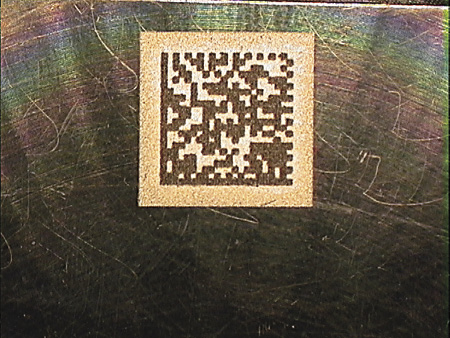

A 2-D coded matrix applied to a motor top using a laser from Miyachi America.

Another laser builder, Miyachi America Corp., recommends different lasers for different marking jobs. “Fiber laser markers can create pictures, bar codes or specialized codes, as well as alphanumeric sequences, on metals, ceramics and some plastics,” said Dr. Mark Boyle, laser product engineer for Monrovia, Calif.-based Miyachi. He noted green vanadate (532nm) and UV (355nm) marking systems are used primarily for high-contrast marking on plastic and specialized marking, such as 2-D matrices, bar codes or other coding, on metals.
Different types of lasers are necessary not only because of the various workpiece materials that are marked, but also to accommodate the way in which markings are applied. For instance, certain high-value parts are marked individually, as they require information specific to the part. Components produced in bulk must be marked in-line for greater production efficiency.
For permanent marking of high- value metal parts, such as titanium and stainless steel ones, the part can be annealed. “Compared to engraving, which requires metal removal, the annealing process uses heat to build oxide layers that cannot be removed,” Boyle said. “With this process, it is also possible to impart certain colors to the markings for further security.”
Many manufacturers are marking parts with 2-D bar codes and other matrices that are nearly indistinguishable to the eye but can be easily read with the appropriate reader.
Another reason for the popularity of laser marking systems is cost. According to Boyle, an ultrafast system capable of marking the widest variety of materials can cost in the area of several hundred thousand dollars, while a basic system can range from $40,000 to $50,000.

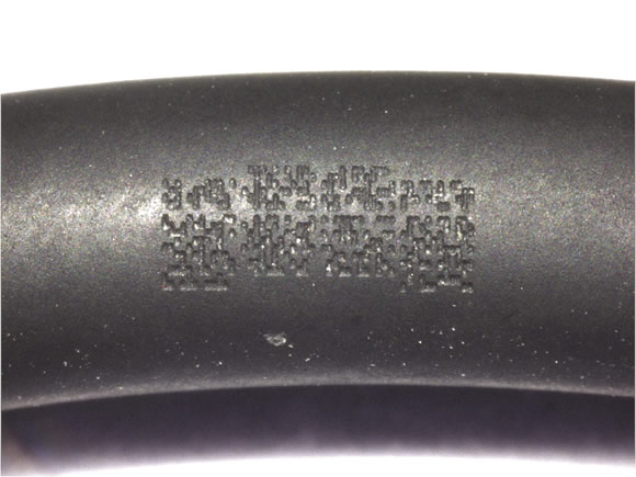

A unique engraving process is used internally by the sealing technologies unit of the Freudenberg Group, Weinheim, Germany, a supplier of dynamic and static seals, gaskets and other elastomeric components. When a customer in the food service industry discovered that non-Freudenberg counterfeit parts had been used in its equipment, the customer asked Freudenberg for a solution to protect its equipment against counterfeiting and ensure component traceability.
Freudenberg developed a laser engraving process incorporating a 24-digit sequence that can be directly applied in standard rectangular fashion on flat parts or rounded for curved parts such as O-rings. “Every component using this identification system is marked with a unique number sequence,” said Christian Geubert, a technical support representative with Freudenberg.
Freudenberg%20safe%20marking%20applied%20to%20O-ring.tif
Courtesy of Freudenberg Group
Freudenberg’s “safe” marking applied to an O-ring.
The sequence can be added to over the life of the part to provide additional information. The identification does not need to take the form of a tag, which product pirates may separate from marked originals and attach to their counterfeit products, especially small parts, such as O-rings used in specialized applications.
The fine print is so small that it requires a special magnifier to read it, but the code remains legible even if up to 70 percent of the marking has been worn through or destroyed, Geubert said.
The product, trademarked under the name “safe,” was patented 3 years ago in Europe. The technology is proprietary and used only on Freudenberg products. Application costs range from approximately 0.05 Euros per part for high-volume applications up to 2 to 3 Euros per part for complex component systems in which just a few products are marked.
