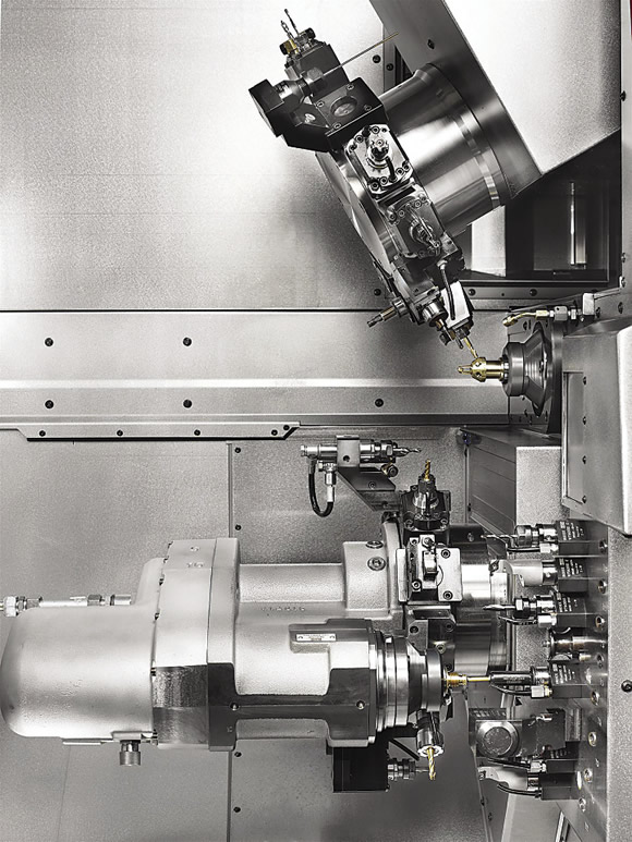

Turning a part with a Capto-equipped MULTUS B300II from Okuma. With up to 60-tools available in the magazine, 15-hp milling and B, Y and C axes, complex parts can be setup quickly and machined in one step.
While the basic CNC lathe is still a standby in many machine shops, new technology has vastly expanded turning capabilities. For example, live tooling and multiple turrets turn a basic lathe into a multitasking productivity center. When equipped with a large automatic toolchanger, these machines can hold tools for dozens of jobs, reduce setup time, and turn, mill, drill and finish parts in a single setup.
Dual-spindle turning centers can turn both ends of a part in a single setup to minimize operator handling, increase throughput and reduce work-in-process. The opposed spindles support synchronized turning and pass off parts on the fly, reducing overall cycle time. Such machines allow for the creation of more complex parts, and do so more efficiently. But questions like when are such machines needed, what kinds of parts can they produce and how do you justify the increased cost of a “supermachine” should all be taken into consideration before signing on the dotted line.

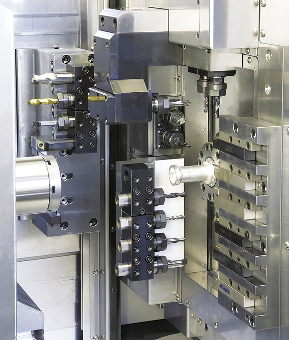

Eliminating as many operations as possible is the most important consideration for shops looking at a new machine tool, according to Courtney Ortner, chief marketing officer for Lorain, Ohio-based Absolute Machine Tools Inc. “This is why multitasking machines can be so profitable,” she said. “Parts are often ‘done in one,’ eliminating work-in-process and improving quality.”
The Nexturn CNC Turning Center features a tooling layout that minimizes noncutting time while offering expanded part capability with a single setup.
Courtesy of INDEX

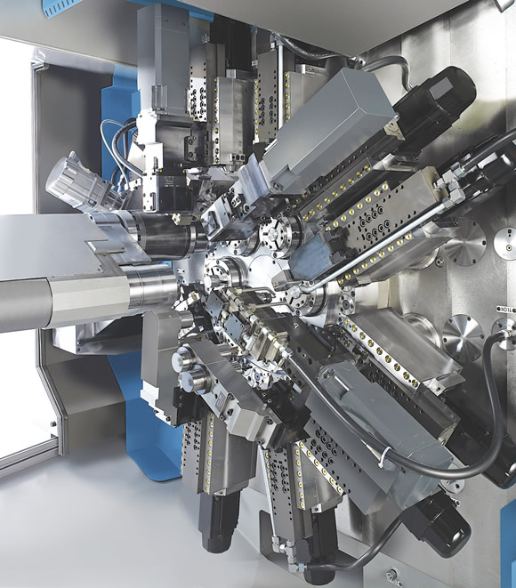

The Index MS52C offers C-axis capability and 12 independent CNC slides, making it appropriate for high-volume, complex machining.
Ortner argued that turn/mill and other multitask machines reduce setup and fixturing costs while improving employee utilization compared to single-task machines. That’s because with multiple operations, operators do non-value-added tasks, such as part handling, which removes them from the equipment they are supposed to be monitoring and increases downtime. “An idle spindle is no different than going to the front door and throwing money into the wind,” she said. “Because more machining is done per cycle, multitask machines maintain a higher percentage of spindle uptime.”

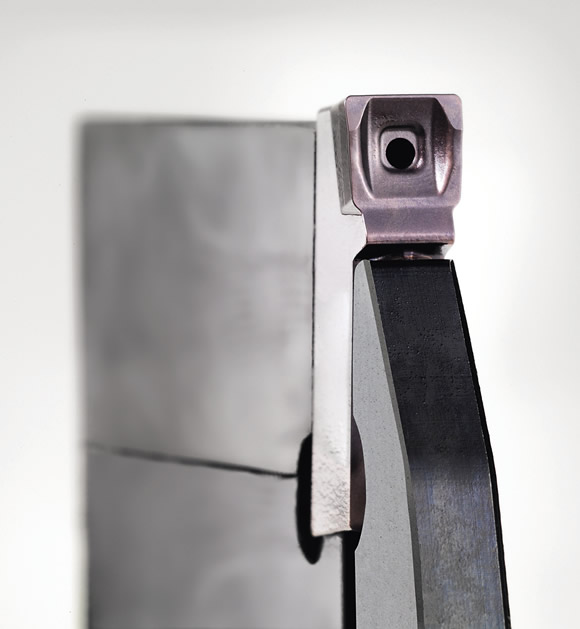

Cutting tools, toolholders and workholding are a big part of the equation for turn/mill and other multitask machines. According to Jason Farthing, technical sales and marketing at HORN USA Inc., Franklin, Tenn., the tooling that is selected must take into account the materials commonly used to make complex parts—nickel alloys, titanium and high-chromium alloys.
“We see a lot of shops moving in the multitasking direction, especially in the aerospace and medical markets,” he said. “One of the newer products available to address the difficult materials in this arena are carbide inserts that are both tough and hard. They can take a beating and resist wear at the same time. There are also several new coatings on the market that, when you get into tougher materials like Inconel or Hastelloy, offer high heat and abrasion resistance.”
Courtesy of HORN USA
HORN offers through-coolant tools that accept various grooving and cutoff inserts.
