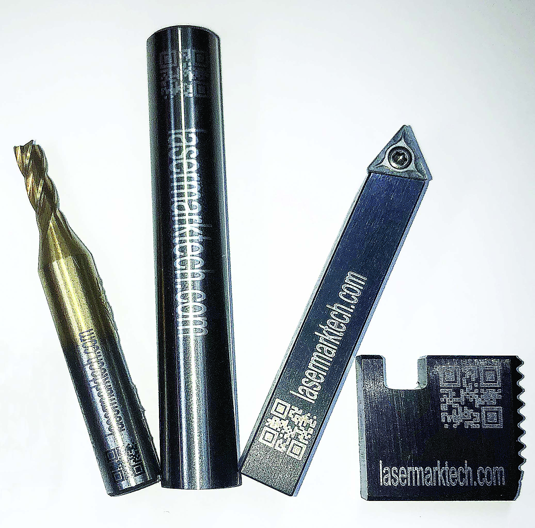

Because they don’t raise the part surface, lasers are often the first choice for marking carbide tools. Image courtesy of Laser Marking Technologies

How fast are laser markers? According to Sam Palmeter, president of engineering and new product development at equipment manufacturer Laser Marking Technologies LLC, Caro, Michigan, it’s possible to laser-mark a 1⁄4″-dia. carbide tool shank in less than two seconds with only a minute or two of setup. “Perhaps more important is that we can produce a mark without raising the part surface,” he said. “Around 14 years ago, we developed a ‘recipe’ to eliminate surface raising, which is why more than 100 cutting tool manufacturers now use our equipment. You might say we cut our teeth on carbide.”
The 1,064nm fiber laser found in Laser Marking Technologies equipment is ideally suited for carbide and other metal, he said. The laser is also much less expensive to own than previous laser generations. Maintenance is about as difficult as cleaning out a toaster, and the laser is no more challenging to operate than any other computer-controlled device.

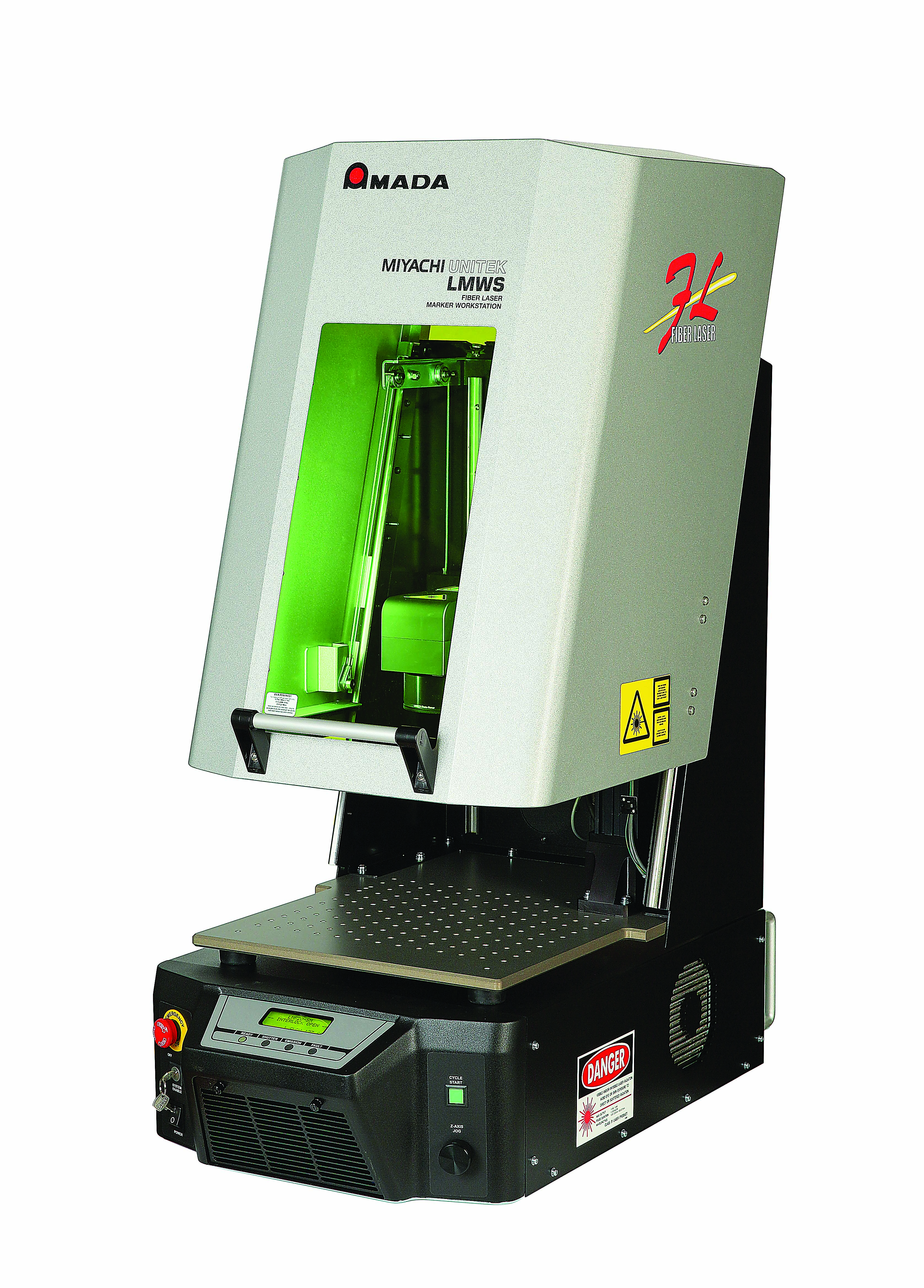

The Amada Miyachi America laser marking station is a desktop machine suitable for a range of low-volume applications. Image courtesy of Amada Miyachi America

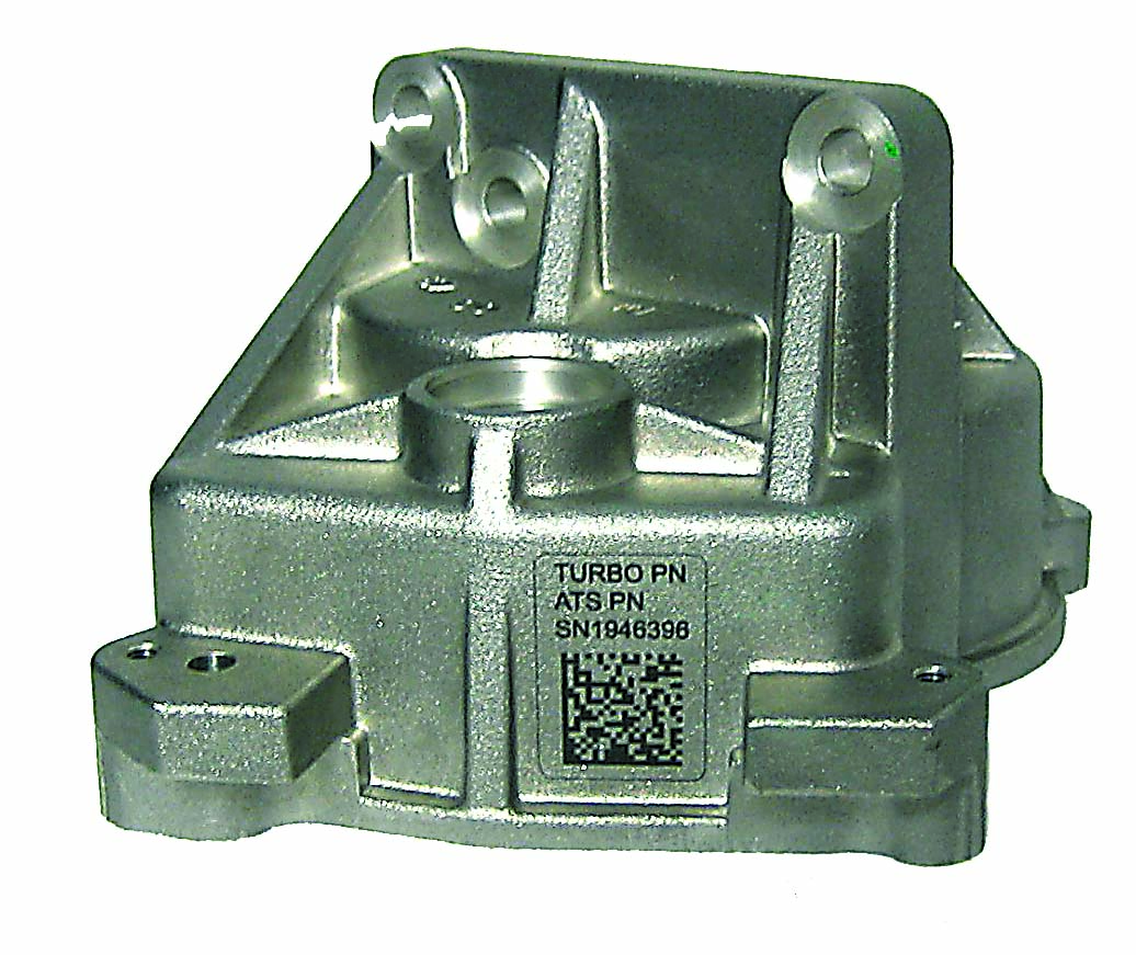

There’s more to marking than basic part identification. Bar codes, such as data matrix, QR code and PDF417, give manufacturers the ability to cram a lot of information into a relatively small area. Whereas the linear 1D bar code found on a can of green beans or box of breakfast cereal is limited to a couple of dozen characters, a 2D bar code may contain up to 2,000 characters, enough to tell a complete tale about a workpiece and its history.
Lasers make volubility fast and easy. This means that a machinist can scan the laser-marked bar code on a favorite cutting tool and know where and when it was made, who made it and how to get more. “If you use Amazon or other online retailers, you already know that you can scan a data matrix code and have the product in your hands within hours,” Palmeter said. “Laser marking gives manufacturers and their customers the ability to interact like never before.”

“Consider a brake rotor for Ford, Chrysler, whomever,” Palmeter said. “They have to make sure that the proper rotor goes onto the proper car. Otherwise there could be safety issues. The best way to do this is to laser-mark each one during production with a serialized bar code. All the assembly technician has to do is scan the car’s unique bar code, scan the rotor, and the system will record what’s happening and verify that everything’s copacetic. This type of functionality is just a small example of what’s possible with some laser marking systems.”
Mark Boyle, product manager for Monrovia, California-based Amada Miyachi America Inc., sees many such opportunities—and not only with auto companies and other large manufacturers. “Normally, our equipment is used by customers doing low-volume, high-mix work,” he said. “The list ranges from medical and dental parts to electrical connectors and even mom and pop shops that need a cost-effective and flexible way to mark machined components.”

Small shops might be wondering how to set up and operate one of these machines. Boyle said it’s easier than people may think. He explained that whether the system is integrated with another piece of equipment or is a stand-alone workstation, there’s a graphical user interface of some kind and programming software that controls the timing between the laser and the galvanometer that drives it. “Once you’ve entered the data, the rest is pretty much automatic.”
The Ins and Outs
Boyle said a variety of inputs are possible. This means that someone can import a DXF or an Adobe or a CorelDraw graphics file or just type whatever he or she wants. The software then takes care of the formatting and conversion to a data matrix, if required. At that point, all that’s needed is to tell the laser what material is being marked, load the part and push the “cycle start” button.
More advanced functions, such as automatic serial number generation and interfacing to the company’s enterprise resource planning system or machine tools, are also possible. This requires a slightly higher skill level. But for the most part, it is nothing that any talented CNC programmer can’t handle.
