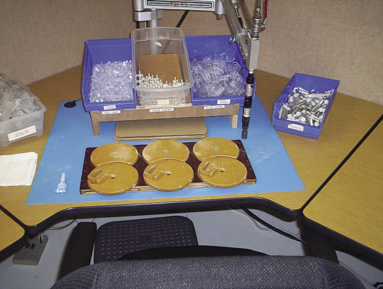

A well-organized work area, with everything needed for assembly is in its proper place and clearly identified, is a key component of 5S.

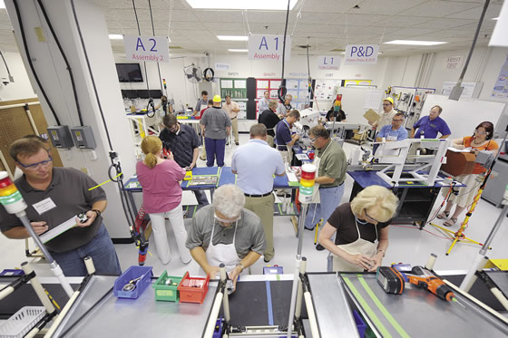

Hands-on exercises in a team environment are one of the best ways to learn lean principles.

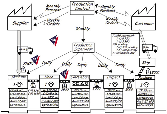

Value-stream mapping is critical to understanding the flow of information, raw material and finished products through the manufacturing process.
