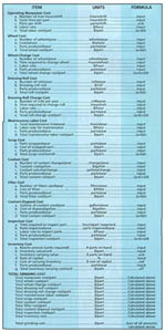

Table 1: This worksheet was designed to help end users consider all of the cost factors when comparing the performance of conventional and superabrasive wheels. (Click for larger image) |
The paper included a worksheet to help users calculate the total costs for machining or grinding with conventional and superabrasive tools and wheels (Table 1). Cost factors on the chart include the money it costs a shop to purchase wheels, dressing rolls, coolant, and coolant filters; dispose of coolant; maintain an inventory of parts in process; and pay workers to change wheels and dressing rolls, maintain equipment, and inspect parts.
