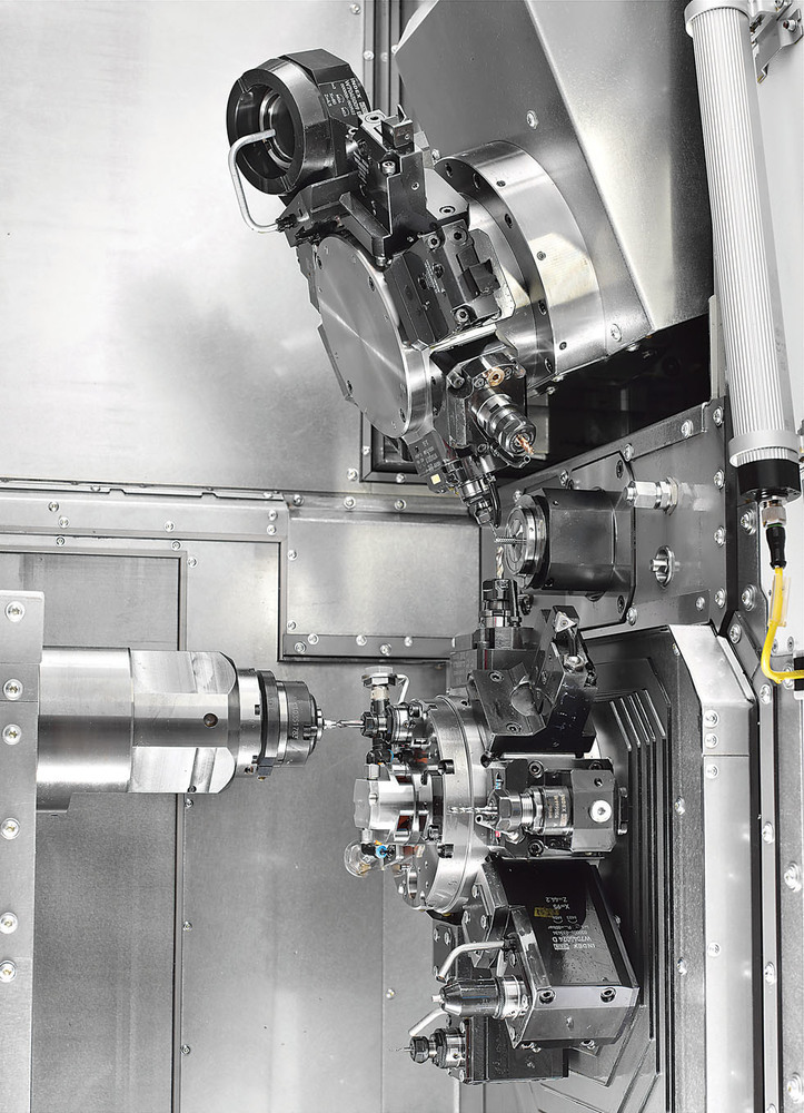

However, sometimes a guide bushing is not needed or wanted, such as when machining short parts or profiling a part that would not be efficiently turned using a guide bushing. To accommodate both scenarios, Index offers the Traub line of CNC sliding- headstock machines, models TNL12, TNL20 and TNL32, that are convertible from sliding- to fixed-headstock operation.
Image of Cincom L32 series Swiss-style machine
The Cincom L32 series Swiss-style machine can be equipped with a B-axis. Marubeni Citizen-Cincom
“If we can switch to fixed-headstock mode, we can use regular stock that’s not ground,” Economan said. “It feeds out to a fixed location.”
He added that a housing either is installed for sliding-headstock mode or removed for fixed-headstock mode, and the conversion process consumes about 10 to 15 minutes.
The medical industry is a major consumer of Swiss-style machines to produce long, skinny implants and parts for surgical devices, but any manufacturer of that small shaft-type or similar parts is an ideal candidate for such a machine, according to Economan. “But what we find is there are a lot of customers that have many of these Swiss-style machines and because they have that machining capacity, they might be making smaller parts that actually don’t require a sliding-headstock machine. The diameter of the machine is going to dictate what parts can go on that machine.”
Index reports that the TNL12 has a 13 mm (0.51″) spindle clearance, the TNL20 has a 20 mm (0.79″) spindle clearance, and the TNL32 has a 32 mm (1.26″) spindle clearance. Rather than purchasing a machine for work that a Swiss shop already has or for a dedicated process that might go away, Economan recommended targeting a more flexible and robust machine that will suit the jobs the shop wants now and down the road. “It always makes sense to have a little bit higher capacity machine than what you need for future growth.”
Image of TNL20 Swiss-style machine
The kinematics of the Traub TNL20 Swiss-style machine allows effective and simultaneous machining with two or three tools. Index

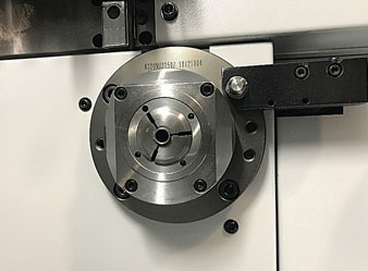

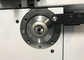

Marubeni Citizen-Cincom Inc. is another builder of Swiss-type, or sliding-headstock, CNC automatic lathes that can be used with or without the easily mounted and removed guide bushing. Ray Navarro, service and application manager for the Allendale, New Jersey- based builder, estimates that after a little practice an end user will changeover a machine in about 10 minutes. In addition, a setting must be switched in the machine structure page to change the stroke of the headstock. “The machine is so smart that once you flick that switch, the parameters and numbers change by themselves.
He explained that after the guide bushing is removed, the Cincom machine still has a sliding headstock. Without a guide bushing, the Swiss-style machine is used like a conventional lathe for machining short remnants up to 50.8 mm (2″) without the need for pricey ground bar stock. “Without the guide bushing, you’re not moving the part at all, so the part is always in one chuck, and you will turn and mill everything in one step.”
In contrast, Navarro noted that the guide bushing allows for machining parts longer than 152.4 mm (6″) using ground stock as long as users segment the part into sections. “If you attempt to do it one shot, you’re going to fall out of the guide bushing. You don’t have support. That’s the biggest thing here.”

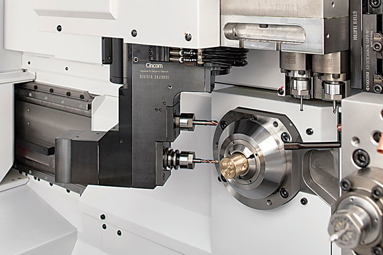

Automation continues to make inroads into an array of machining tasks to enhance productivity while helping to overcome the ever-present skills gap, but Swiss-style machines have long been automated with the use of a bar feeder, Navarro said. “On the loader, depending on the size of the bar, you can put multiple 12-ft. bars, and that machine can be run alone the whole day, even the whole night lights out. That’s actually automated. Just put a bar in and you get a part fully finished.”
An automatic toolchanger is also a type of automation and the Cincom Model L20E-3M12B5 has the “smallest ATC machine in the world,” according to Navarro. “We have a sliding headstock machine but we integrated an automatic tool change so you have a carousel with 12 tools that you can put there and act like a milling machine.”

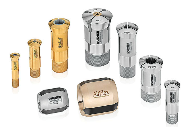

When it comes to supplying tooling for Swiss-style machining applications, such as guide bushings, live tools and various collets, Platinum Tooling Technologies Inc. is well established. The supplier of precision machine tool accessories added to its line of Swiss tools last year with the introduction of Dunner guide bushings, said Preben Hansen, owner of the Prospect Heights, Illinois, company. Dunner AG has produced guide bushings at its factory in Moutier, Switzerland, since 1935.
After visiting Dunner and examining its guide bushings, Hansen said the offering was a good match for Platinum Tooling and decided to move forward. “It looked like something not everybody and their brother sells. It’s a unique product, there’s not a lot of competition and it is high-end, which I like because everything we sell is high-end.”
The bushing inserts are made of either bronze, Titane/Meehanite- aged cast iron or NewSurf ceramic. The choice of guide bushing material depends on the workpiece material, Hansen explained. Although most bushings are made of carbide, which Platinum Tooling offers in its Technicrafts line, some materials can rub off on the carbide and become scored, such as titanium, nickel-base superalloys and platinum. Because cast iron is relatively soft, it will not negatively impact a workpiece and “works for everything,” but wears quickly. He added that ceramic, the hardest of the three, lasts the longest.
Swiss shops that machine different metals typically have guide bushings made of different materials, he noted.
In addition, the Dunner guide bushings offer three levels of precision: standard accuracy of 15 μm (0.00059″) or less, ultraprecision accuracy of 5 μm (0.00020″) or less and ultimate ultraprecision accuracy of 2 μm (0.00008″). Hansen said the standard and ultraprecision are the most popular, with more customers gravitating toward ultraprecision.
He added that only a select number of customers, such as those making high-end medical parts or mission-critical aerospace components, are in the market for ultimate accuracy. “It’s expensive, it takes a long time to get it, but if you want it, you want it. Where there is no room for error, it doesn’t matter what it costs.”
To prevent contamination from chips and coolant getting pushed into the guide bushing, Hansen recommended using some silicone sealant. Otherwise, contamination can score the material or prevent proper clamping. Nonetheless, sealant is optional and may not be necessary for some applications.
Image of Platinum Tooling machines
A selection of Dunner guide bushings from Platinum Tooling. Platinum Tooling Technologies
The ceramic bushing is only available in a round profile, but square and hex profiles are frequently requested, and customs can be ordered, Hansen said. “We can do pretty much any shape that fits within the space of that collet.”
Generally, ground bar stock is not needed when Swiss-style machining a non-round profile, he noted.
Image of Marubeni Citizen-Cincom Swiss-style machine
A Marubeni Citizen-Cincom Swiss-style machine with a guide bushing (top) and without one. Marubeni Citizen-Cincom:

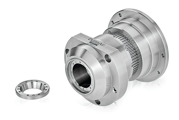

Another way to eliminate the need for ground bar stock is the DunnAir adaptive guide bushing (AGB) system, which replaces the original guide bushing supplied by the machine tool builder, Dunner reports. A non-ground bar might not be consistent in size from one end to the other, and a conventional rigid bushing might bind the bar or allow it to flop around if it’s too loose, Hansen said, adding that the AGB system accounts for up to a 0.508 mm (0.020″) difference in the diameter. “The system allows for great flexibility in the size of the material and compensates for material fluctuations.”
The programmable CNC system can also clamp down on a bar, so it does not move, he said. Nonetheless, it’s not for every Swiss-style customer. “An adaptive guide bushing system is a very specialized product for pretty special applications.”
When the system is suitable, the payback can be quick, Hansen added. “Moving to unground stock can more than pay for the DunnAir system in less than a year.”
Marubeni Citizen-Cincom also offers an adaptive guide bushing that is used in place of standard guide bushing units and can utilize non-ground material, Navarro noted. Its AGB uses a “double taper” bushing, which will always close parallel, the company reports. In addition, constant air pressure is applied, which allows the bushing to compensate for bar deviations up to 0.203 mm (0.008″) in diameter. The air pressure setting is variable and can be changed as required for each specific job.
A major advantage is eliminating variations in guide bushing adjustment from operator to operator. Once the AGB is set, no adjustment is needed until the user changes to a different bar diameter. The problem of machining gummy materials, such as stainless steel, will also be improved.

Image of DunnAir adaptive guide bushing system
The DunnAir adaptive guide bushing system is designed to replace the original guide bushing supplied by the machine builder. Platinum Tooling Technologies
