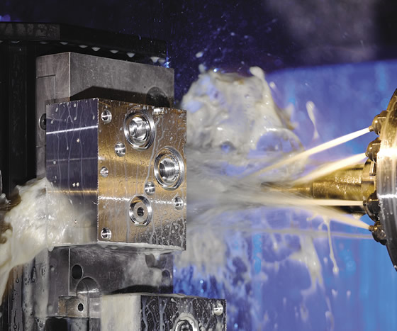

Whether they are extremely hard and brittle, resistant to heat or unusually gummy, some materials are more difficult to machine than others. When machining these stubborn metals, applying the proper cutting fluid becomes more important than ever. Many metalworking fluids are up to the task, including neat mineral oils, synthetic oils, a blend of the two (typically called semisynthetics), ester-based oils, water-based fluids and vegetable-oil fluids.
Their main purpose is to reduce heat, either by carrying it away from the tool/workpiece interface, reducing the friction inherent to the process, clearing heat-laden chips or some combination of the three. Two of the primary methods for applying fluid are via a high-pressure stream through the tool, essentially injecting the coolant directly into the cut while cooling the tool inside and out, or by flooding the entire workpiece to quench the heat through sheer liquid volume.
Cimcool%20titanium.tif
Courtesy of Cimcool Fluid Technology
Cimcool’s CIMTECH 320Z synthetic fluid is approved for aerospace applications and is shown being used on a titanium part.

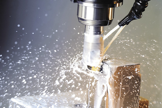

Semisynthetic fluids like Chemetall’s Tech Cool 35048BF combine cooling and lubricity.
Additive packages can vary from manufacturer to manufacturer; some of these additives function by introducing chemicals whose physical properties change as the temperature rises to create a protective layer between the tool and workpiece. The additive layer lowers the cutting force and improves the surface finish by reducing friction, and the EP additives create a precise area of controlled oxidation to render the material easier to machine, according to Hank Limper, market development manager for Houghton International Inc., Valley Forge, Pa.
When cutting steel with a chlorine-fortified coolant, he explained, the coolant transforms the iron into iron chloride at the precise point of the cut. And when machining aluminum with phosphorous present in the coolant, the result is aluminum phosfide. “Because this reaction is so controlled and localized, the workpiece itself is not grossly altered from a metallurgical viewpoint, but the metal right at the point of contact with the tool is transformed into something easier to machine,” Limper said.
hocut_795_I.tif
Courtesy of Houghton International
Flood coolant quenches the heat of machining operations by applying high volumes of fluid, such as this Hocut 795 series coolant from Houghton International.

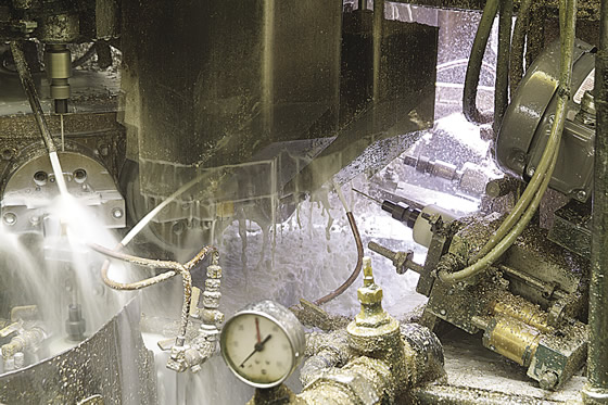

How coolant is applied is another significant variable, but while flood is the standard approach to most machining jobs, high-pressure, through-tool coolant has become much more common and is frequently utilized in today’s manufacturing environments.
“It seems to me that everybody is running high pressure, especially since the cost has come down on these units in the last 10 years,” said Blaser Swisslube’s Reynolds. “Frankly, it’s pretty rare to see a machining center sold without a high-pressure coolant system.”
Chemetall%2035052CF.tif
Courtesy of Chemetall
Chemetall’s Tech Cool 35052CF is a chlorine-free cutting fluid for resilient materials.
The idea behind high-pressure coolant, he continued, is that in addition to providing cooling and lubricity, the fluid creates a hydraulic wedge between the cutting tool and the chip, helping to break and separate the chip from the workpiece and blast it out of the way.

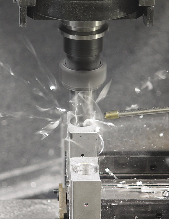

An aluminum drilling operation with a Unist MQL applicator shown on the right.
Unist’s system delivers a neat oil which is aerosolized directly onto the workpiece/cutting tool interface, typically used with a second nozzle using high-pressure air to clear chips, which carry much of the heat with them. Because there is no excess fluid, there’s no reservoir, sump, fluid recycling, rancidity issues or health hazards. The entire “waste disposal” process consists of dropping the empty jug in the shop’s recycling bin, Walker said.
Even on difficult machining jobs, MQL can be effective, especially when combined with multilayer coated tools—the specific coating will vary based on the materials and cutting parameters, he said, but TiA1N often works well. When cutting hard materials, the lubricant and the coating work together to create a lubricious layer between tool and workpiece, Walker explained, reducing heat by lowering friction, without the mess typically associated with large amounts of coolant. That same lubricious layer helps when machining gummy materials, he continued, because the barrier on the tool prevents built-up edge.
“Typically, if you’re going to apply MQL externally, you’ll want a relatively low air pressure, enough to aerosolize the oil and get it to the tool, but not too much, which would blast it really hard. The latter will create a mist of lubricant in your workshop and that’s unpleasant for everyone,” he explained. “However, in deeper drilling applications when the tool is buried inside the workpiece, you can actually go high-pressure, through-tool MQL. You’re putting in the same amount of oil, you’re using the high-pressure air to blast the chips back out, and you’re not worried about creating a mist of oil because the tip is inside the work.”
