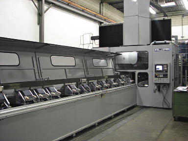

For example, flexibility is one critical requirement for a machine Bertsche Engineering Corp. is currently building. The Buffalo Grove, Ill., company builds custom machines, primarily for the aerospace industry, as well as standard metalcutting and high-pressure water and mechanical deburring machines. According to Richard Bertsche, company president, the customer wanted a lot of flexibility to machine various small to large workpieces on the same machine.
Bertsche designed the machine, which can be run as a single or dual work cell, with six 40 “×20 “×20 ” work cubes. “They will have a machine in excess of 240 “,” he said. “When they run it as a single work cell, they’ll have big worktables in there. They will be reconfiguring the worktables daily.”
That will allow the parts manufacturer to support its other production requirements by having one machine that can morph into the machine that’s needed. Bertsche Engineering enabled that by customizing a standard machine with reconfigurable worktables and “sophisticated” workholding devices. “We designed that functionality into the machine, and we really had to wait for a customer with a work environment and a machining need that required that functionality,” Bertsche said.

Courtesy of Bertsche Engineering
A custom metalcutting machine tool from Bertsche Engineering.

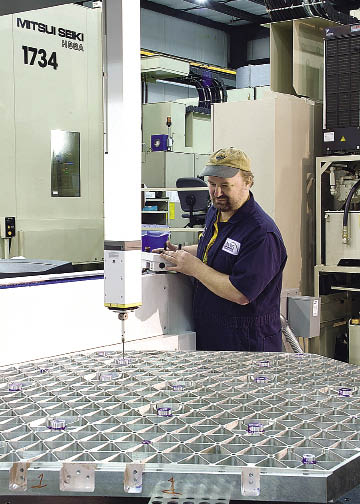

Mitsui Seiki sold eight machines for the JWST project and 18 lenses were required to make the telescope’s aperture. Each workpiece weighs about 700 lbs. and ends up as a 25-lb. lens after 6,600 hours of machining time. “Typically, these kinds of machines are designed for 75,000 hours of operational use,” Walker said, “and 75,000 hours is three shifts a day, 7 days a week for 12 years. That’s your straight depreciation schedule so you can fully depreciate the machine over the life of its application.”
That means after producing the lenses, plenty of machine life remained. “They’re making other types of components but the customer who purchased them is still using the machines,” Walker noted, meaning even application-specific specials offer flexibility.
Looking for Something Special
Courtesy of Mitsui Seiki
A coordinate measuring machine is on Axsys Technologies’ shop floor to check the mirrors for the James Webb Space Telescope during and after processing.

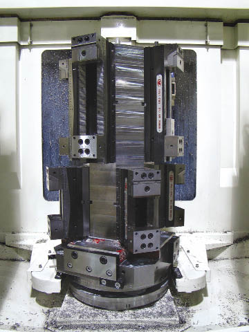

MTT-21 designed special fixtures for Schultes’ Kitamura Mycenter-HX400iF HMC (top) to provide appropriate spacing between the manually operated vises and enable adequate clearances for the array of tools applied (bottom).

Delivering a customized machine to Schultes Precision Manufacturing presented a different challenge. The job shop needed a machining process where twice as many 6061 aluminum hydraulic manifolds could be loaded onto a pallet than previously without going to a large machine—and it was needed fast. “We needed the machine in 8 weeks because we had to deliver parts to a customer,” said Alex Patent of Schultes Precision Manufacturing, Buffalo Grove, Ill.
MTT-21 provided a quote in about a week for a Kitamura Mycenter-HX400iF HMC rather than a bigger machine, such as a Mycenter-HX630i, which costs more and has a CAT 50 spindle taper instead, whereas the smaller machine accepts CAT 40 toolholders. That meant Schultes wouldn’t have to purchase new toolholders. “When MTT-21 said they can do it on an HX400iF, I was like OK, I don’t know how they’re going to do it but I’ll be happy to see it,” Patent said.
“We designed and manufactured special fixturing to accommodate more parts on the pallet without creating any interferences and preserving the ability to machine three sides on every part on the pallet,” said Mark T. Ulanov of MTT-21. The workpieces are held with vises on a pallet-mounted tombstone, and Schultes is able to complete four workpieces per pallet, or eight pieces per cycle.
In addition, MTT-21 equipped the machine with a Renishaw spindle probe for registering workpiece location, a Renishaw laser-based tool breakage detection system for tool monitoring and a 1,000-psi coolant-through-the-spindle system to provide adequate chip evacuation, especially when applying long port tools. Because parts are loaded by hand and their locations can vary, for example by 0.050 “, the machine probes each part and sends offsets to the control. “The machine now knows exactly where the part is located,” Patent said.
When the machine was scheduled for delivery, Patent said it arrived already setup and joined the shop’s 14 other Kitamura machines.
