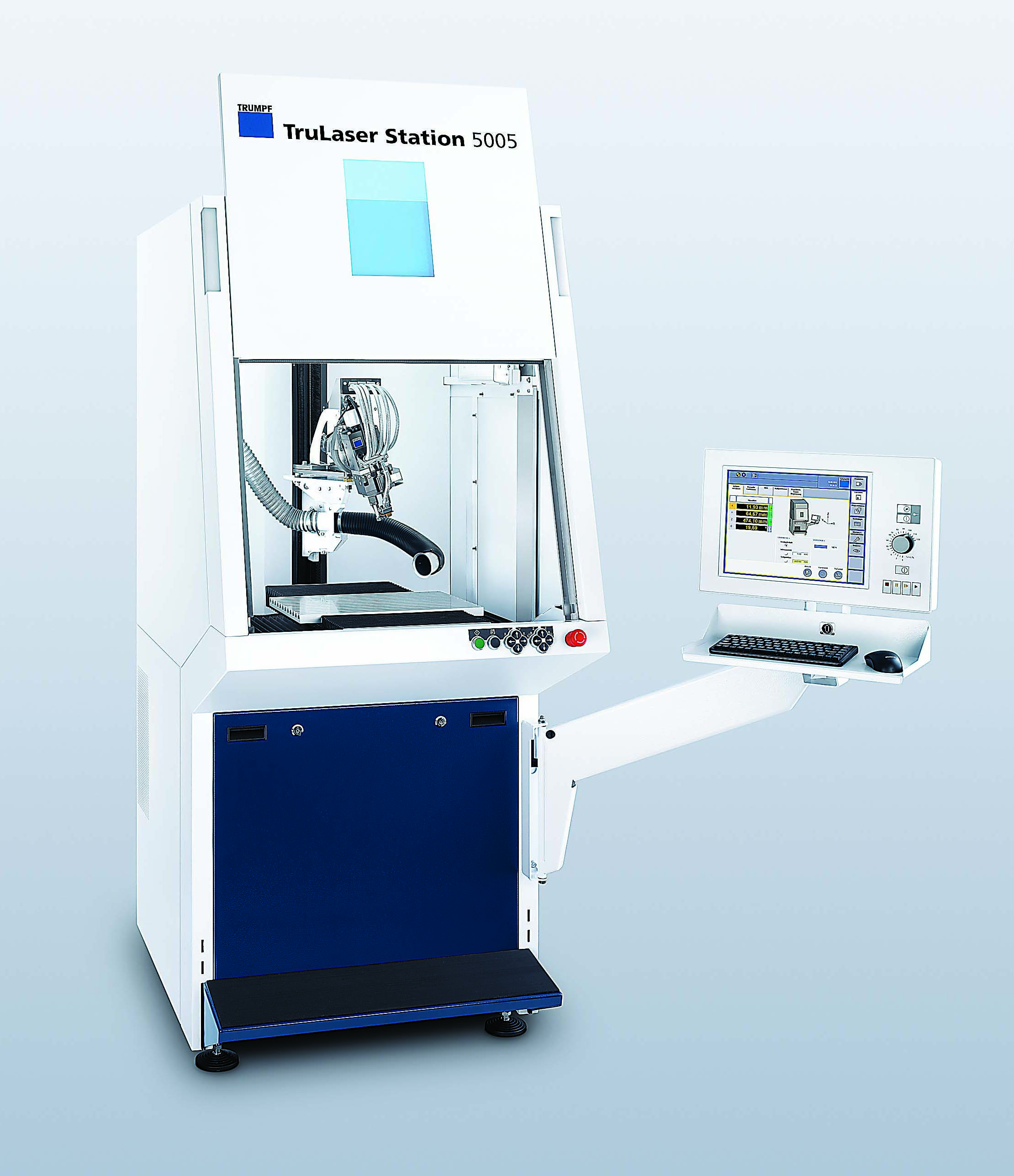

Ironically, these extremely brief but energetic blasts are supplied by a laser with roughly the power of a microwave oven—only 750w for Trumpf’s Model 7050 laser, with some models putting out little more than a good-sized light bulb would. According to Cook, this short pulse, low-power approach is more effective than using a continuous-wave, high-power laser, such as the 4kW and greater versions found in Trumpf’s line of industrial laser cutters.
The TruLaser Station 5005 is an economical 3-D workstation suitable for cleaning small parts. Image courtesy of Trumpf.
“Because of the peak power that’s applied during laser cleaning, the material is vaporized very quickly and consistently.” Cook said, noting there’s no risk to the substrate as there would be with a cutting laser. He added that a smaller laser also means a lower investment and reduced energy consumption. “Because there’s no need for chemicals, abrasives and other consumables, as with alternative cleaning methods, the total cost of ownership is much lower as well, without having to deal with OSHA and EPA regulations.”

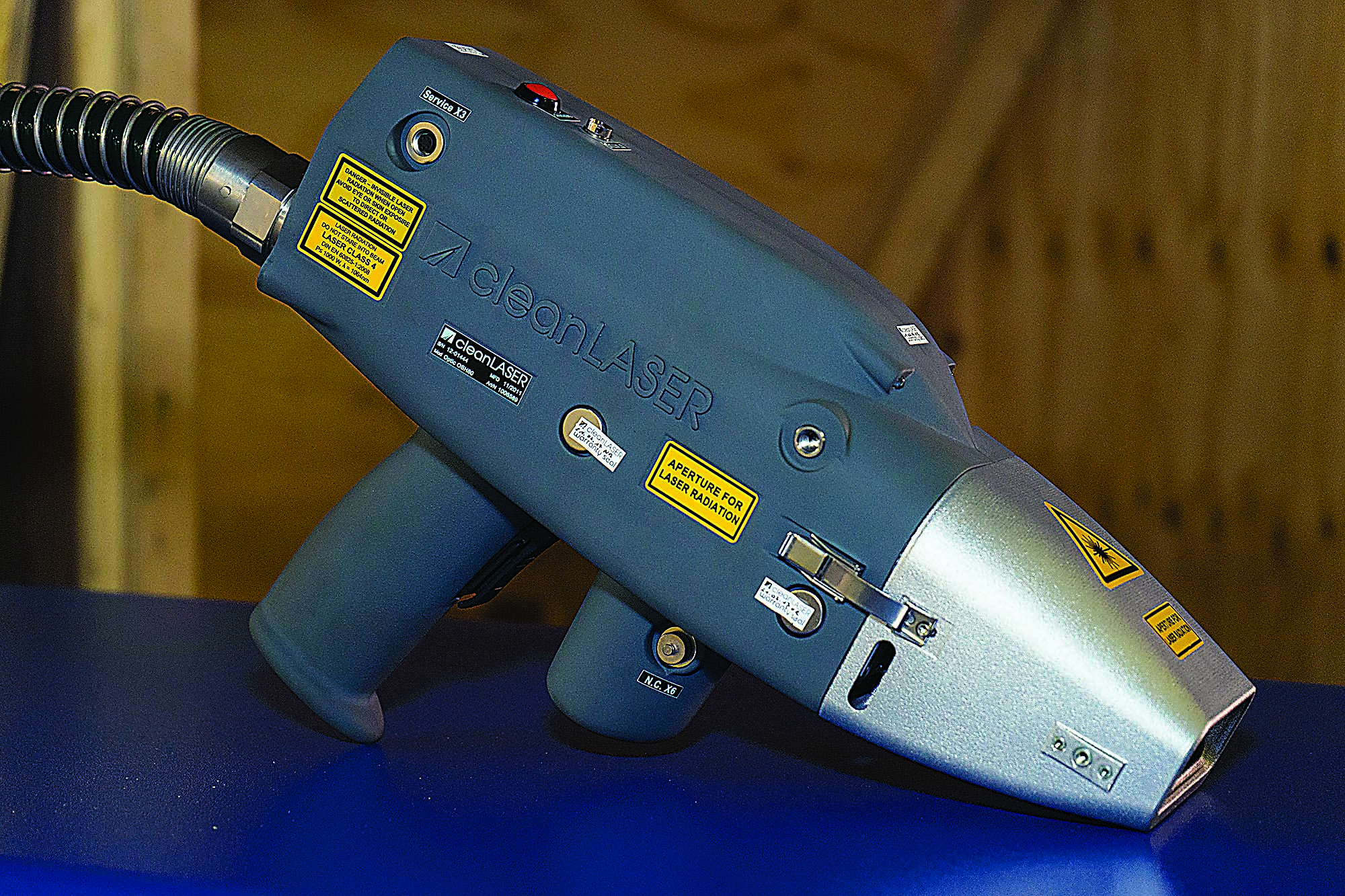

Nick Davidson, business development director at Adapt Laser Systems LLC, Kansas City, Mo., said laser cleaning is popular with automotive and aerospace customers but also suitable for cleaning injection molds.
This hand-held optic has an integrated vacuum channel for drawing hazardous fumes away from the work area. Image courtesy of Adapt Laser Systems.
Despite the apparent gentleness of these devices, most are Class IV lasers. Appropriate safety measures must be taken to avoid eye and skin damage to nearby workers. This is especially true when one considers that many systems are hand-held.An untrained operator could inadvertently activate the device on a co-worker, causing serious harm. As such, anyone near a laser must wear infrared-rated eyewear, andshielding should be in place around the work area. In addition, suitable clothing should be worn to avoid the “sunburn” or skin blistering that might occur in the case of direct contact with laser light.
Davidson said the risk level goes down because the power of a cleaning laser is lower than other industrial lasers, but the consequences of improper use do not. Adapt Laser Systems incorporates safety training into every laser sale.

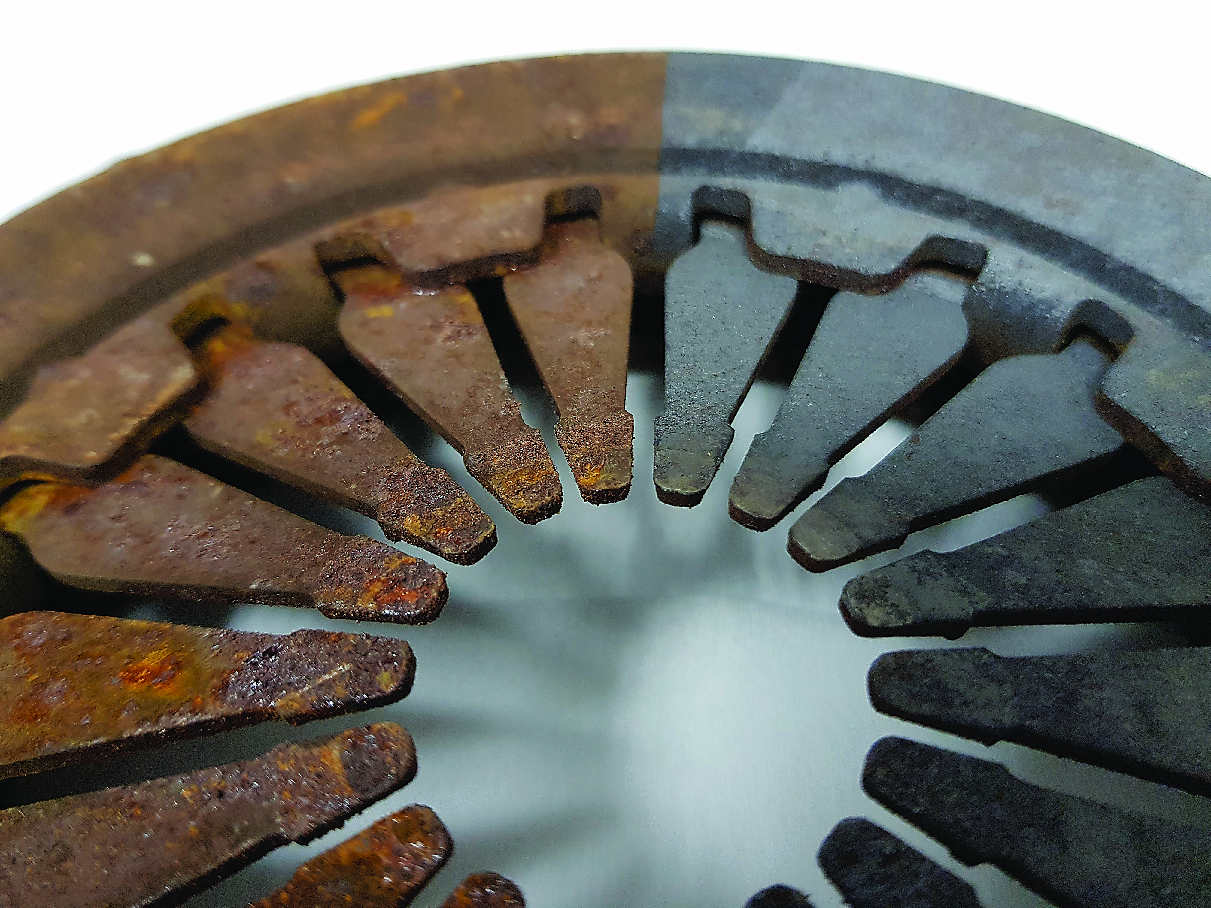

Laser cleaning equipment comes dear. A basic hand-held device sells for roughly $80,000, while an automated system can run up to $250,000 or more—possibly a lot more.

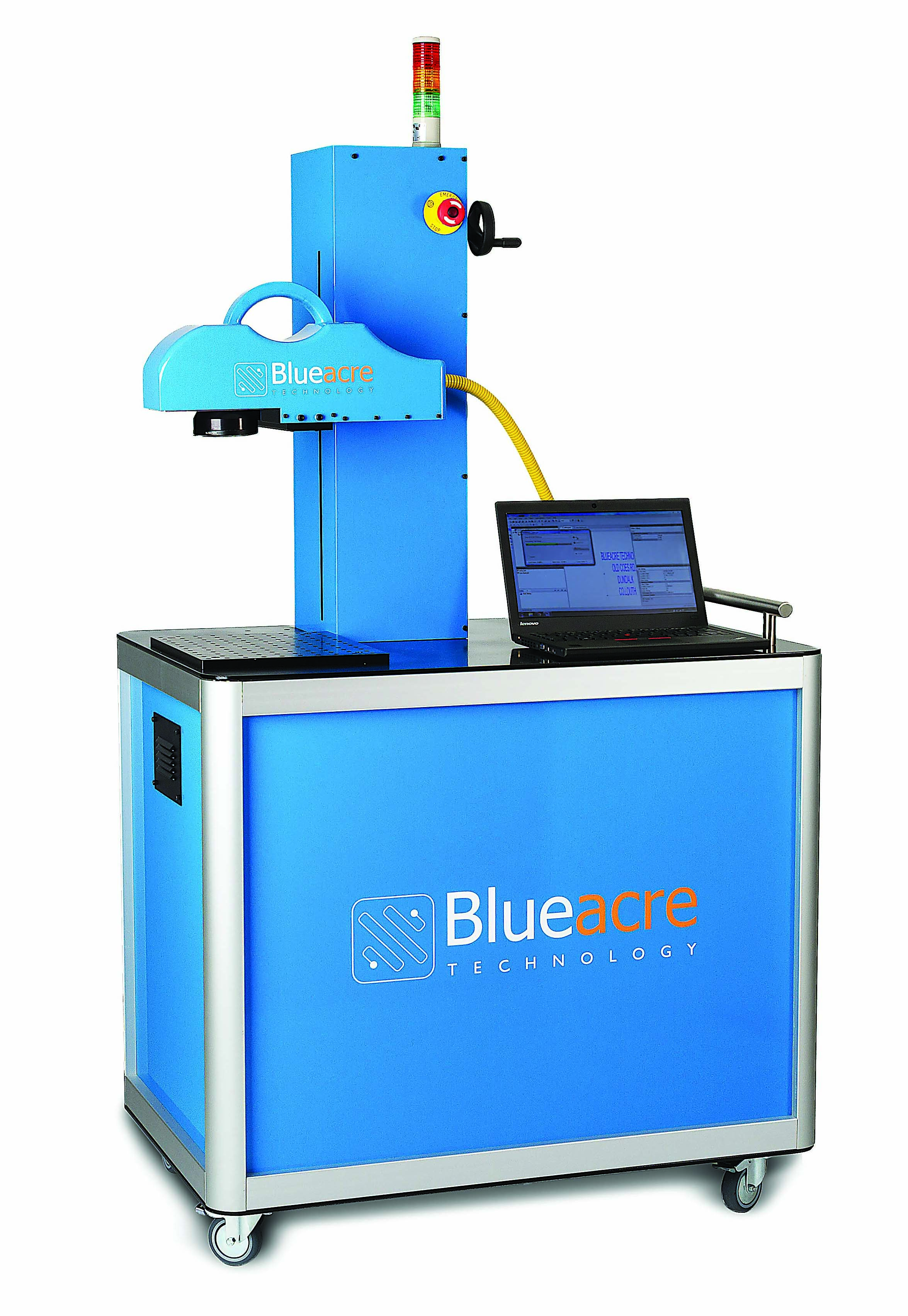

According to Dr. David Gillen, CEO of Blueacre Technology Ltd., Dundalk, Ireland, this investment makes laser cleaners especially well-suited to customers with a dedicated, high-volume application where the laser can be automated for around-the-clock use or to companies that have a variety of smaller jobs where a mobile laser can take the place of conventional chemical and abrasive cleaning.
A before-and-after view of a laser-cleaned surface. Image courtesy of Blueacre Technology.
“There are trade-offs,” he said. “The investment is certainly much higher with a laser, but you can’t equate it to a bead blaster. Fiber-based lasers are solid-state devices, so you can easily see 200,000 hours of usage before anything goes wrong. Compare that to the ongoing costs for abrasive media or the cleanup and environmental concerns with chemical cleaners. Ultimately, the total cost of ownership comes out about the same but with much less hassle. Just point and click the laser, and you’re cleaning whatever it’s aimed at.”
Like others in this industry, Blueacre provides systems integration with its cleaning lasers, whether that’s attaching one to the end of a robotic arm or surrounding it with a gantry-style motion control platform. Blueacre does not yet sell its products in the U.S., but Gillen has received numerous inquiries and is actively seeking a qualified distributor.

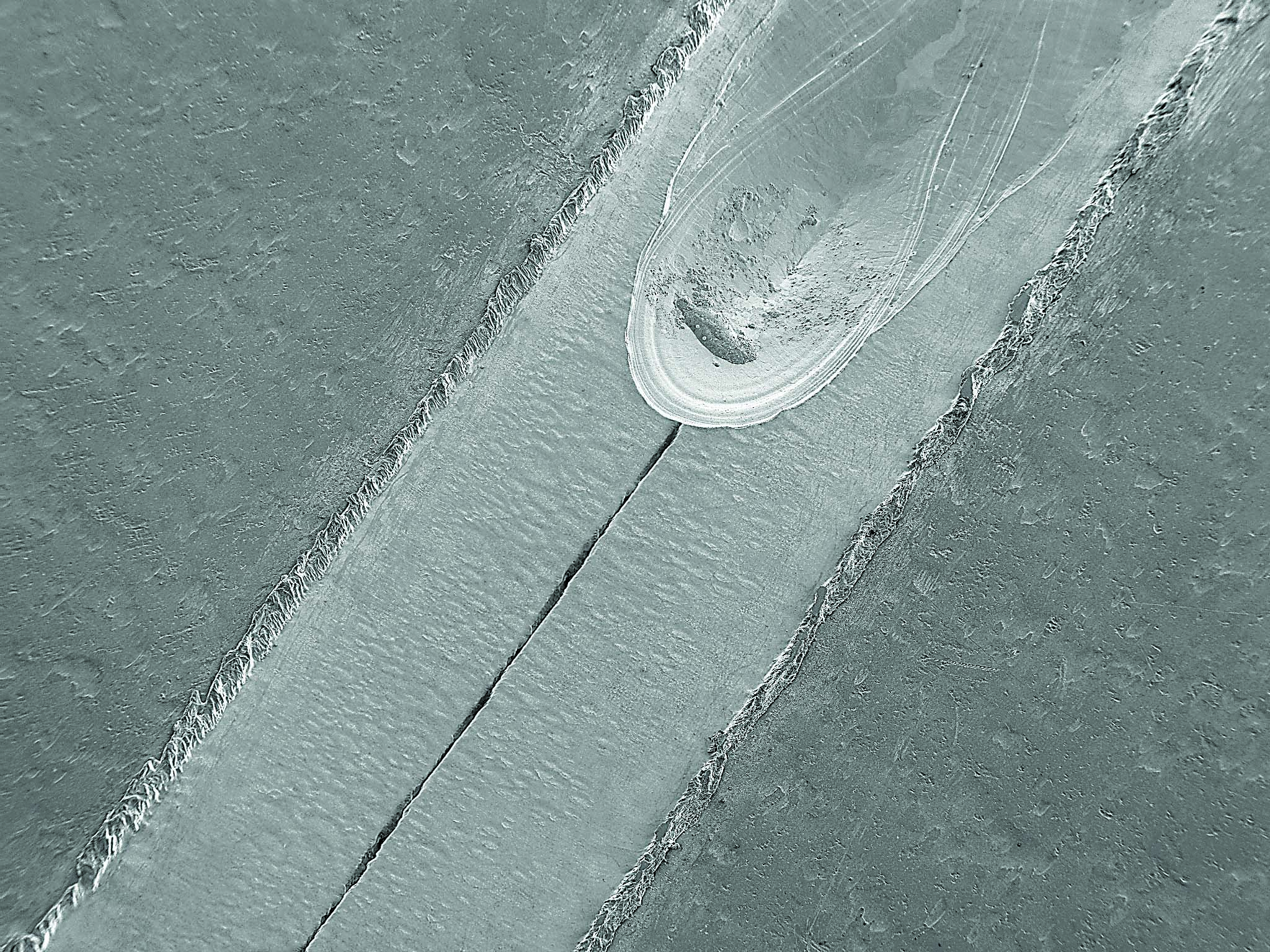

One company working in the U.S. and internationally is IPG Photonics Co., Oxford, Mass. Bill Shiner, vice president of industrial products, said lasers are often used to prepare tailored blanks for the auto industry (semifinished components made of different types and thicknesses of steel that are welded together, then sent to secondary stamping) or for drawing operations (door modules and side members, for example).
Some Blueacre models can be operated manually or with an integrated motion control. Image courtesy of Blueacre Technology.
“There’s a very durable, hot-dipped coating on each of the pieces that must be removed before welding,” Shiner said. “However, the engineers don’t want to ablate the surface down to the base metal. Instead, they want to leave a thin interface layer to prevent corrosion and eliminate any porosity in the weld.”
Shiner said it’s a delicate application from the standpoint that the operator needs good beam control. The ablation layer must be uniform across the entire target surface to avoid reaching the base metal in one area before properly cleaning the adjacent surfaces.
