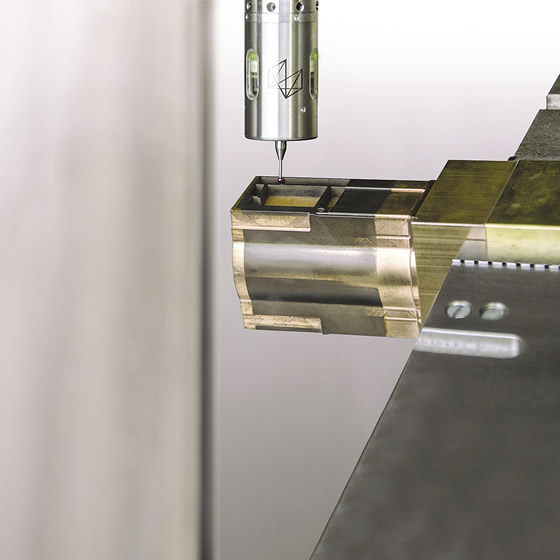

Hexagon_mh40.50.tif
Courtesy of Hexagon Metrology
Using a CAD model, the mh40.50 from Hexagon Metrology can inspect macroscale features and those nearly invisible to the naked eye.

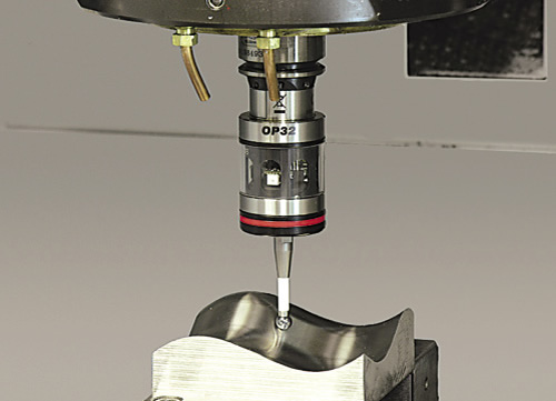

Marposs_OP32_2.tif
Courtesy of Marposs
Touch probes, such as Marposs’ OP32 optical transmission probe, help automate machine tools, from setup to on-machine measurement after machining.
“In the past, the primary limitation with machine probes was the CNC software driving them,” he said. “Probes could measure basic things like diameter or length, but they weren’t smart enough to do any sort of detailed dimensional analyses.”
This intelligence allows shops to measure a part, compare it to a CAD model and send real-time corrections to the machine’s CNC. Carried to its logical extreme, a new breed of self-optimizing machine tools may be on the horizon. This isn’t the prelude to some science fiction movie. Johnson said this level of intelligence is available today, giving manufacturers the potential for a cost-effective, closed-loop system able to measure features that would previously have been relegated to the inspection room.
“This is far more than a probe,” Johnson said. “It provides the ability to sense the state of the workpiece and make automatic adjustments to the machining process. Historically, you would try to control this process by inference. If you were machining titanium knee implants, for example, you would try to monitor factors such as tool wear and machine expansion by measuring three or four datum points, then using that information for process control. But if you can understand the real-time geometry of the workpiece by using a probe that’s controlled by smart software, you can catch the end effect of process errors and make adjustments accordingly.”

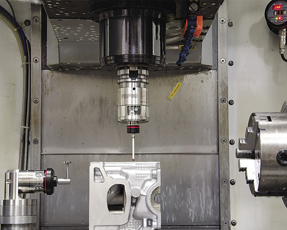

Marposs_VOP_VOTS.tif
Courtesy of Marposs
Touch probes, such as Marposs’ Mida VOP, help automate machine tools, from setup to on-machine measurement after machining.

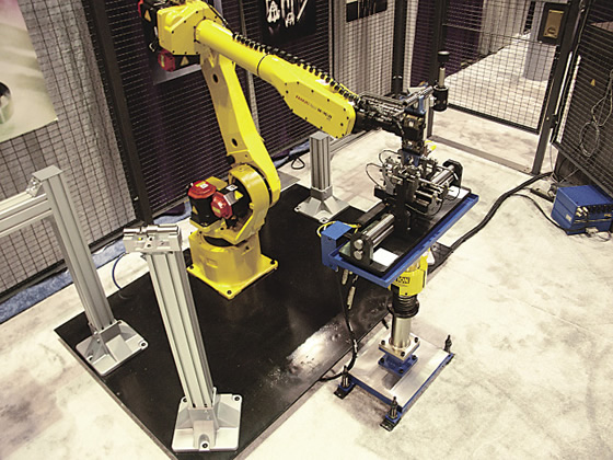

Marposs_autoload_overall_oblique.tif
Courtesy of Marposs
A robot loading a machined shaft into a floor-mounted gage. A break-away device protects the gage in case of misalignment.

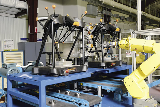

Renishaw_Conroe_bearing_cell_with_Equator_and_robot%203%20(hi-res).tif
Courtesy of Renishaw
A single robot tends a set of conveyors, loading and unloading workpieces on a pair of Equator measuring machines from Renishaw.
“The Equator is an alternative gaging system for the shop floor,” Chang said. “The fundamental difference between it and a coordinate measuring machine is that the Equator relies on a master part with known dimensions.” The benefit is that if the temperature on the shop floor is a sweltering 90° F (32.2° C) and humid like a Louisiana bayou, a quick calibration against that same master part will bring the machine into harmony with the harsh environment. “We don’t have to rely on any sort of thermal effect compensation for accurate measurement on the shop floor,” he said.
Cool stuff, but what does any of that have to do with inline QC integration? Chang explained that the Equator can also be integrated into an automated machine cell. “Depending on how the system is configured, closed-loop integration is possible. The software can look at what part is loaded and begin the correct gaging program. If something is out of tolerance, the software will send the appropriate corrections to the machine, too.”
If you can talk to one machine, you can talk to a crowd. Chang suggested that a single Equator might play umpire for a machining cell filled with mills and lathes, each running different parts and operations. This isn’t full-blown inspection, though. It should be looked at as process control because inline gaging typically inspects one or two critical features on any given part. Still, a few basic dimensional checks can speak volumes about the overall workpiece. These measurements, coupled with intelligent software, can send feedback to a robot or to a programmable logic controller and help control the machining process.

Stopping at the gage station
What do you do when in-machine measurement isn’t possible, but inspection is still required?
Marposs Product Manager Frank Powell said inline inspection is still a viable option. “For shops with automated cells running many different operations, you need to make sure that everything’s under control. For this reason, gage stations are often incorporated into the machining process.”
Gage stations typically contain an array of measuring devices, Powell explained. A robot or part-handling system carries the part to the station and the gages go into action, checking critical features and feeding the results to the machine tool. Of course, a CMM could be added to the machining cell, but, as Powell pointed out, fast cycle times might outpace the speed at which a CMM can measure parts.
Also, dedicated gaging tables cost less than a CMM. Powell has seen systems priced as low as $20,000, about half the price of a basic automated CMM.
“It depends on your operation,” Powell said. “If you need super-high flexibility for low-volume, high-mix work, a CMM might make more sense. But even with lot sizes of a few hundred pieces, integrated gaging tables can be very practical.”
