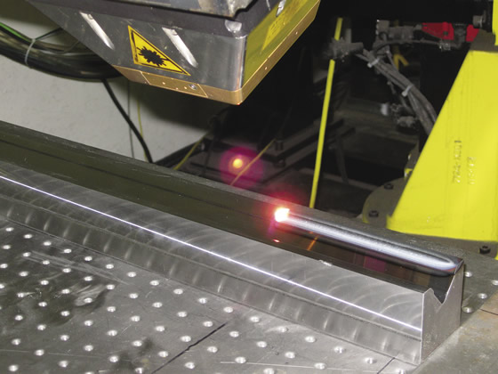

Laser hardening works by heating the metal fast enough to defeat conduction cooling as the beam passes over the surface.
The hardening is achieved through rapid cooling, he continued, which occurs when the heated portion is quickly quenched. This changes the molecular structure of the material. If the workpiece is not quenched, the outer surface will temper, or become more ductile.

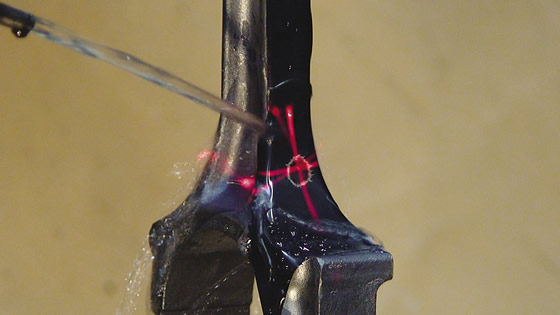

Laser peening uses pulsed light to create explosions on a part surface (right), deriving its benefit by driving residual compressive stresses deeper into the material than is possible with shot peening. Water (left) is applied to the treatment area in order to increase the shock pressure developed by the explosion.

Laser hardening also uses thermal principles to achieve the desired surface hardness, but the process differs greatly from conventional heat treating. For one, a laser is extremely localized—only the area covered by the beam is affected—and the process relies not on increasing the carbon content, but on changing the crystalline structure in metals from ferrite to much-harder martensite.
“The advantage of laser is that you can harden exactly where you want, and you can control the energy output so that you can achieve exactly the case that you need for a given application,” said John Haake, president and founder of Titanova Inc. “That gives you the greatest possible control over distortion of any surface-hardening method. With any heat-treating process, there is always distortion, but when using lasers, not only are you achieving the lowest amount of distortion possible, but that distortion will come out the same on every part in a batch, meaning you can factor in the distortion when designing a part.”
The St. Charles, Mo.-based company uses high-power diode lasers, both direct and fiber-coupled, to heat treat parts. The laser heats the surface of the metal so quickly that it defeats conduction cooling, Haake explained. “If we’re working with carbon steel, what happens is we heat the metal faster than it can cool until you reach the austenitic temperature. So, the beam raises the surface temperature to around 1,800° F, and when the beam passes over the area, conduction cooling is suddenly able to take effect, which quenches the area.”
Lasers can also handle cases as shallow as 0.010 ” (0.254mm) and as deep as 0.100 ” (2.54mm) and work on complex geometries; rather than creating a new induction coil for each new shape, the operator simply reprograms the machine. However, the precision of lasers can be a double-edged sword due to a condition called back temper.
“Let’s say you’re heat treating a rod,” Haake said. “With induction, you could just pass the whole part through a coil and it will harden the entire surface, but a laser beam has a finite width, which means you’ll need to spiral down the length of the rod, creating multiple paths. When that happens, you wind up back tempering a small width of the most recent path of the spiral, where the two paths overlap.”

While both laser hardening and laser peening use high-energy lasers, that’s where the similarity ends. Laser peening is a mechanical process similar to shot peening, but instead of impacting the surface with physical media, it utilizes pulses of light that produce small explosions on the part surface, which in turn create shockwaves that leave residual compressive stresses up to 10 times deeper than those left by shot peening. According to Stan Bovid, senior metallurgical engineer for Dublin, Ohio-based LSP Technologies Inc., surface hardening is actually a side benefit. The primary goal is creating deep, compressive stresses in the part, which increase its fatigue life.
“Laser peening makes the material more damage-tolerant than shot peening, because the shockwave penetrates much deeper than any kind of direct surface contact,” Bovid said. “Virtually any metallic material will benefit from the residual stress profile following laser peening, and the residual stress profile is really what determines most part life improvements. Materials that don’t workharden well may not see an improvement in surface hardness, but still benefit in terms of overall functional life.”
