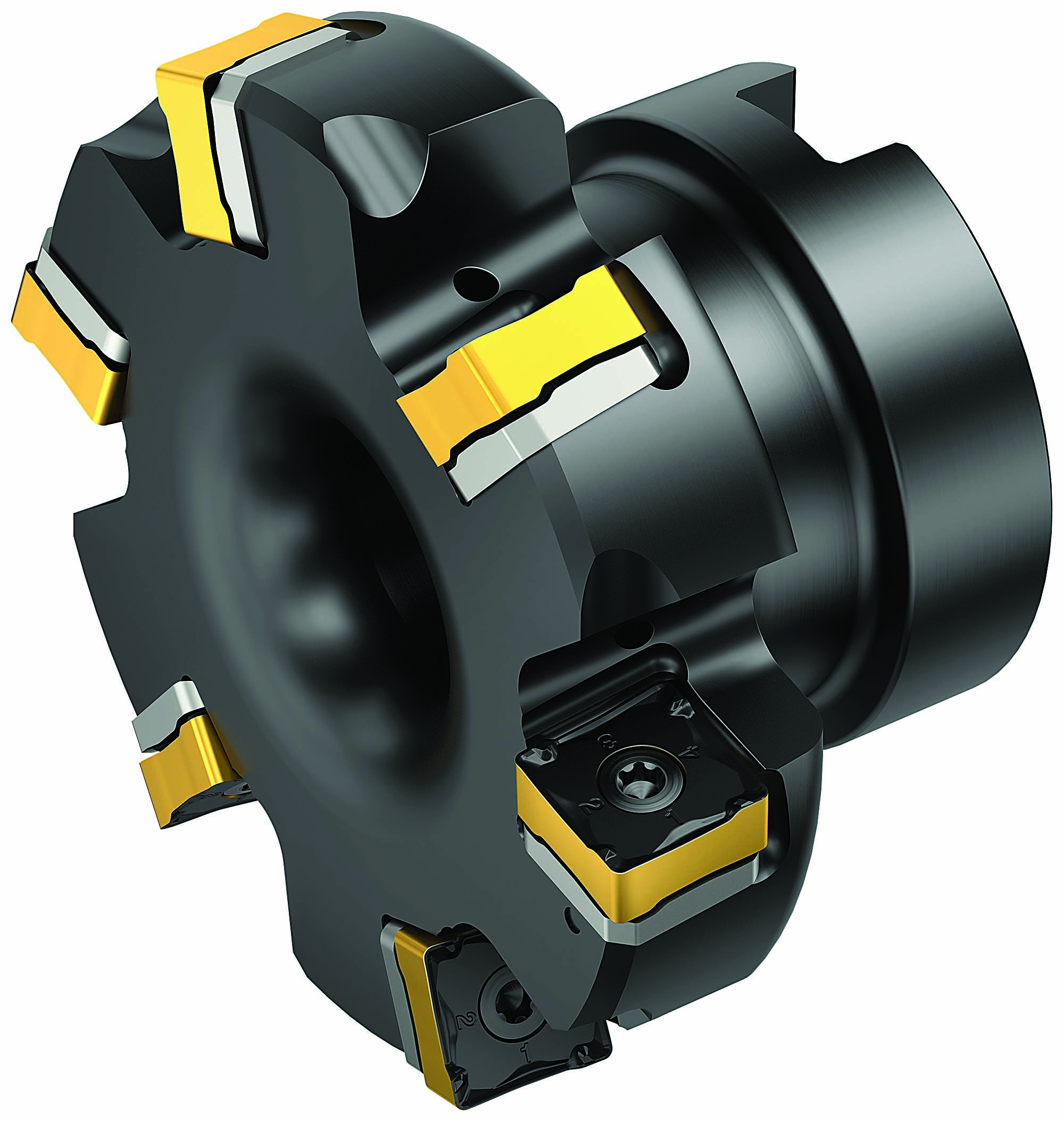

A number of shoulder milling tooling inserts are on the market designed for a nearly 90-degree milling angle. These inserts generally have eight edges ― four on the front and four on the back to simultaneously produce the shoulder and plane ― or six in some cases. However, Sandvik Coromant Co.’s tooling specialists thought that there was room for a new shoulder milling concept that brings tool life, productivity and economic benefits to customers.
The result is CoroMill MF80, which is designed for automotive milling applications in ISO K and ISO P materials. The inserts have eight cutting edges, chip protection and optimized microgeometry for better security and chip evacuation, as well as a wiper edge for superior surface finish. The cutting edge is inclined for smooth cutting action and low cutting forces, making the insert ideal for thin-walled components and machine setups with limited stability. Based on a technology platform similar to the existing CoroMill 345, this new milling concept offers a 40% lighter cutter body with shim protection and a high number of inserts for secure, stable machining, even in vibration-prone overhang
applications.
The 89.5-degree approach angle enables the multi-edge cutter to work close to the fixture while machining. The nearly 90-degree angle also reduces axial forces for improved milling on thin-walled components and weak fixtures without vibration and chatter. This not only improves accuracy and machine utilization but ensures longer tool life with less scrap.

CoroMill MF80 is designed for automotive milling applications in ISO K and ISO P materials.
CoroMill MF80 is designed for automotive milling applications in ISO K and ISO P materials. Image courtesy of Sandvik Cormorant
