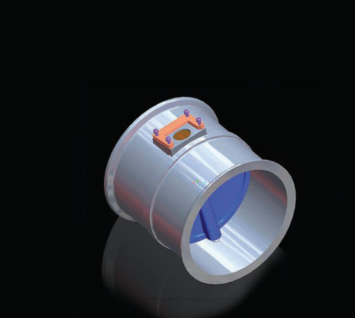

This new air-duct butterfly-valve assembly, designed with DFM software tools, is manufactured from round aluminum stock with a near-net diameter and has a seal design with wide tolerances, reasonable surface finishes and an angled seating arrangement. These features allow for an easier insertion process than was used in the original valve.

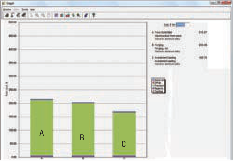

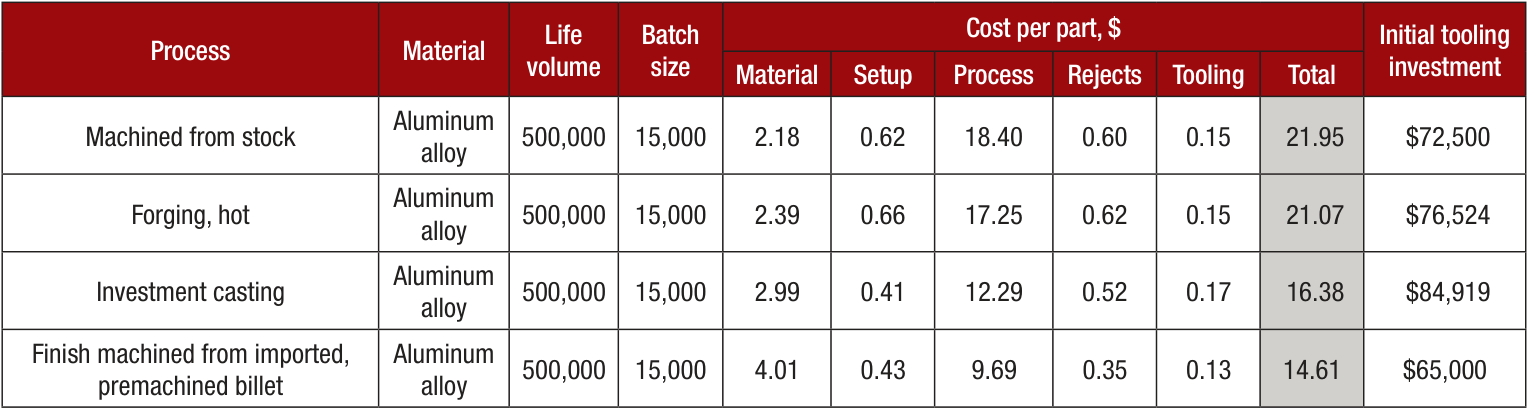

A recent case study by Boothroyd Dewhurst stated machine shop Aztalan Engineering Inc., Lake Mills, Wis., saved 25 percent when producing 8 ” Torpedo-brand carpenter’s levels (see Figure 1 above, CAD rendering and photo above, and chart below). DFMA analyzed the customer’s CAD models for opportunities to improve part design, ultimately leading to more competitive prices and greater machinability. DFMA also plays an integral part of engineering design review at Aztalan, as well as procurement and process control. “It’s central to a lot of what we do,” said General Manager Jim Hale.
A 2011 report by Boothroyd Dewhurst about aerospace supplier ITT Aerospace Controls Inc., Valencia, Calif., outlines how DFMA revamped a 30-year-old air-exchange valve design. By reducing the number of components, simplifying the assembly process and creating a valve body design that could be machined in a single operation, ITT Aerospace reduced costs 76 percent.

This bar chart generated with DFM Concurrent Costing software compares what it would cost to manufacture the level by machining (A), forging (B) and investment casting (C). The investment casting would reduce costs by 25 percent. Aztalan and its customer have continued exploring cost reductions for the level, moving from an investment casting to a premachined extrusion or a premachined forging.
