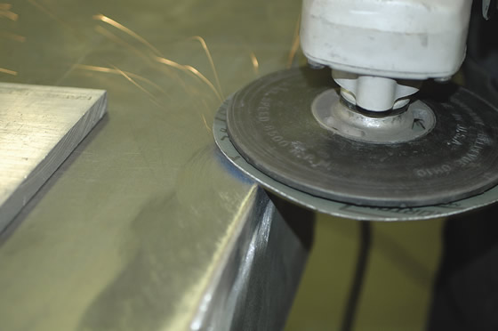

If you don’t have a blade welder or you run out of silver solder, you can tungsten-insert-gas weld bandsaw blades with silicon-bronze rod. The weld is annealed a second time after grinding to remove brittleness along the heat-affected zone. Be sure to accurately line up the blade spine or it will make clicking noises as it runs through the guides.
After you weld, silver solder or otherwise connect the two stray ends of a bandsaw blade, remove the weld buildup and level the seam. Use a curved surface to expose the weld area to your grinding or other preferred abrasion operation. After grinding, peen the weld area on a flat dolly to level the seam so blade thickness is correct.
