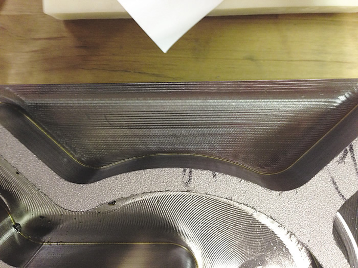

Aerospace suppliers were perhaps the first to recognize the need for more-efficient machining processes. By optimizing stock removal and reducing the amount of power required to machine airfoils and other large surfaces, they realized significant energy savings. That optimization came in the form of radically new toolpaths, ones that remove relatively small amounts of material per pass but at much higher feed rates, while maintaining consistent cutter loads to prevent chatter and tool damage.
One of these is straight-line peel milling. It is defined as any toolpath that has a small radial DOC and large axial DOC that travels in a straight line along the inner or outer part of the workpiece. As with all types of peel milling, substantial increases in the feed rate and cutting speed are possible because of chip thinning, the formation of thick-to-thin chips that occurs while climb milling and taking light radial cuts. This reduces heat generation and cutting forces.

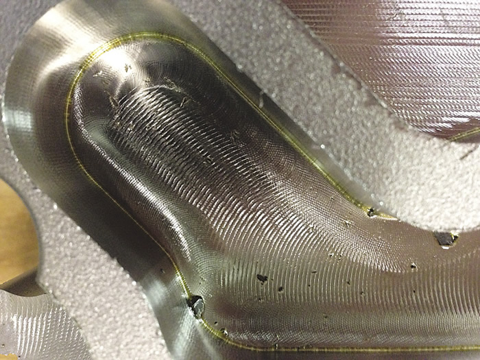

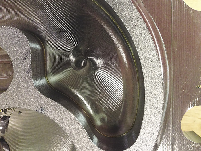

The center of this pocket shows where helical ramping stops and curvilinear spiral peel milling takes over. As the cutter moves into the narrow passage, trochoidal milling begins.
Another is trochoidal peel milling, a type of circular milling that includes simultaneous forward movements. The cutter follows a spiral toolpath to repeatedly remove “slices” of material. Trochoidal, a 2D toolpath, is also used in slot and pocket milling, where space for chip evacuation is limited. In addition, trochoidal peel milling is suitable for cleaning internal part corners, “picking” away at the material left by large roughing cutters.
Curvilinear spiral peel milling, also known as a morphing spiral, is yet another. It is a 2D spiraling cutter path often used in pocket milling. The step-overs are equal as the tool spirals out to complete a part feature. This reduces wasteful acceleration and deceleration by minimizing sharp corners.

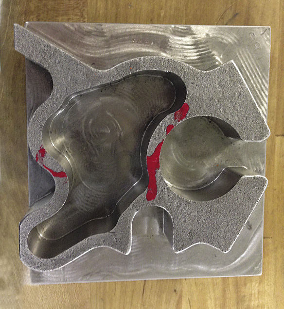

All of these MPM methods might be used in a single part program, depending largely on part geometry, chip clearance and what the CAM system determines is most appropriate for the situation.
This test part uses all of the toolpaths mentioned in the article.
