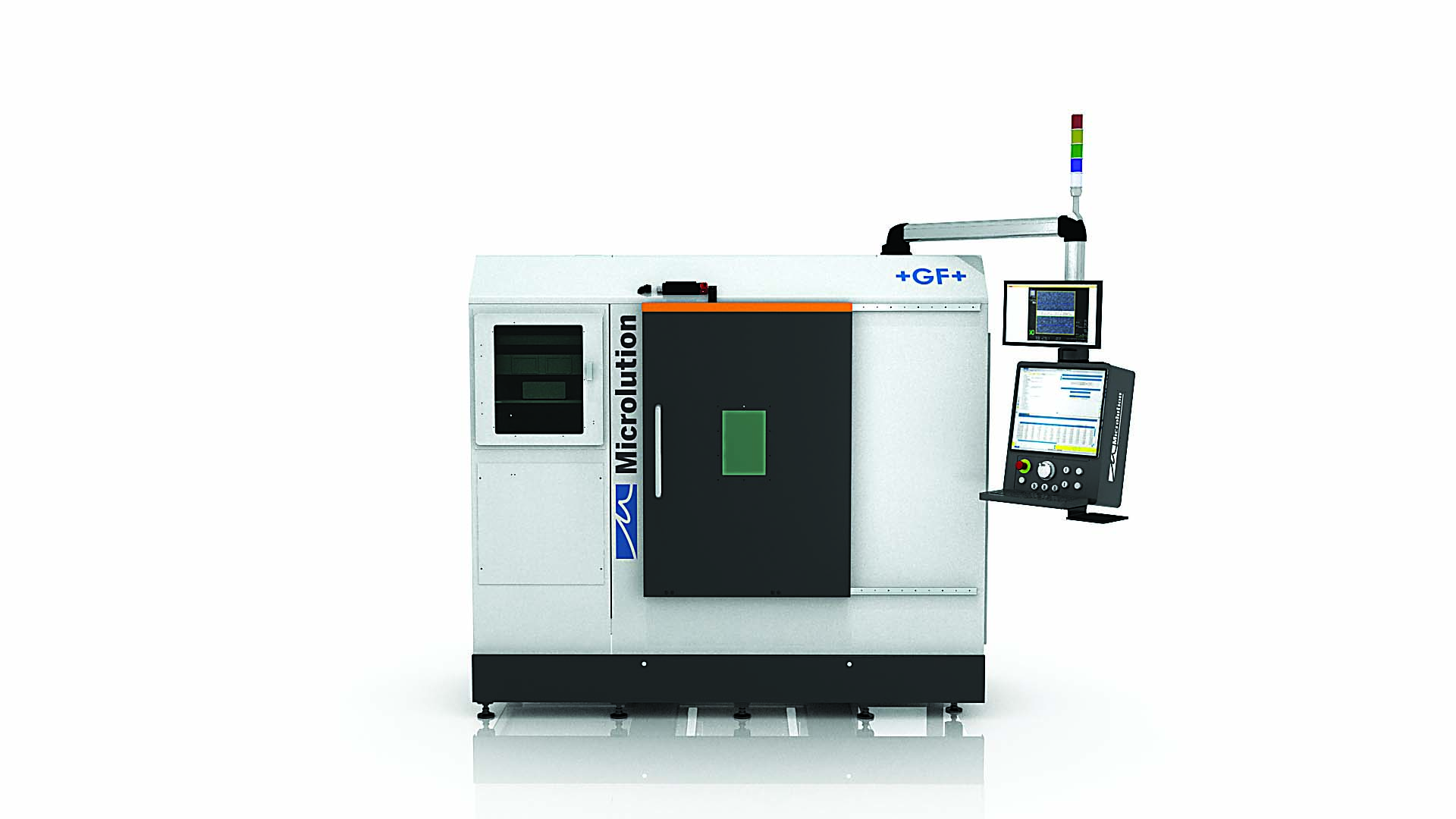

The ML-5 is a 5-axis micromachining workstation featuring an ultrafast laser. Image courtesy of GF Microlution.

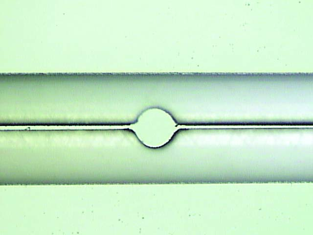

A laser drilled a 0.003″-dia. hole in this thin polyimide tubing used for a catheter. Image courtesy of Gateway Laser Services.

Microlution focuses on integrating femtosecond lasers into its micromachines, along with advanced systems for guiding the laser beam. According to Bhattacharyya, these systems can manipulate the beam in five axes of motion, allowing the creation of a variety of shapes. They also make it possible to control taper, which Bhattacharyya describes as one of the big problems with laser machining. “When we are drilling a hole, we can vary the attack angle of the beam in order to control the taper along the sidewall,” he explained. “If you want a perfectly straight wall, we can give you one.”
Microlution’s 5-axis beam-guiding technology incorporates high-precision galvanometers. A “galvo” incorporates motor-driven mirrors to direct laser light down to the work surface, explained Potomac’s Davis. Thanks to galvos, he said, laser beams can machine an entire area without relying on stage movement, increasing process throughput and repeatability.
