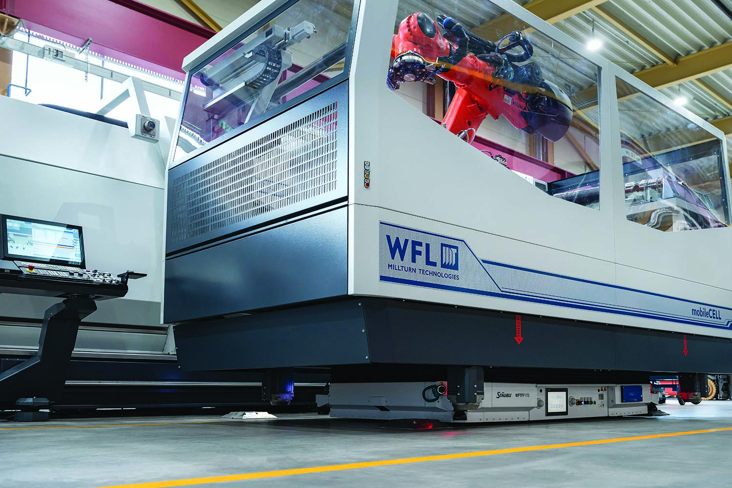

 Customers increasingly are looking for holistic solutions, such as the mobileCELL.
Customers increasingly are looking for holistic solutions, such as the mobileCELL. Image courtesy of WFL Millturn Technologies
