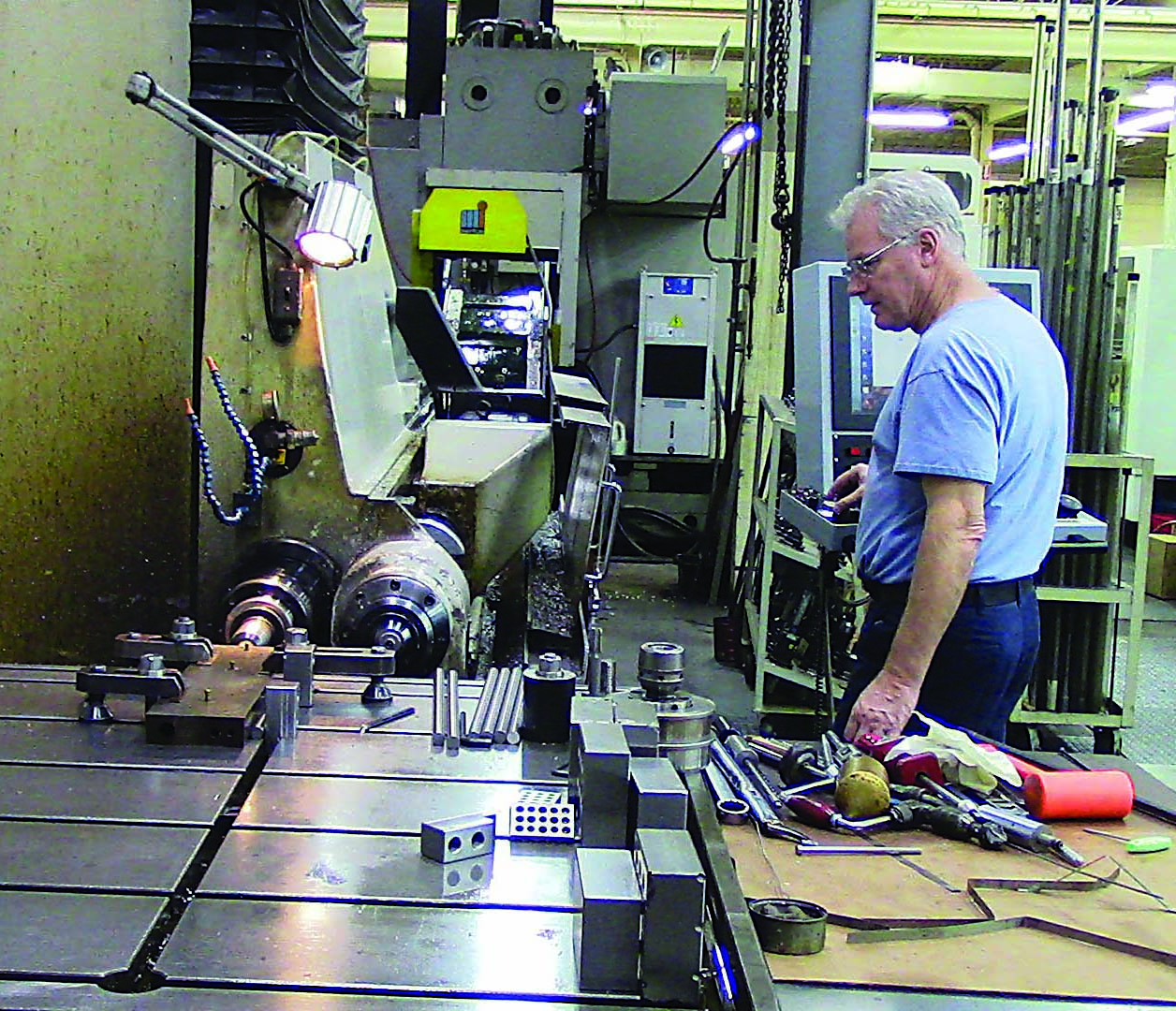

Michael Murphy performs deep-hole drilling on a Tarus gundrill. Image courtesy of Alan Richter

Although Comet doesn’t own any lathes and outsources turning to two shops, Donlin said his company does have two Tarus gundrilling machines and receives molds that require deep holes from competitors that don’t have equipment for deep-hole drilling. Because every cooling line in the molds Comet builds must be counterbored and tapped after drilling, each gundrilling machine has an auxiliary head that enables all three operations to be performed in one setup. The machines are suitable for producing holes from 4.75 mm to 50.8 mm (0.187″ to 2″) in diameter.
Moldmaker still family owned after 122 years

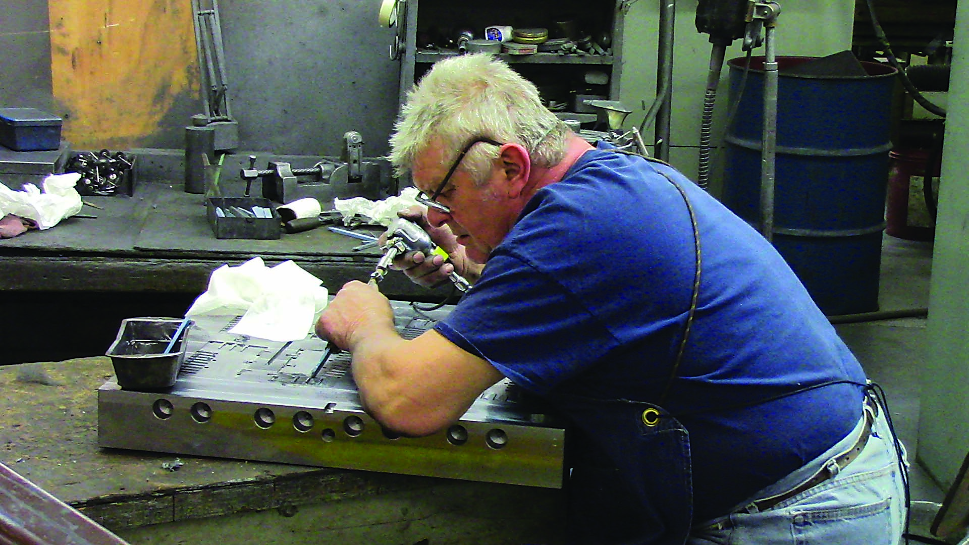

Stanley Strama polishes a mold plate. Image courtesy of Alan Richter
“I can go 80″ (2,032 mm) deep from one side,” he said. “So theoretically, I can go 160″ (4.064 mm).”
