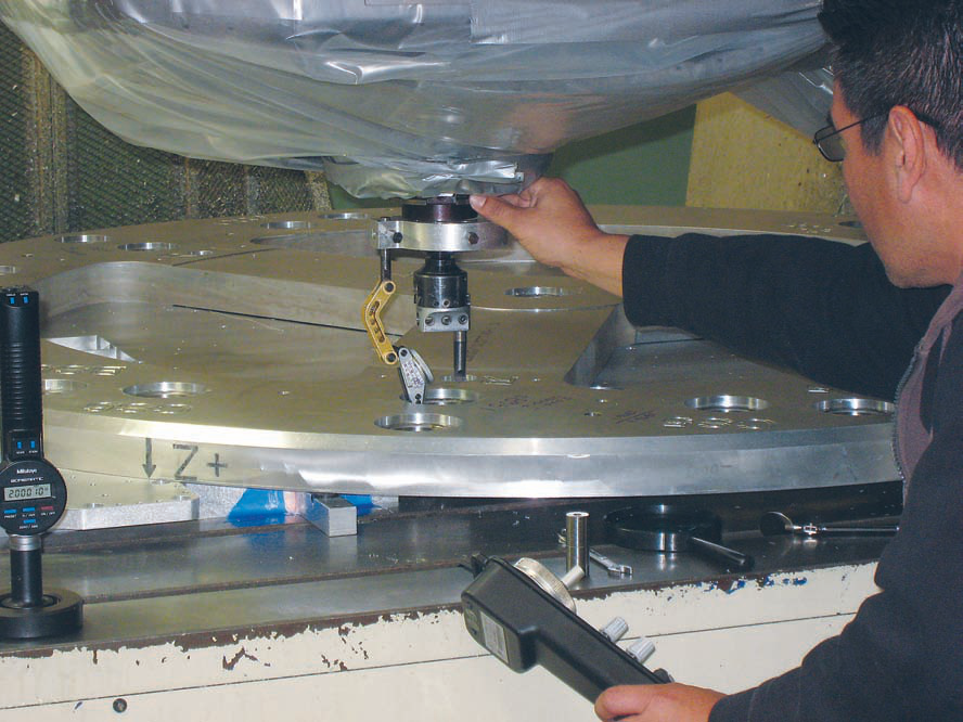

Votaw Precision Technologies is another large-part manufacturer that focuses on maintaining accuracy. The company targets tolerances of 0.0004 ” and tighter when producing parts even on its biggest machines, according to Richard Roy, maintenance manager. Those include a 5-axis Cincinnati and a 5-axis SNK, which has travels of 700 ” in the X-axis, 16 ‘ in Y and 6 ‘ in Z, as well as a rotary table for A- and B-axis movements. “This knucklehead will go to a horizontal position and rotate a full 360°,” he said.

Although Votaw focuses on obtaining new high-accuracy machines, it did purchase a used Viper 5-axis vertical machining center from a company that was going out of business based on the machine’s capabilities and cost savings. “It depends on the market when you buy used machines, but you can save at least 50 percent,” Roy said.
After purchasing the VMC, which has a 15 ‘ X-axis travel, 8 ‘ Y-axis, 3 ‘ Z-axis and tilting A and B axes, Votaw realized it needed to tighten its tolerances to meet its customers’ requirements. “We ran this used machine on many projects and saw that it wasn’t as accurate as we expected and just wasn’t holding tolerances,” Roy said. “We had to repeatedly do time-intensive adjustments.”
Votaw did some testing on the VMC—its main measurement feedback system consisted of rotary encoders on the ballscrews—and found one axis was experiencing a cyclic mechanical error the company believed originated in the ballscrew and rotary encoders. That error was then transferred to one of the axes. “That was unacceptable,” he said. “Even our adjustments didn’t meet expectations.”
One of Votaw’s vendors indicated there was nothing that could be done and advised the job shop against doing a linear scale upgrade because the vendor thought it wouldn’t be effective. “And they sold linear scales!” Roy said.
As a result, Votaw turned to A Tech Authority, Chino, Calif. Votaw requested replacing the measurement systems on the X, Y and Z axes with Heidenhain linear scales, so A Tech Authority mounted two Heidenhain LS 100 series linear scales of varying lengths and one LB 382 scale and ran the necessary cables.
After the linear scale upgrade was completed, laser calibrations showed success. “The cyclic error disappeared,” Roy said, noting that the VMC was able to accurately produce parts for the 787 Dreamliner airplane and the F-35 Lightning II aircraft. Overall, the accuracy improved to ±0.0002 ” from ±0.0005 ” on the three axes.
