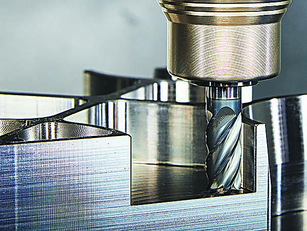

The V7 Plus offers good performance in a variety of materials.
The V7 Plus offers good performance in a variety of materials. Image courtesy of YG-1 Tool (USA)

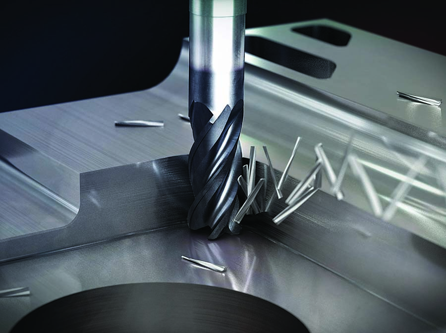

Top-Cut VAR multipurpose endmills feature flute and profile geometries optimized for long tool life and good performance in both roughing and finishing applications
Top-Cut VAR multipurpose endmills feature flute and profile geometries optimized for long tool life and good performance in both roughing and finishing applications. Image courtesy of Emuge-Franken USA

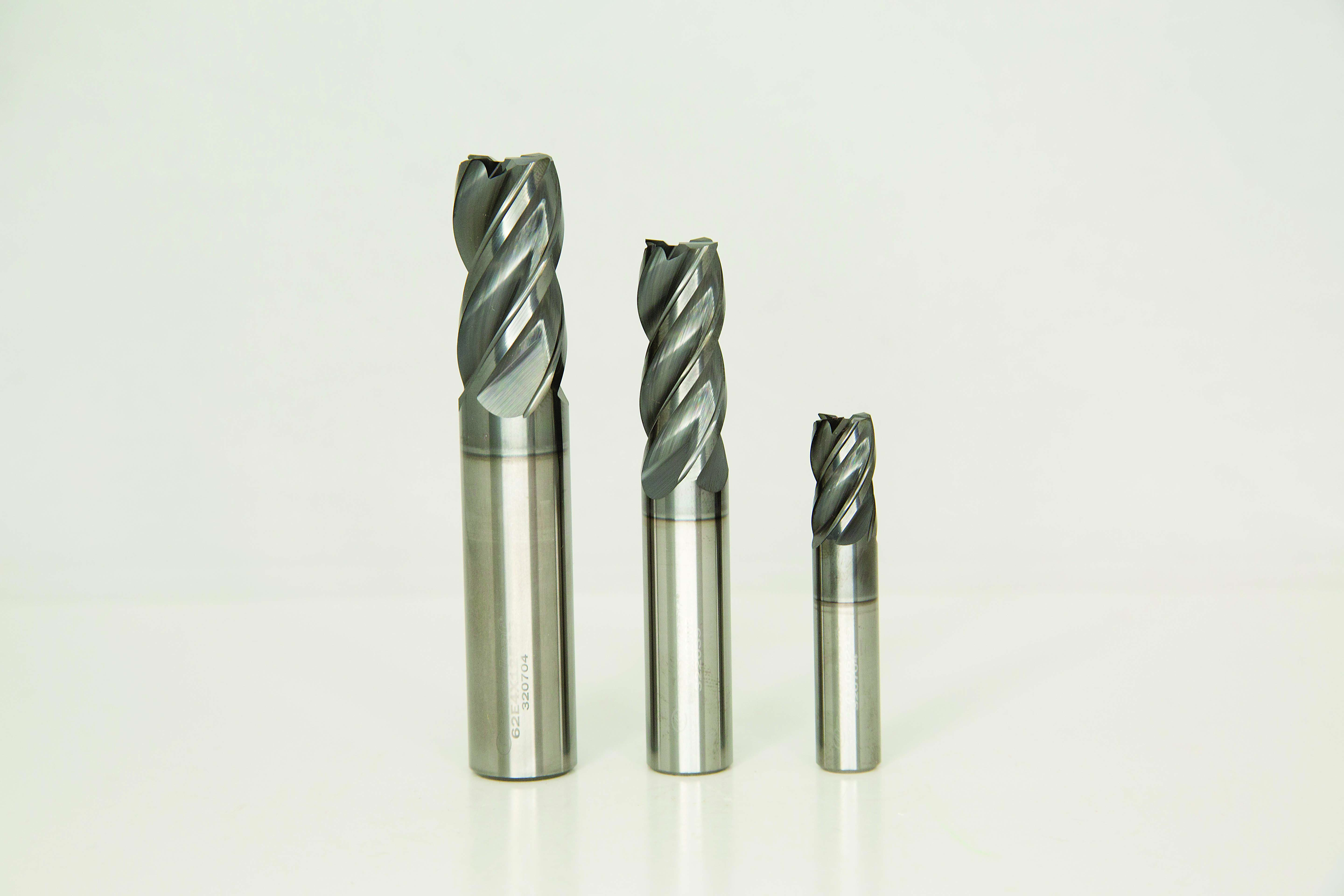

Greenleaf's 360 four-flute carbide endmills are designed for applications requiring heavy material removal rates.
Greenleaf’s 360 four-flute carbide endmills are designed for applications requiring heavy material removal rates. Image courtesy of Greenleaf
