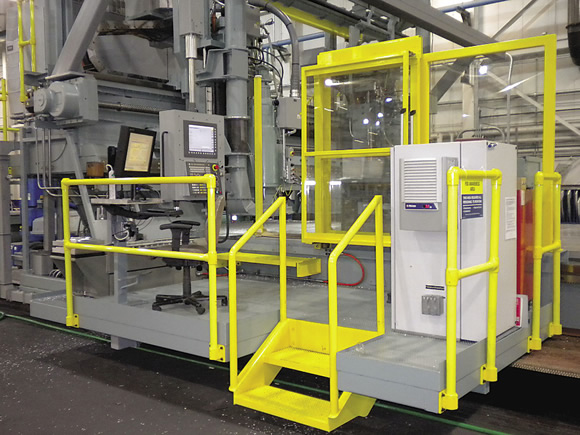

Before (above) and after (below) images showing a machine operator’s station. The machine tool is a Cincinnati Skin Mill retrofitted with a FANUC 30i Series control by CNC Engineering for a customer in Washington state.

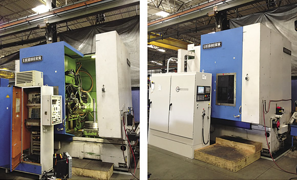

This Liebherr LC-752 gear hobbing machine received a new electrical cabinet (right) with new electrics, an air conditioner and a control that includes a panel, screen and push buttons. A new servomotor is visible on the exterior of the machine (red and black at bottom right). Within the machine, motors, cabling, absolute scales and other components were replaced.

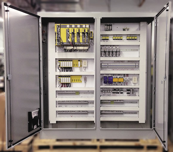

This electrical enclosure with a new control and cabling is ready to be shipped to the customer.

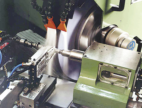

Example of an angle head cylindrical grinder that has been retrofitted with a modern apparatus. The Unimar in-process gage (foreground) automatically monitors the part diameter while grinding in order to control finished part size. The dynamic wheel balancer mounted on the grinding wheel spindle automatically compensates for an out-of-balance condition as dressing reduces the grinding wheel size.
