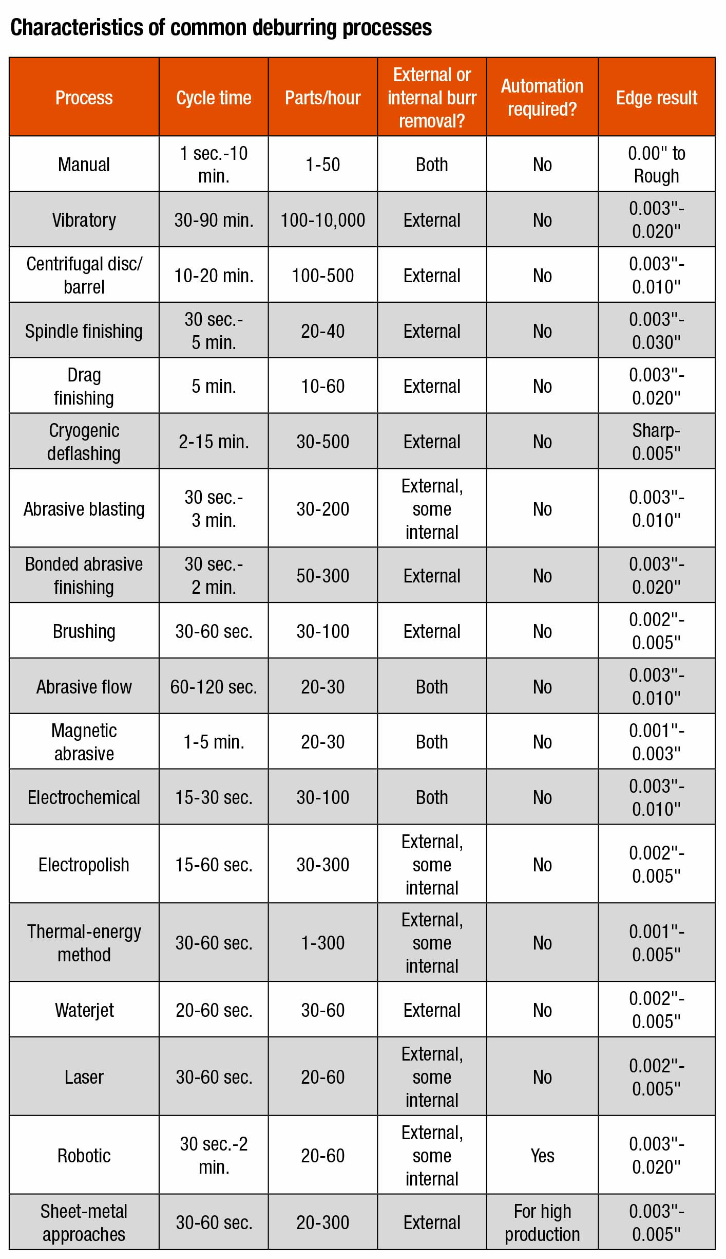

The table shown here summarizes key attributes that shops should consider when searching for the right deburring process. The table lists 18 processes, although a total of 124 processes exist. Most are variations of the processes shown. When it comes to especially challenging applications, such as deburring microscale parts and features, not all of these processes are effective, but guidance is available for those applications.
The cycle times shown generally do not include the time needed for cleaning parts after deburring or for performing other needed operations.
Deciding which process to use depends upon burr size, edge requirements, production rate and part volume, flexibility needed to deburr other parts the manufacturer produces, various part-quality requirements and economic considerations.
So, for example, the flexibility required for a job shop is entirely different from that needed for mass production of a single part, even though the processes used may be the same.
Shops should have several different deburring processes available to meet their needs, whether for a single part or a wide variety of parts. Most job shops use a mixture of manual deburring, vibratory finishing, abrasive blasting and abrasive-paper products. Highly automated shops employ robots that use the same abrasive or cutting tools as human

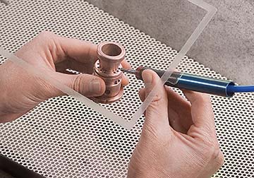

A micro-abrasive blaster is used to manually deburr a copper part with numerous internal cross-drilled bores that must be completely deburred to prevent modification of airflow dynamics. Image courtesy of Comco Inc.

Cycle time depends upon the amount of edge to be deburred, burr thickness, edge tolerances, and media or tools applied. The number of parts deburred per hour depends upon the number of stations the deburring machine connects to, as well as the handling time and the cycle time.

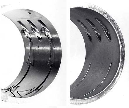

Burrs from drilling and milling before (left) and after (right) thermal-energy deburring. Image courtesy of Vectron Deburring.
Manual, brushing, magnetic abrasive, abrasive flow, waterjet, laser and robotic processes typically deburr one part at a time, whereas mass-finishing operations, such as a vibratory process, may process 100 or more parts simultaneously.
Finishing long, cylindrical parts, such as camshafts, is performed one part at a time by placing them on the end of a rotating spindle and immersing them in a tub of vibratory media. A manufacturer typically has several of these machines running simultaneously to meet production needs. Some machines have two or four spindles.
Cryogenic deflashing and some abrasive blasting can be performed in a tub, allowing the deburring of many parts at one time. However, both processes can also deburr just one part or one feature at a time.

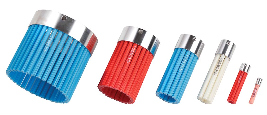

Xebec ceramic fiber surface brushes deburr and finish surfaces in CNC and manual machines. Image courtesy of Deburring Technologies Inc.
The thermal-energy method exposes a small basket of parts to temperatures from 4,500° to 6,300° F (2,482° to 3,482° C) for about 2 to 3 milliseconds. The parts are surrounded by a gas that fills all of their open areas and envelops the exposed burrs. The gas is then ignited and the burrs are vaporized in a fraction of a second.
