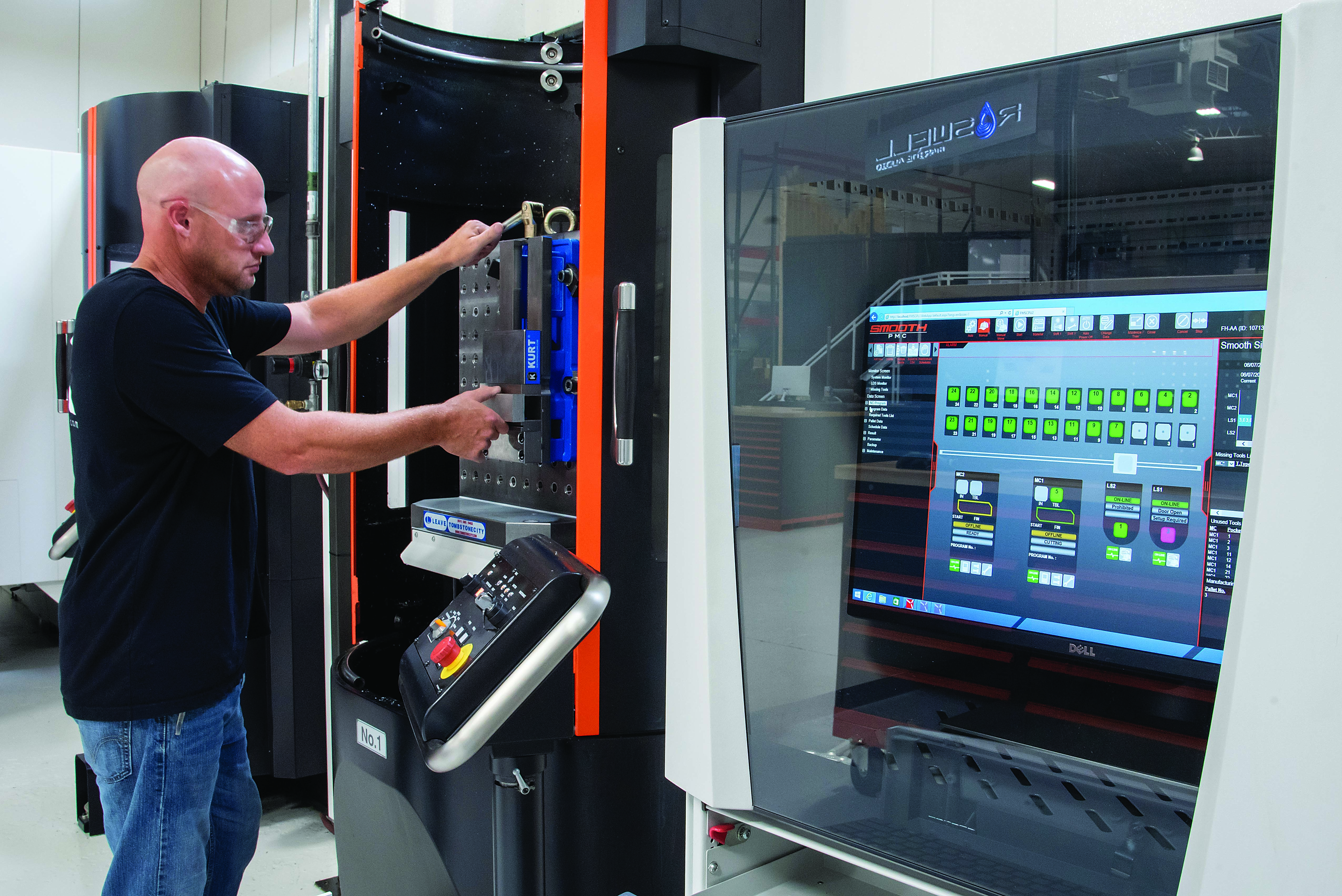

The HCN-5000 is available with Mazak’s Multi-Pallet Pool system, a compact multiple-pallet stocker system for manufacturers that have limited floor space or require basic automation to increase productivity. Image courtesy of Mazak

When the Florida facility needed additional equipment to increase its machining capabilities, the company compared offerings and selected machine tools from Mazak Corp., Florence, Kentucky. Roswell Marine’s most recent Mazaks include an HCN-8800 horizontal machining center and two HCN-5000 HMCs. The HCN-8800 has a built-in two-pallet changer. The HCN-5000s have 120-tool changers and are part of Mazak’s two-tiered 24-pallet Palletech automation system.
The modular palletized manufacturing system further boosts productivity of many of the company’s horizontal, five-axis and multitask machines. System configurations include one-, two- or three-pallet stockers; tilting load stations; centering load stations; part wash stations; and material storage. Overall, a system can accommodate up to 16 Mazak machines, six to 240 pallets and as many as eight loading stations for unattended operation.

“The quick interchangeability and flexibility of the Mazaks, especially the Palletech system, is key to obtaining the manufacturing agility,” Runske said. “We can be running one part, then two hours later, for instance, we can run a completely different one, then an hour after that another different one.”
He said the palletized system allows the shop to prioritize and schedule prototype parts for the middle of production cycles by allocating some pallets to prototype work in the same cell.
