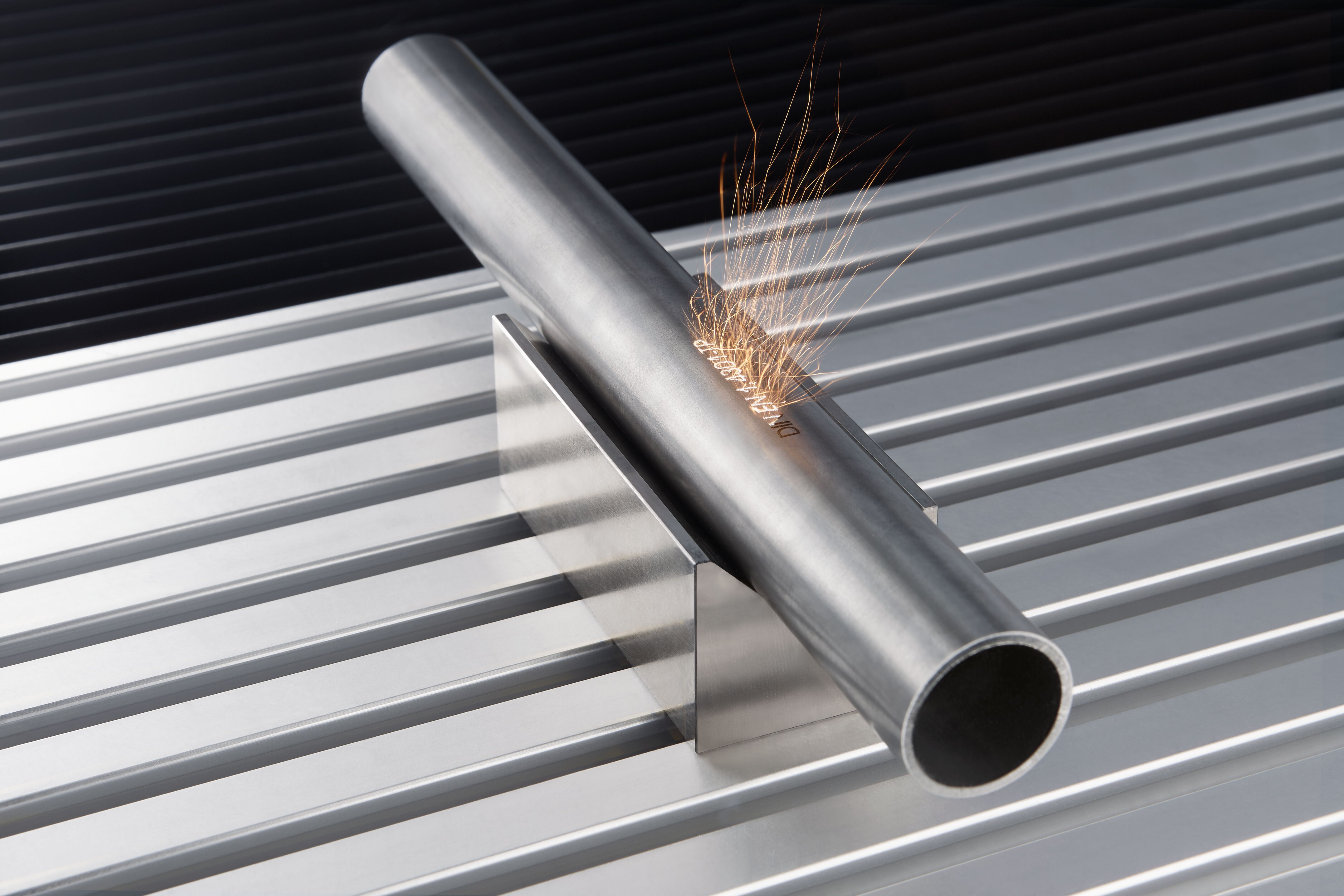

Lasers leave indelible marks on parts. Image courtesy of Trumpf
“With the laser, you are changing the material and getting a more scratch-resistant mark compared to an inkjet, where the mark is only on the surface and not in the surface,” said Albert Jung, marking technology specialist at Trumpf Inc. in Farmington, Connecticut. “You can scratch off an ink, but a (laser) mark needs to be grinded off a steel part.”

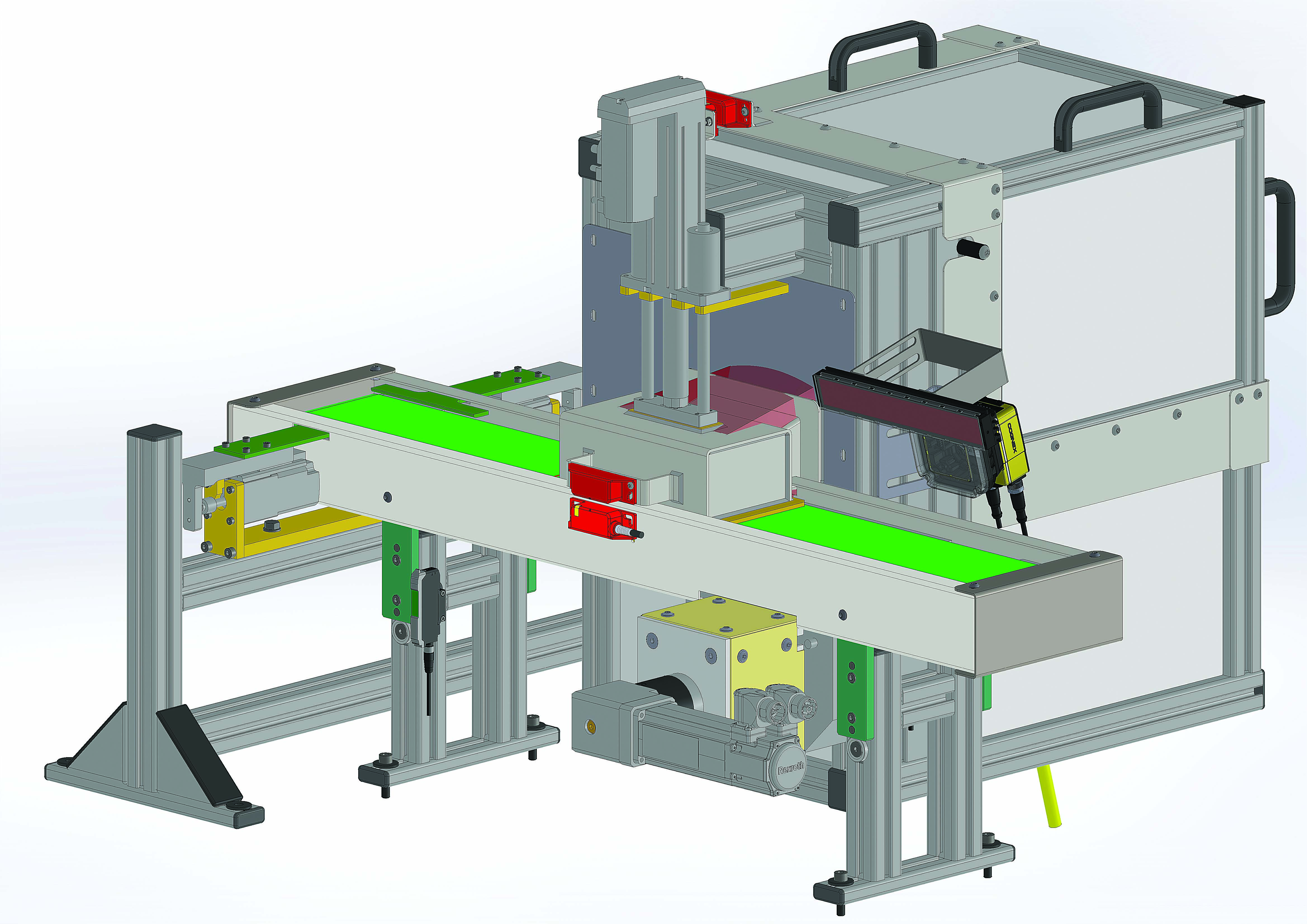

This custom on-the-fly laser marking system was designed to meet the requirements of a particular production process. Image courtesy of Pryor Technology
Jones said a 20 W system is “very standard” for industrial marking applications, though he believes that Pryor Technology has provided laser power as high as 300 W to customers.
The downside to boosting laser power, of course, is that it also makes the laser’s price tag even heftier.
“Cost goes significantly higher as you up the wattage to meet your target cycle time,” Jones said.

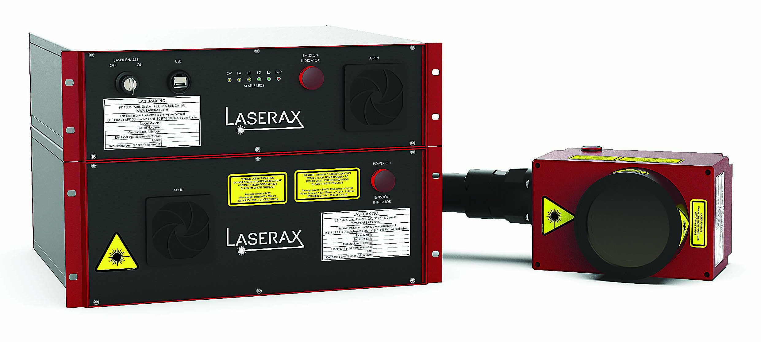

LXQ fiber laser marking systems are designed for fast integration into production lines. Image courtesy of Laserax
Regarding the effect of laser marking on part quality, “it’s fine for most industrial applications because it only creates a surface roughness of about 30 µm (0.001″),” Landry said. “If you put your finger on the marking, you will feel that it is kind of rough. But it is not dug in the material and doesn’t really change anything in the structure.”
