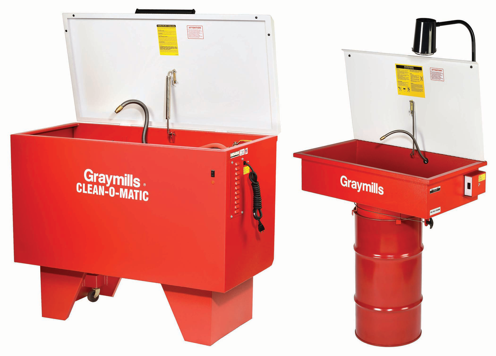

Finding the right parts cleaning machine or system is “shockingly complicated,” said Tom Kucklick, applications specialist at Graymills.
A batch machine is widely used to simultaneously clean a large number of small parts, which are placed in trays or baskets and go into one or more tanks depending on the number of stages. With a single-chamber machine, parts go inside the chamber, and the entire process takes place inside.
One of the most common forms of parts cleaning is ultrasonic cleaning. It can be used with just water, but adding a cleaning agent appropriate for the part to be cleaned and the type of soiling present enhances cleanliness.
The simplest form of water-based ultrasonic cleaning consists of a standard-size heated tank, such as one measuring 304.8 mm × 304.8 mm (12″×12″). Parts go into a basket, which a user lowers into a tank that contains chemistry. The amount of time needed to clean them is calculated through trial and error. Parts then are rinsed. Some operations use a second tank for rinsing. Others just rinse parts in a sink and blow off excess water by hand with a compressed air hose.

The DMD232 (left) is a small, manual drum-mount washer. The 500 (right) is a small, manual tank washer.
Both have a pump for low-pressure spray washing. Image courtesy of Graymills

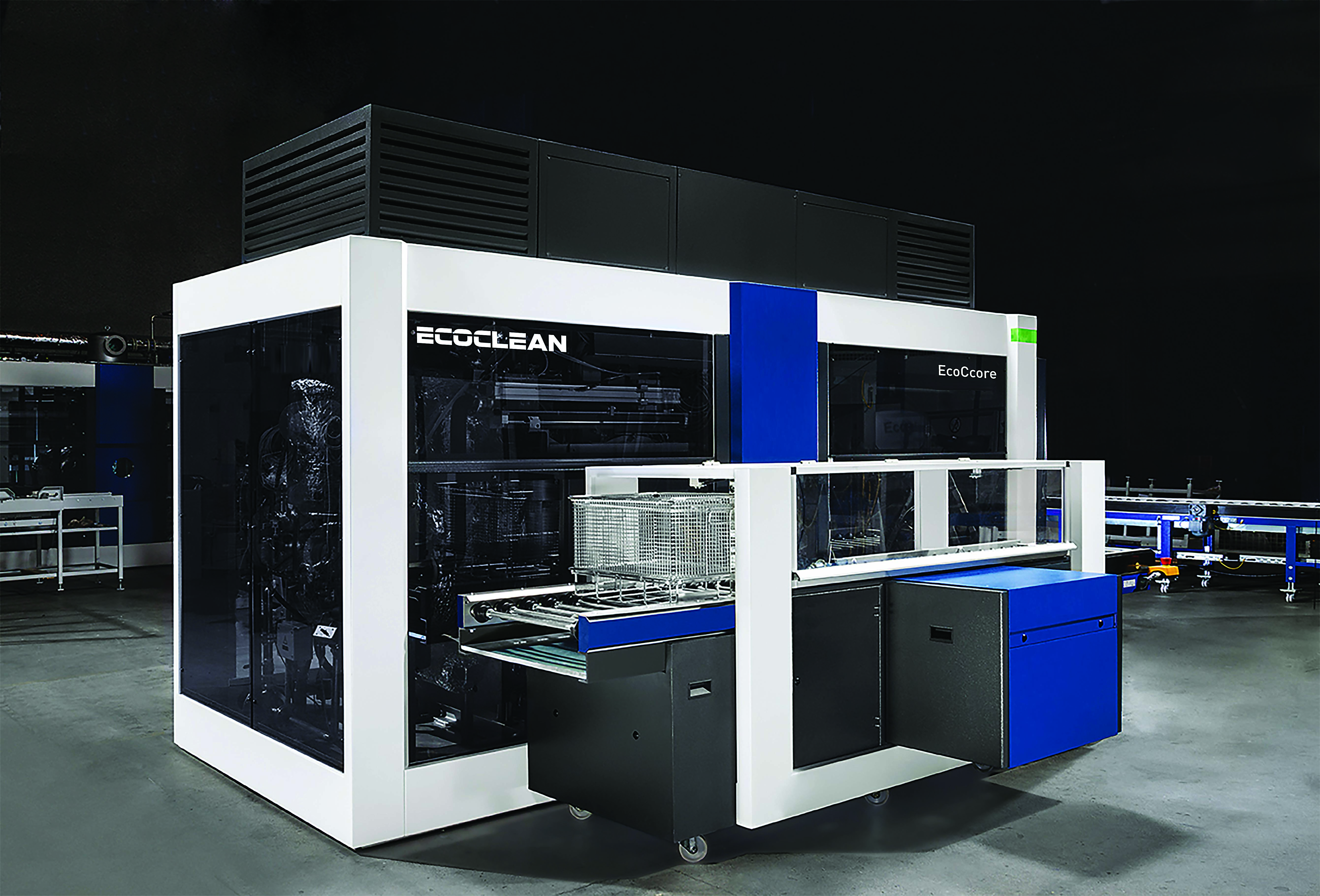

The EcoCcore is one of Ecoclean’s best-selling industrial parts washers. The unit shown is a batch cleaning machine. Image courtesy of Ecoclean
“While the solvent-based machines carry a higher upfront investment point, it has considerably less running costs,” Siminovich said. “So your payback on the equipment will be faster — on average it’s about two years — than that of a water-based machine.”
