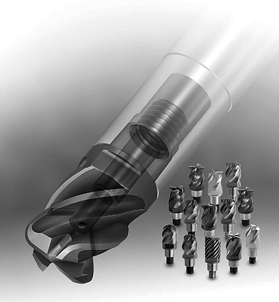

Mitsubishi Materials recommends its iMX exchangeable-head endmills when machining HRSAs, such as Inconel 718. Both the head and holder are made of cemented carbide.

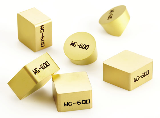

Greenleaf says its WG-600 coated whisker-reinforced ceramics enable faster cutting and better resist wear and heat than carbide tools when machining HRSAs.

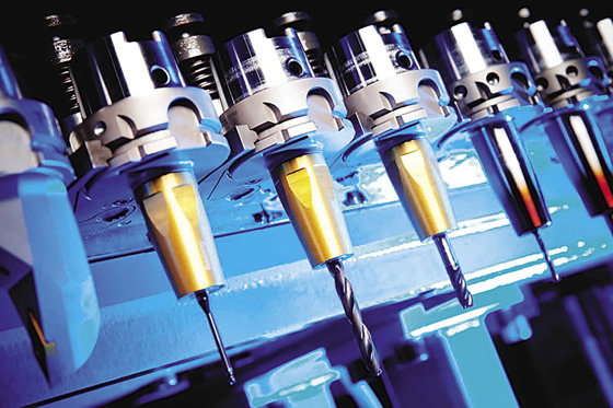

Part manufacturers frequently employ shrink-fit toolholders when machining HRSAs because they provide high clamping force, high accuracy for the centerline position of a tool and minimize total indicator runout.

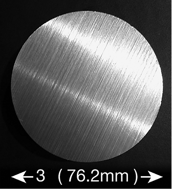

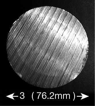

Above: When sawing 3 “-dia. Inconel bar stock with flood coolant, the cut generated excessive chatter and a burr on the edge of the stock. Below: When the same Inconel stock was cut with the same saw blade on the same machine, but using Unist’s minimum-quantity lubrication system and Coolube 210EP lubricant, the cut quality significantly improved.

In addition, vastly minimizing coolant application can enhance cut quality. For one customer sawing 3 “-dia. Inconel bar stock with a Lenox bimetal blade on a Hydmech machine, Unist Inc., Grand Rapids, Mich., reported that excessive chatter and a large burr on the edge of the stock resulted when using flood coolant (see photos above). In addition, the blade only lasted 5 days. However, when the customer installed a Unist MQL system and applied Coolube 2210EP lubricant, cut quality and blade life significantly improved.
