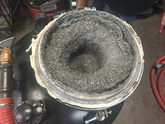

This filter basket offers a good indication of the oily gunk hiding in most machine sumps,
which creates a prime breeding ground for microorganisms. Image courtesy of CECOR.
Dermatitis and dry skin are common with neglected cutting fluid. So, too, is the “morning stink” caused by microorganisms munching overnight on their favorite food: tramp oil. And from a productivity perspective, the worst—but often least obvious—problem is the gradual degradation of cutting tool performance and part quality that comes with dirty or tired cutting fluids.

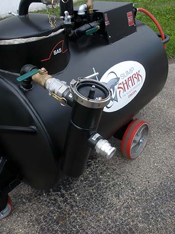

CECOR’s Sump Shark has a discharge filter for cleaning fluids
before disposal or recycling. Image courtesy of CECOR.

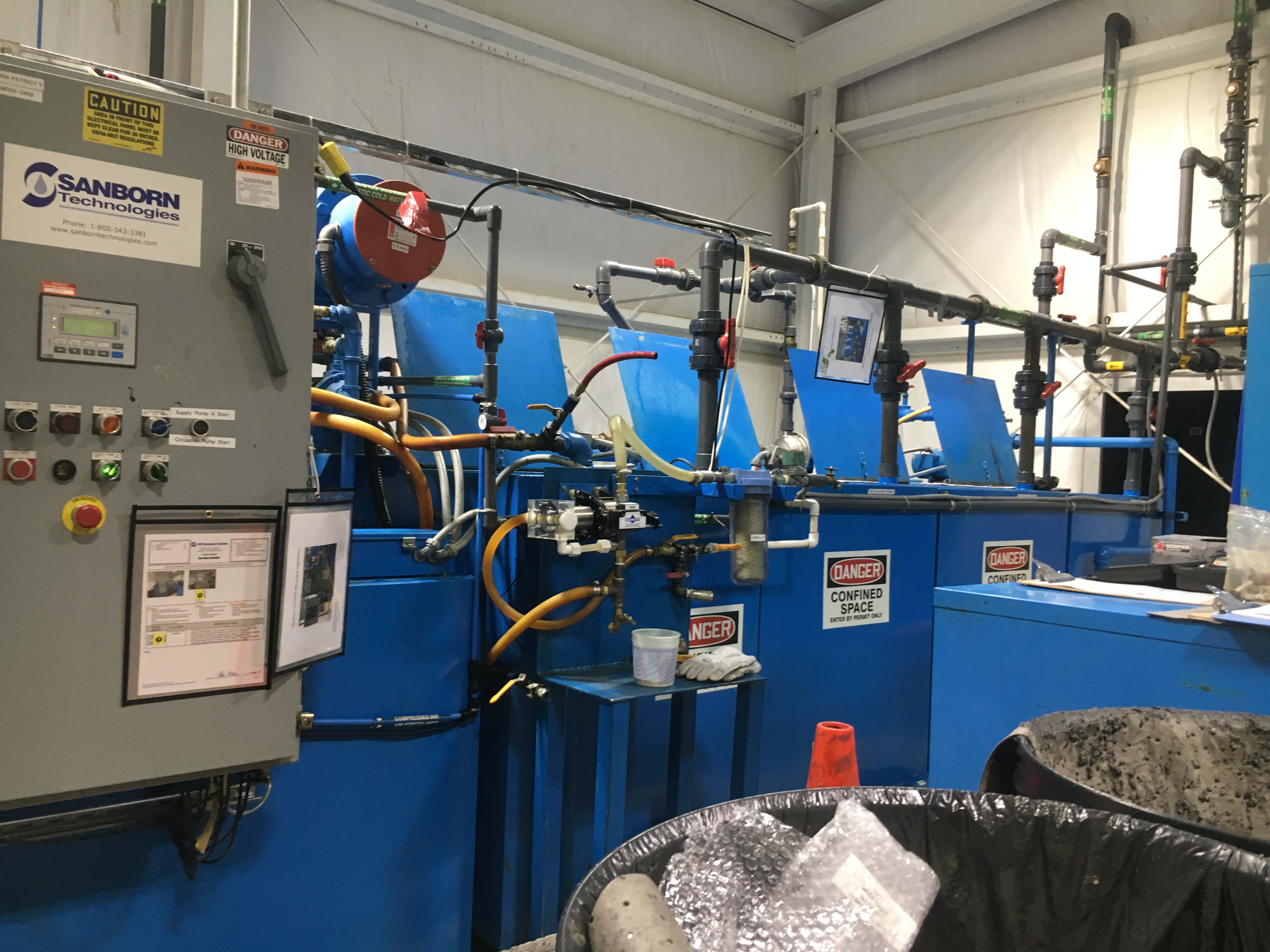

Some shops plumb the production area with vacuum lines to clean machine sumps and pressurized clean-fluid lines
for refilling them. Image courtesy of Sanborn Technologies.

CECOR, Verona, Wis., also offers portable filtration devices. Owner Jeff Urso estimated that many shops don’t clean their machine sumps at all.
“I visited a shop once that bought a $2 million machining center 2 years earlier and had never changed the cutting fluid,” he said. “People often don’t see the importance of it or recognize the toll improperly maintained fluid takes on tool life and the operator.”

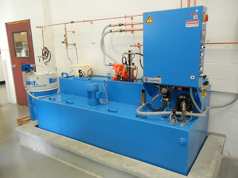

Central recycling systems are increasingly popular as machine shops recognize the importance
of clean cutting fluids. Image courtesy of Sanborn Technologies.

This becomes increasingly evident when one considers the cost of sump cleaning equipment. CECOR, for example, sell units for under $10,000. Its Sump Shark can be wheeled to a machine to completely empty a dirty sump at rates from 60 to 110 gpm. Dual-tank models can immediately refill the just-emptied machine with clean coolant, making the entire operation a 10-minute-or-faster affair. “Our unit makes sump cleaning easy, fast and safe,” Urso said.

Thomas Tripepi, technical director at PRAB Inc., Kalamazoo, Mich., agreed that sump cleaners have their place, but said a dedicated recycling system is often best for cleaning cutting fluid once it’s removed from the sump, especially for shops with 20 or more machines.
“Most of our systems use some type of paper or bag filter, followed by a coalescing separator,” he said. “We then run the cutting fluid through the system several times, repeatedly overflowing the clean side back into the dirty in order to get it as clean as possible.”
Dirty fluid is typically transported to and from the recycling system using the sump cleaner itself, most of which can suck dirty fluid out or pump clean fluid back in. Tripepi said some shops will run an overhead line to each machine, so all the operator has to do is grab a hose reel, open the nozzle and fill the machine with coolant after cleaning.
Tripepi said payback on a central recycling system is often measured in a few months to a year or two. This is largely because of the high price of cutting fluids, which often costs from $15 to $50, or more, per gallon, as well as the reduced downtime and labor savings gained by cleaning sumps in minutes rather than hours.
“The value with one of these systems is that you’re not paying to haul coolant away, you avoid the liability that comes with its disposal, and you’re not buying nearly as much new coolant,” he said. “But more importantly, and this is the part most people have a hard time recognizing, you also save money on cutting tools.

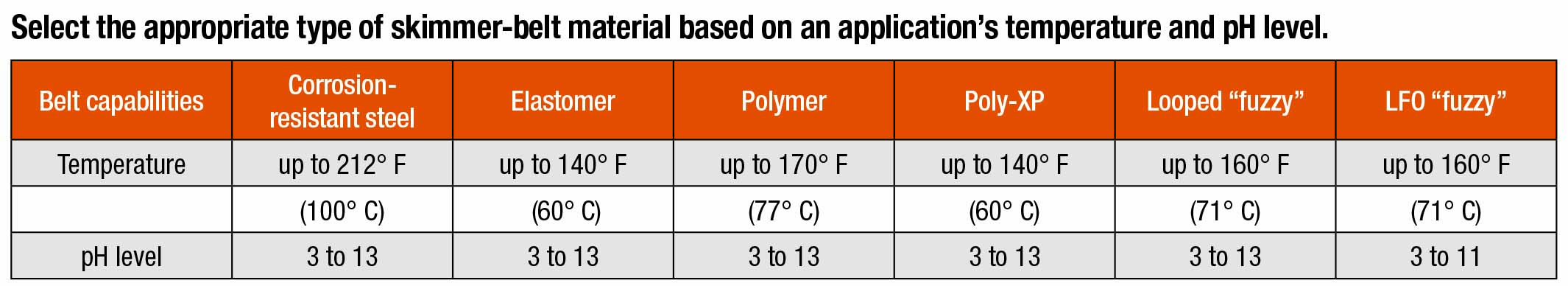

A great deal of variance exists in applications where belt skimmers are present. Choosing the best belt material depends on several factors. For the most part, different belt types function in the same fashion by breaking the surface tension of a fluid to draw oil to the skimmer, so the main goal is finding which belt material will provide the longest operating life. The two factors that most impact belt wear life are a fluid’s temperature and pH level.

Some skimmer applications involve high fluid temperatures—from 180° to 190° F (82° to 88° C). A high level of heat is problematic two ways. First, heat can make the acidic or alkaline chemicals in a fluid more aggressive by increasing the rate of chemical reaction. Second, heat may shorten the life of a polymer belt, essentially “cooking” the plastic.
When discussing plastic belts, it should be mentioned that a pH level that’s too high or too low can cause failure at the belt seam, where the belt was heat-welded together. The same conditions cause steel belts to become brittle.
Other variables also impact belt performance. Coolant containing swarf, sand and other debris can abrade a belt. On a steel belt, the abrasion is typically seen at the belt edges, where small cracks can be found. Polymer belts, on the other hand, are more tolerant of grit, because they are more flexible than steel.
In addition, most coolants contain rust inhibitors, which may reduce a belt’s oil-collection efficiency. Therefore, polymer and elastomer belts are often recommended over steel belts for coolant-skimming applications.
If a belt material is not suitable for an application, oil will not adhere to the belt or the adherence will be suboptimal, which slows the rate of oil removal and may leave more trace oils unskimmed. In addition, an incorrect belt choice can lead to premature wear.
To help choose the correct belt for an application, request free samples of available belt materials from a manufacturer for testing an oil’s ability to stick to them.
