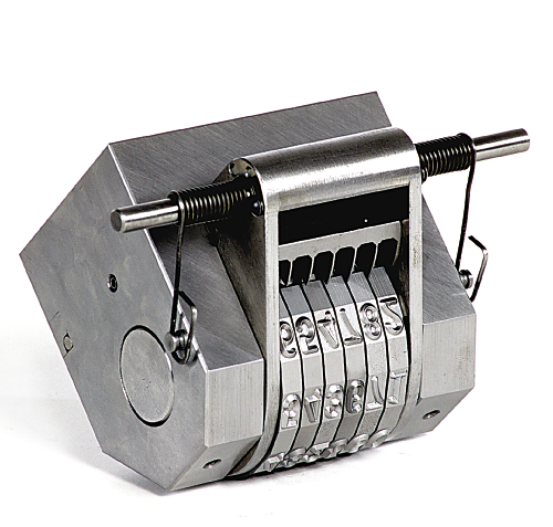

Automatic numbering heads, such as the Model 50P from Numberall, provide rapid, accurate and consecutive parts numbering.
Automatic numbering heads, such as the Model 50P from Numberall, provide rapid, accurate and consecutive parts numbering. Image courtesy Numberall Stamp & Tool Co. Inc.

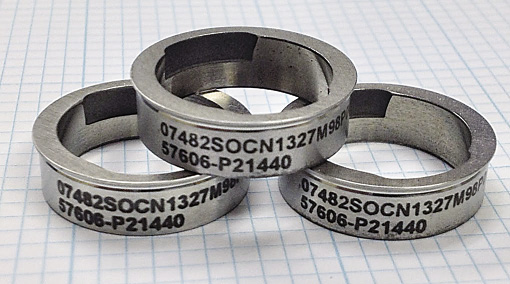

Laser etching is probably the most-desirable method available. It is extremely flexible, accurate and easy to do. The process allows intricate details that would be difficult with other methods. Laser-etching machines can have their power output and speed altered, making them capable of intricate photo-like details.
There is actually a growing industry driven by the demand for laser-etched consumer goods. An online search reveals numerous companies that etch a variety of products. These machines are surprisingly inexpensive, with some small models starting at just over $300. They are also easy to use. You simply connect the computer, select an image and tell the machine to begin.
