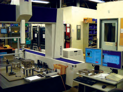

A Zeiss Accura CMM on the shop floor at Areva NP pushes inspection back to machine operators and gives them nearly real-time feedback on their processes.

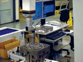

At Areva NP, dual screens enable operators to view photos and instructions for fixturing parts in the CMM and then get data output from the other.

“We typically machine the components in four to five operations, with CMM checks in process—sometimes after every machining step and sometimes after two or three steps,” High said. “The cell basically runs unmanned, so we need to make sure the process is robust and doing what it’s supposed to.”
The CMM is about 20 ‘ from the cell. “It’s a bit of a harsh environment, but we have a temperature-controlled shop and we regularly clean some of the CMM surfaces to keep it operating well,” High explained.
Parts are machined to tight specifications—flatness of 0.002″, diameter tolerance of 0.0005″ and positional requirements within 0.002″ to 0.003″, according to High. “A typical order quantity of end fittings for a pressurized- water reactor might be 60 each of upper and lower fittings and, for a boiling-water reactor, 200 of each, so quantities are not huge,” he said. “It used to take us a couple of months to fill an order like that. Now we have the HMC cell and a 36-pallet linear system, and we can flow parts though the system at rates up to 12 to 15 parts per day, depending on the design. We run a big product mix, and we’re trying to get to an economic lot size of one part.”
Before purchasing the CMM more than 2 years ago, the shop used complex dedicated fixtures—High calls them “super gages”—to inspect parts. “We could drop a part into a fixture and read the dimensions off a whole bunch of dial indicators,” he said. “Those gages told us whether parts were good or bad, but we never knew how good or how bad.”
The CMM enables documentation of all checked part features, and uses software that provides Cpk and statistical process control data. Operators perform almost all inspection themselves, High said.
“Our machinists put the parts on the machine and run the inspection program,” he said. “The same guys who write the machining programs also write inspection programs for the CMM, which has dual screens so operators can see how the part is fixtured and get instructions from one screen and then get data output from the other.” Final inspection routines for the end fittings might check hundreds of part features and run for up to 40 minutes, he added (see photo on page 61).

The system enables Areva quality personnel to focus more on process improvement and less on verifying the quality of individual parts. “Our quality people don’t come out and inspect parts,” High said. “They’ll receive the completed parts in the inspection room, do a visual inspection and check a few critical features, then go online and look at the data that’s already been collected. If everything looks good, they’ll accept the part.”
The Accura CMM is a semihardened machine with a scanning contact probe that enables mapping of high and low spots on critical part surfaces. “The CMM has performed well in the shop environment. Before we purchased it, we ran temperature profiles in the shop and got a little variation, plus there’s some misting because we run high-pressure coolant,” High said.
“But we do regular preventive maintenance on the machine and wipe off air bearing surfaces and the granite slab daily. We try to keep it clean, and we have Zeiss come in on a regular basis to keep it tuned up.”
According to High, Areva considered CMMs from several manufacturers before choosing the Zeiss machine. “We’re an international company, and our companies in France and Germany have Zeiss machines,” he said. “Some of our casting suppliers also have Zeiss CMMs, so we could use their routines for incoming inspection if we wanted to.
