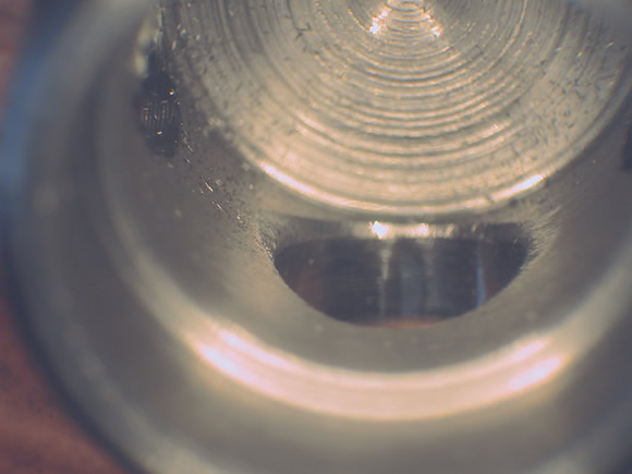

Another application where a hard tool has an advantage over a brush is in removing the burr from the edge of a through-hole. “Because of the action with which a brush works, the bristles have to strike against the edge to which the burr is attached,” Hopkins said. “When inserted into a through-hole, the direction of spindle rotation is actually wiping the bristles along the edge, which doesn’t produce an effective deburring action.

Heule’s COFA deburring tool deburrs the contours of an elliptical hole when two holes intersect or when a hole is not perpendicular to the surface.

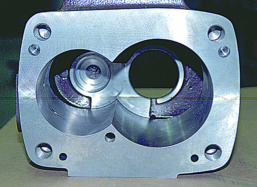

“Brushes are best for cross-hole applications, where you have intersecting bores, because they can come in at a right angle,” Hopkins continued. “That is what gives you the proper action for the bristles to remove the burr.”
The Flex-Hone does not have this through-hole limitation because it is larger than the hole and “pops out” on the back side of the hole.
However, if the holes are very small, the user may still need to apply a miniature brush for through-holes. And that is another advantage of brushes. Some hard tools can deburr holes down to 1mm, but, for most, the smallest is about a 2mm hole. “If we go any smaller than 1mm, it gets very intricate and very expensive,” said E-Z Burr’s Robinson.
