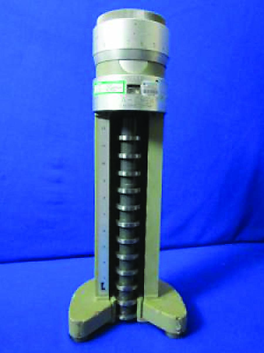

Measuring machined parts on a surface plate has long been a tedious job, one that requires mastery of dial indicators, a pocket calculator and an adjustable height gage that most in the industry refer to as a “Cadillac gage.”

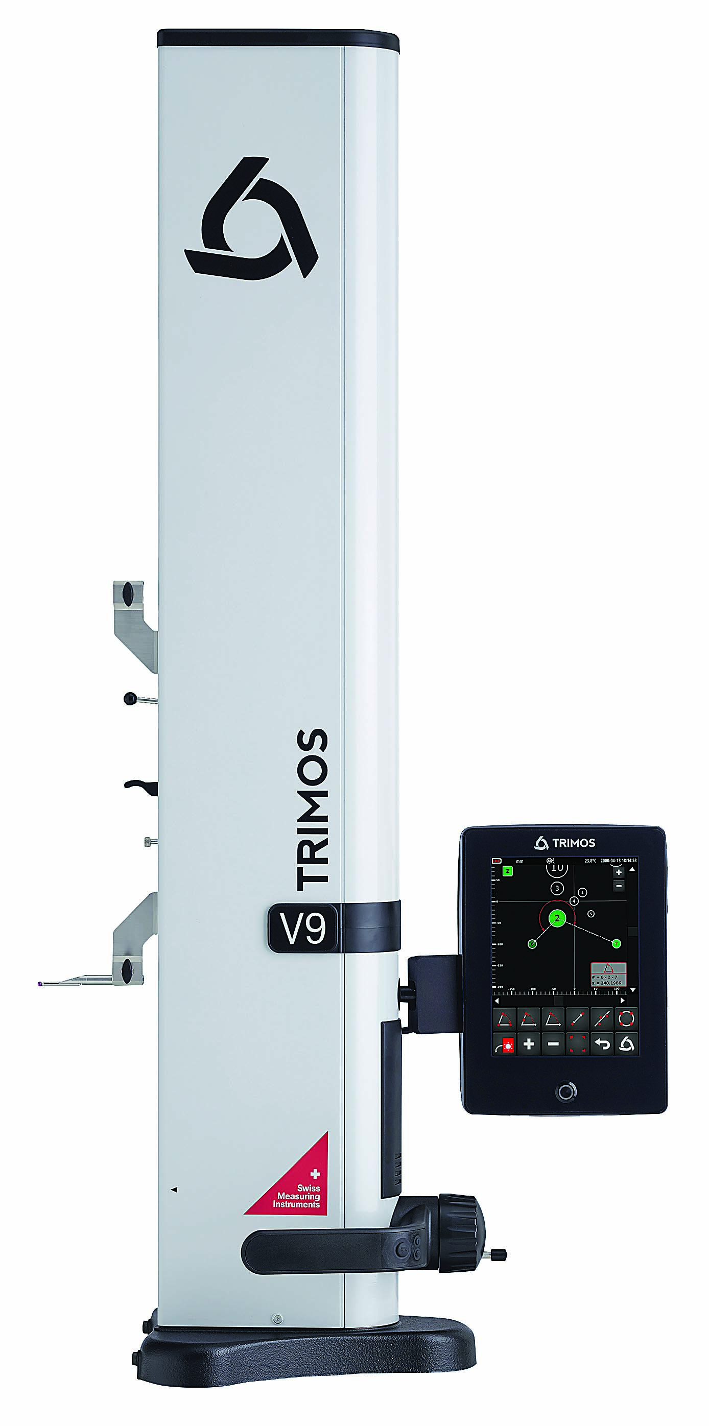

“If you’re still measuring the old-fashioned way, an electronic height gage will change your world,” said Anthony Dilorio, regional manager at Fowler High Precision Inc., Newton, Mass. “As an example, checking even a simple diameter with an indicator and Cadillac gage requires you to sweep the bore for the low spot, find that value on the Cadillac, jot it down, repeat the process for the top of the hole, then subtract the first value from the second. With an electronic gage, you sweep the top, sweep the bottom and you’re done. It’s a night-and-day difference.”

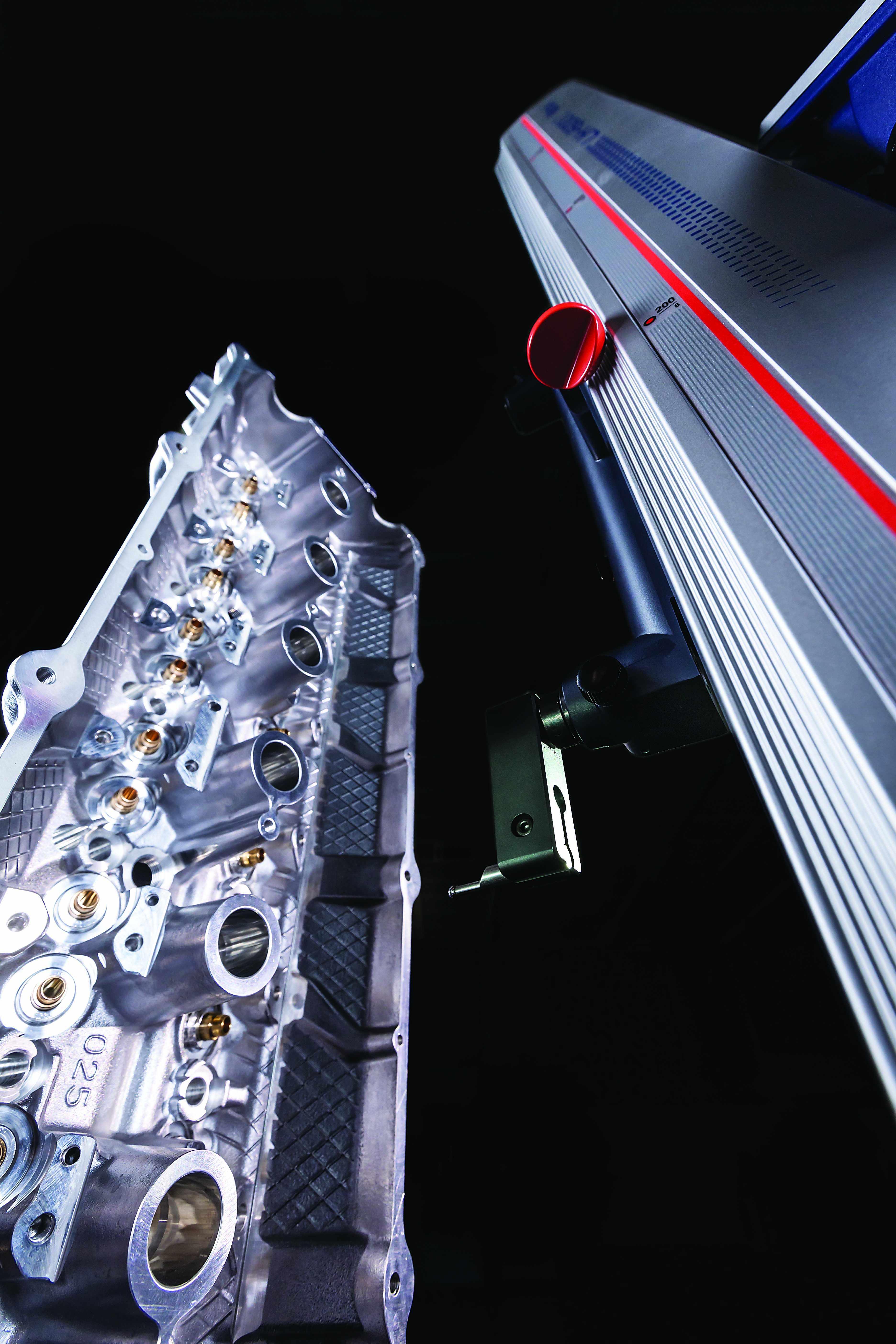

“Depending on the model and features, you can think of an electronic height gage as a single or 2-axis CMM,” said Mike Grosenbach, product specialist for distributed products at Mitutoyo America Corp., Aurora, Ill. “The accuracy of some machines is down in the 0.000045″ range, comparable to a CMM. They’re also much easier to use; operators with minimal training can walk up and check most part features on their own.”
Both manufacturers offer a variety of easily calibrated probe and stylus options, support for USB and RS-232 communication, integration to external statistical process control and metrology software, air-assist and advanced-measurement functions, such as perpendicularity, min./max./delta and angle measurement.
